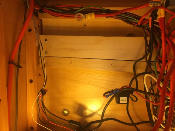

Here's what it looked like before the CTEK was installed. Above the battery to the right is the battery isolator. That can be eliminated by using the CTEK. The small device to the left is the shunt for the trimetric.

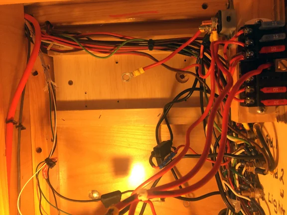

I removed these devices and this is what it looked like. The shunt will have to be remounted.
I had to add a strip of wood to give me a place to mount the CTEK.

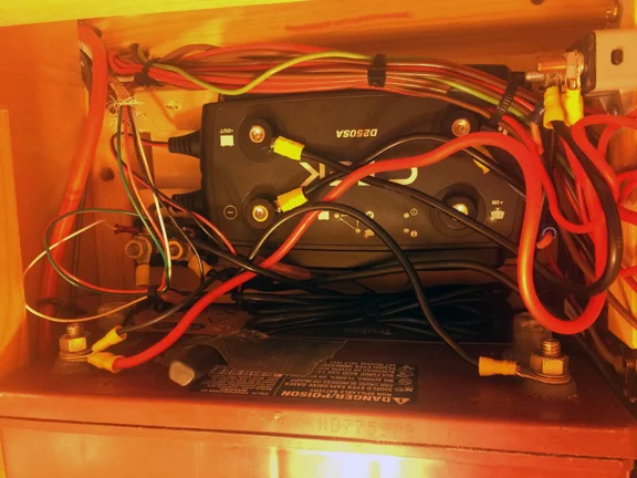

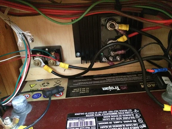

The CTEK was easy to install at this point but I had to install it "upside down" because the power wire from the seven way plug wasn't long enough and I didn't want to splice it (hope no electrons spill out). I also had to use a small round file to open up the ring terminals because the CTEK mounting studs are bigger than those on the now-removed battery isolator. I made a new wire to run from the CTEK output stud to the 50 amp breaker because the existing wire just wasn't quite long enough.
Here's what it looks like installed. It's pretty tight with the trimetric shunt but it all fits fine. You can see the CTEK temperature probe taped to the top of the battery near the positive post. That's how they say to do it.
I've only tested it briefly because my January southern Arizona camping trip got canceled by a DC hissy fit. The trimetric voltage came right up and the amps started high (around 10) but quickly settled back to 3-4 and came down steadily from there. The battery wasn't very discharged so I didn't expect the amps to be very high.
The only other details I can think of is that there's a wire from the CTEK you have to ground if you have an AGM battery. That was easy enough. There's also another wire to tell the unit that you have a "smart alternator" (we don't) and I'm not sure how that gets hooked up. We may be getting a new TV this spring so I guess I'll find out.

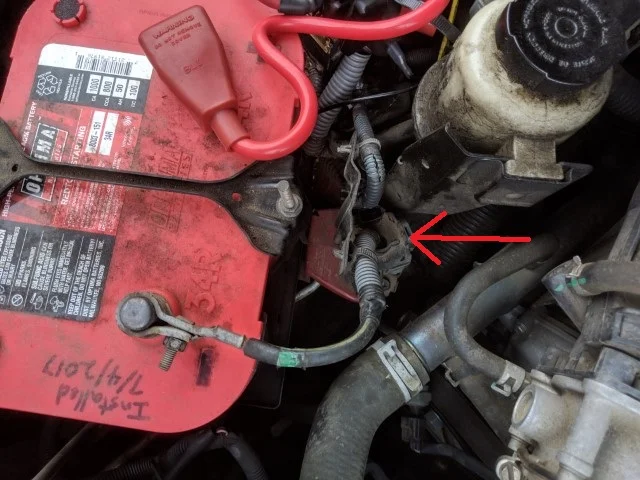

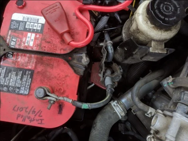

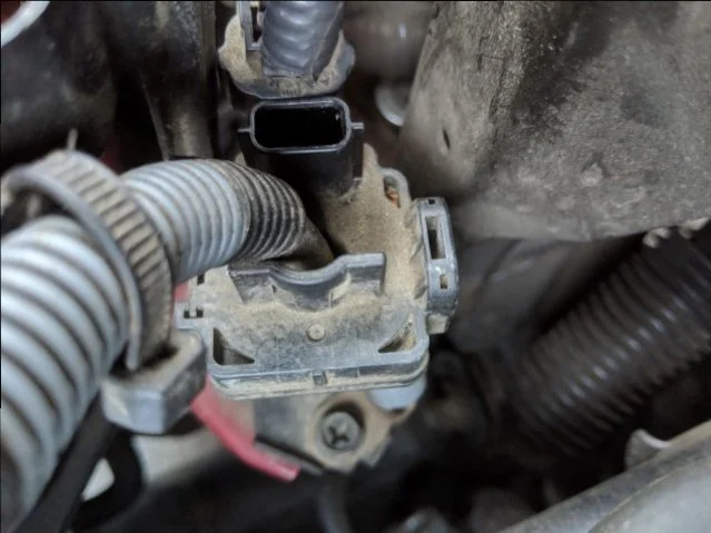

Robert - sorry to hijack your thread, but I think this is relevant. Seth, you asked so here goes - Indeed your Frontier is closely related to the Xterra, though mine is a 2010. When my original battery died, I replaced it with an Optima AGM which in my experience has been a great choice in other vehicles. However, it didn't perform well in the Xterra, and after killing one I looked into what was going on. I found that after starting the engine, the charging voltage would start out at a healthy 14.5 volts or so, then drop down to about 13, not enough to make an AGM happy. Research discovered the "smart alternator".
Here is what I did to "dumb it down". Looking at the battery negative terminal, there is the expected cable going to the chassis. However, there is a magic box that the cable goes through. This is a current sensor that the car ECU uses to detect how the charging is going.
I disconnected the cable that goes to the ECU.
That's it. The charging voltage now stays at about 14.5 when the engine is running. I fully expected the ECU to throw a check engine code with this disconnected, but it has not in several months of running. The AGM is now happy, as well as the batteries in the trailer and my fridge auxiliary battery setup.
Nissan implements this feature as software (firmware?) in the ECU that monitors the current in the battery ground cable and combined with other stuff determines the charging state of the starting battery. If it feels the battery can stand a lower voltage, it sends a signal to the alternator to reduce the output voltage. The idea is that with a lower output voltage, the alternator will not work as hard, making a small but apparently noticeable improvement in fuel economy. This feature is based on the requirements of the factory standard lead acid battery and is not appropriate for AGM batteries. Disconnecting the current sensor fools the ECU into keeping the charging voltage at normal levels. I have no idea if this is the way other manufacturers have implemented the smart alternator, but it works for me.

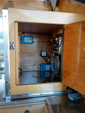

I really wish I could see how your ground wires fit into your area. Ours are immediately above the battery. When I looked for a way to mount the CTEK inside the battery box area instead of in the storage compartment, there was absolutely no room for it.
I mounted a Ctek in the same location that the Morningstar solar controller was. It is kinda nice being able to check the indicator lights on it to see what is going on. My TV is a GMC Canyon and if I put it in Tow mode, then it is supposed to keep the alternator at hight output. The manual also says that turning on the headlights will also keep the alternator at high output - might be worth checking out on your TV.
the grounding posts in our 550 are aft of the battery, pretty much right in front of the tail light. Sorry for the repeat of this photo, but if you look in the lower right you can see the ground posts and their labels written on the wood. The battery sits just to the left of these ground posts.
I discussed this location with Cary but decided to give the above-the-battery spot a try, mainly because I didn't want to splice more wire to the power wire coming from the seven way. While this is a good spot, I discovered while wiring the trimetric that it's not all that easy to get to, and there are a couple of fat wires that need to be run to the CTEK. Also, I've the trimetric which tells me whats going on electrically all the time so I don't think I need to be able to look at. I don't think I've ever checked the morningstar while using the solar panel.
