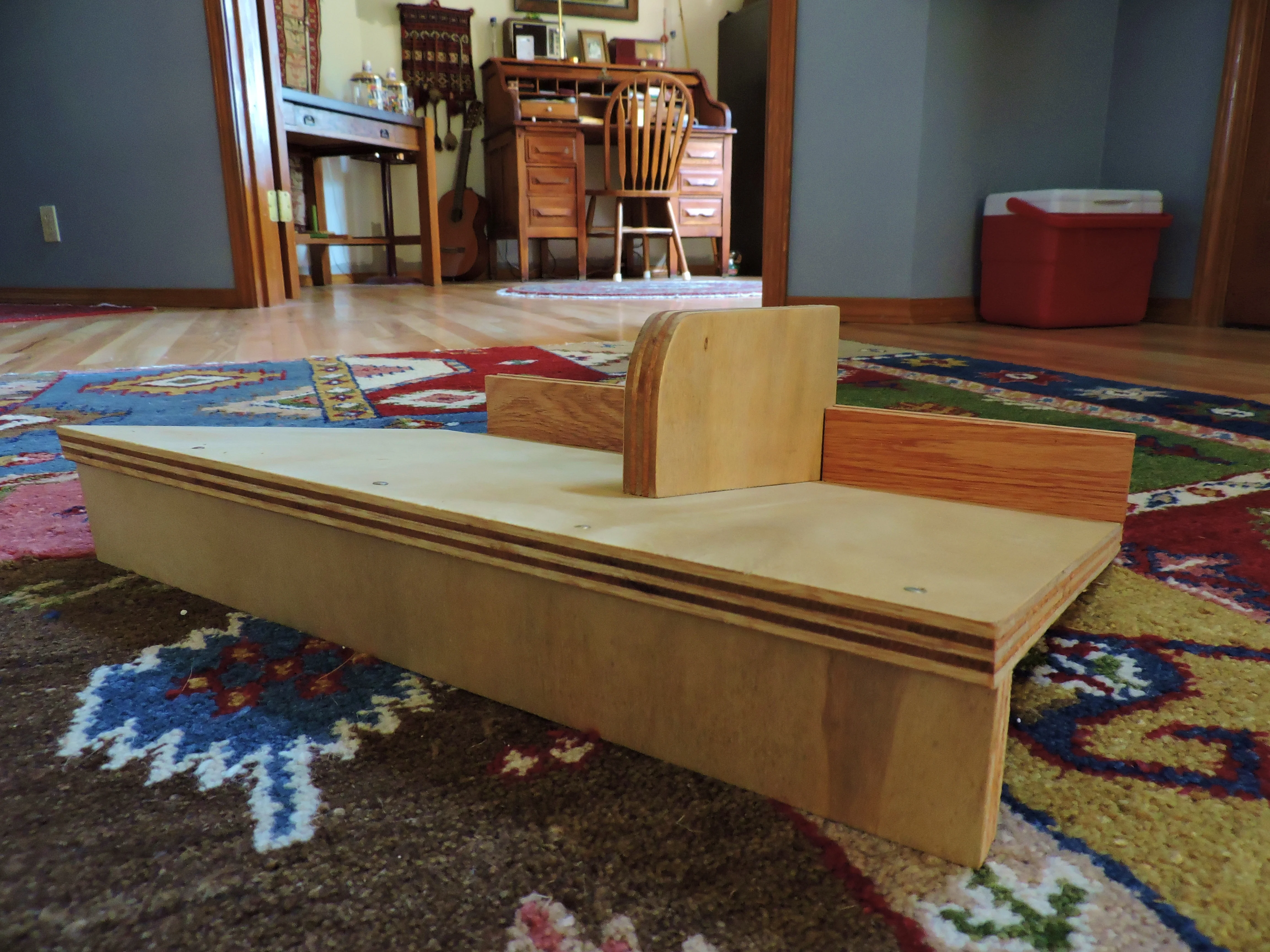

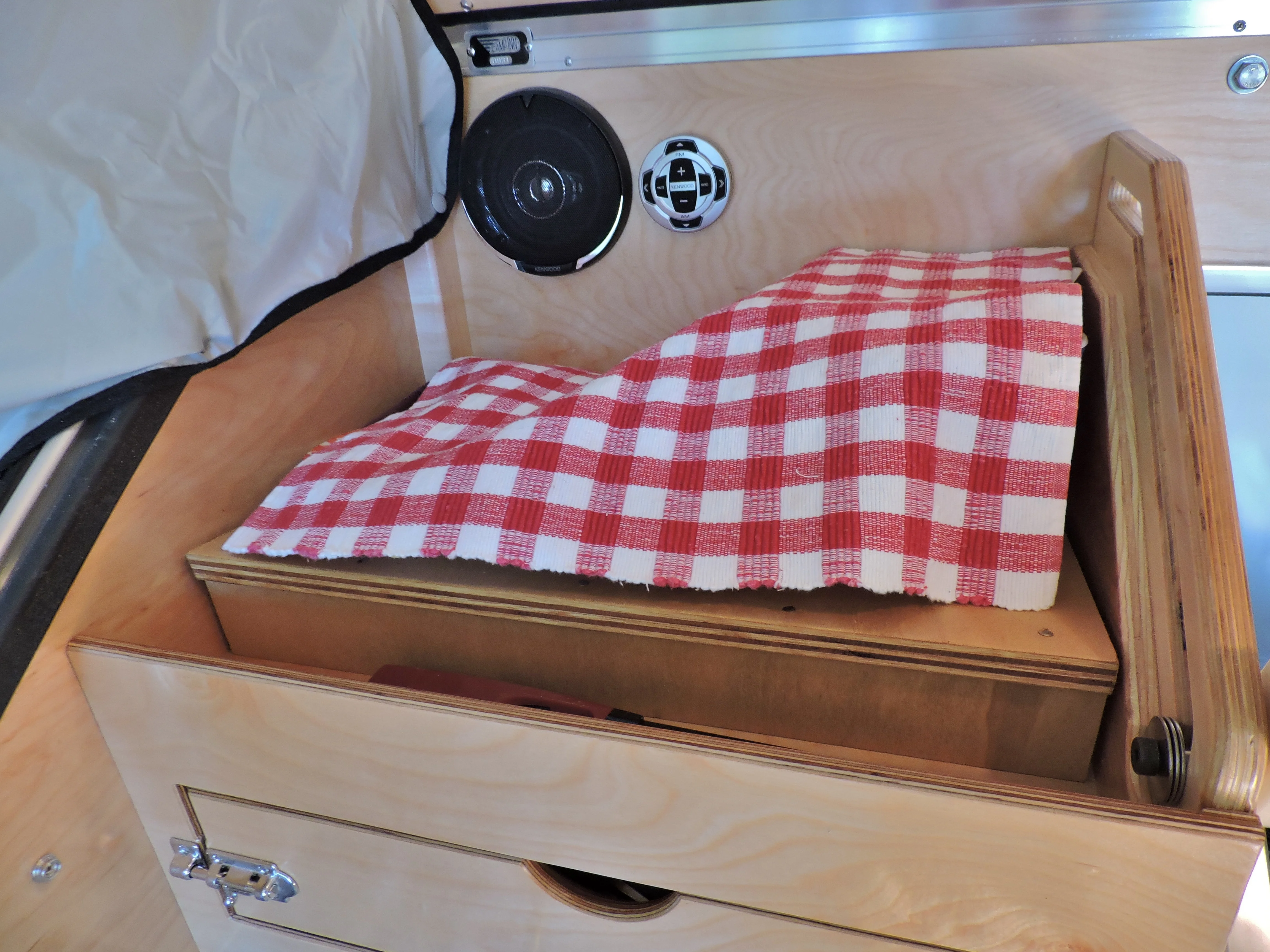

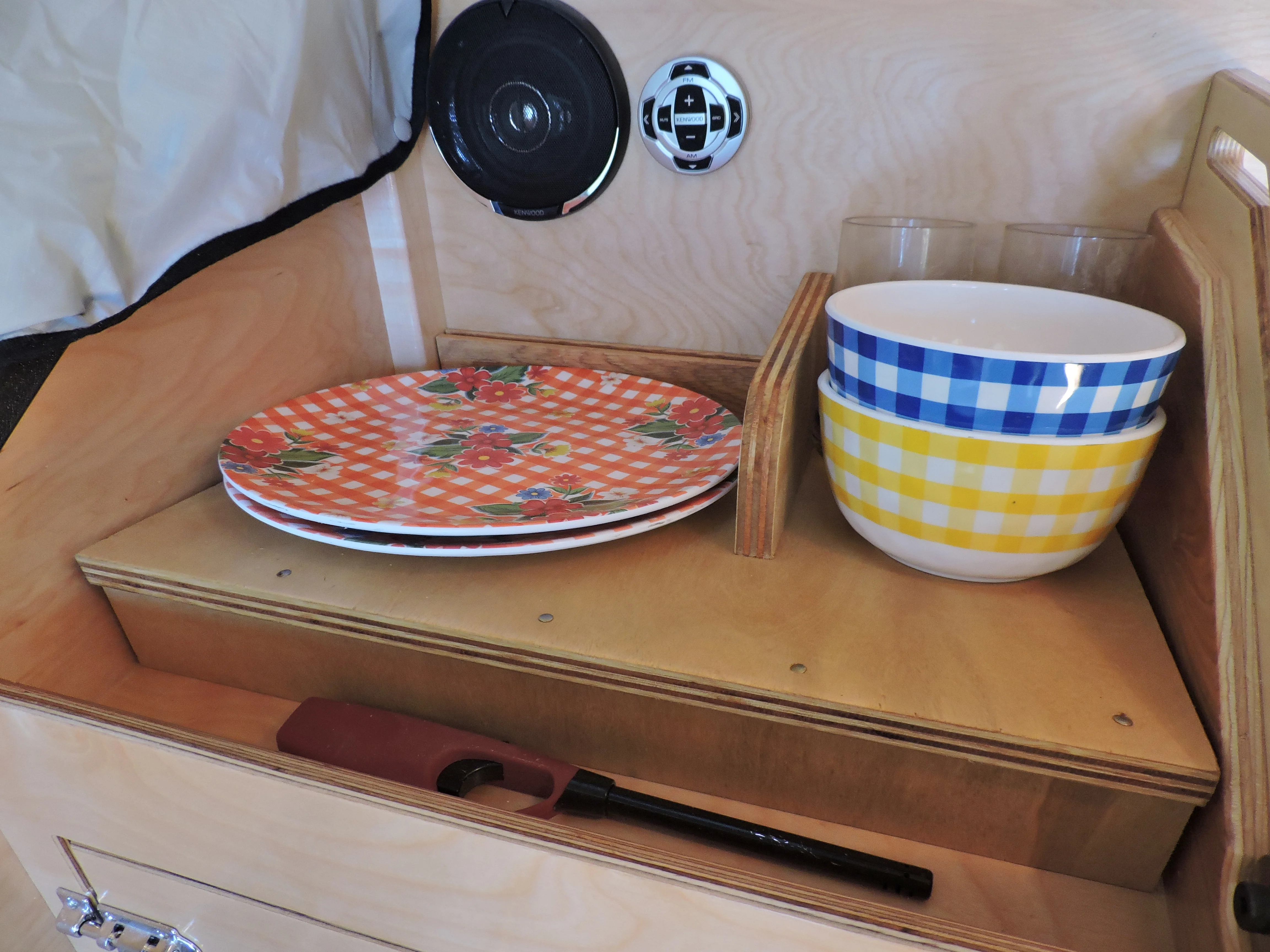

    Dishes always seem to be a problem. They rattle and don't always stay where you put them. To solve this problem I built a plate, glasses, and bowl shelf on the left. It tilts forward where everything wants to go so they stay in place. I store pot holders and dish towels under the lift space. It is designed and sized so it can be put in and taken out easily.

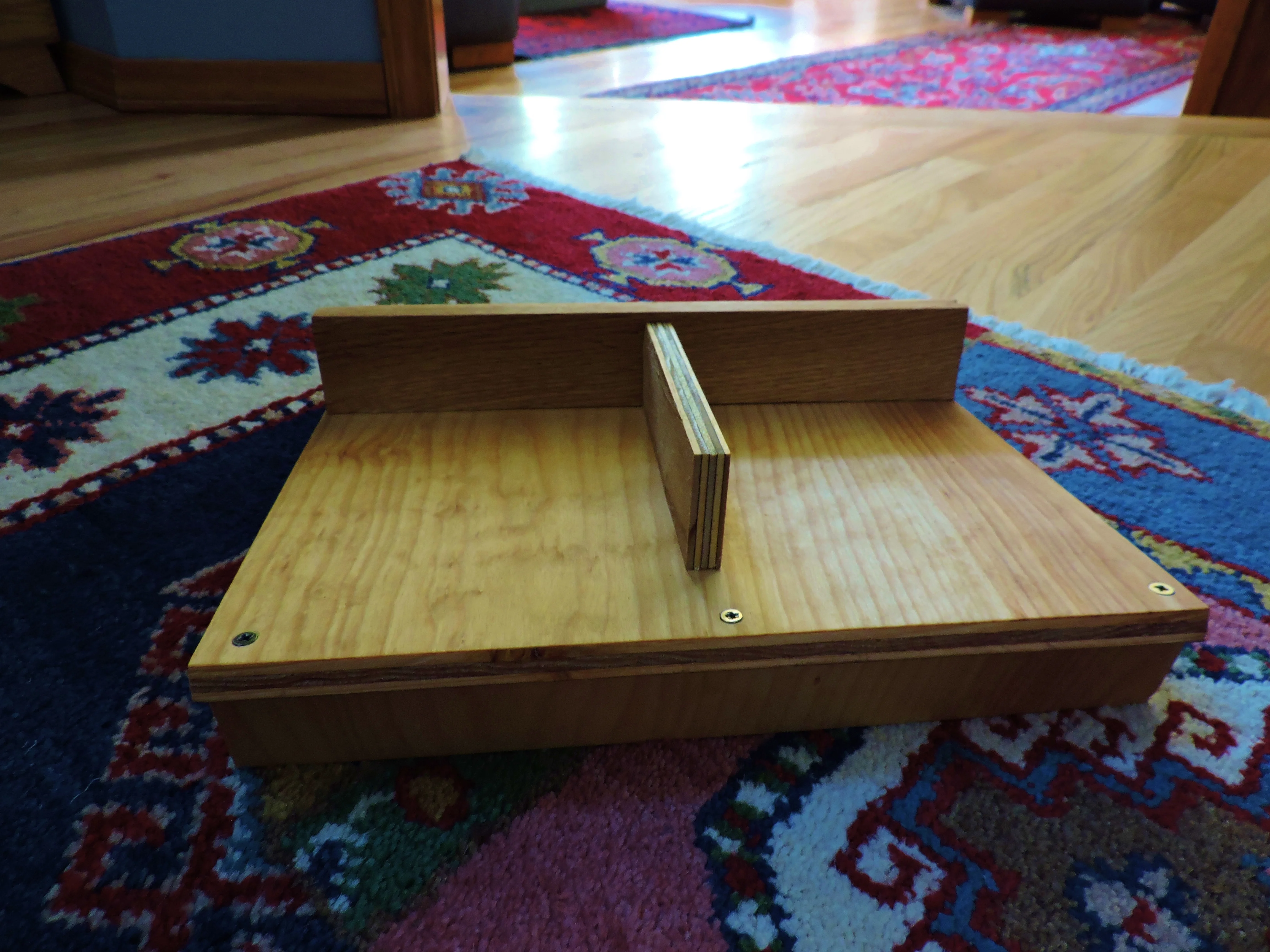

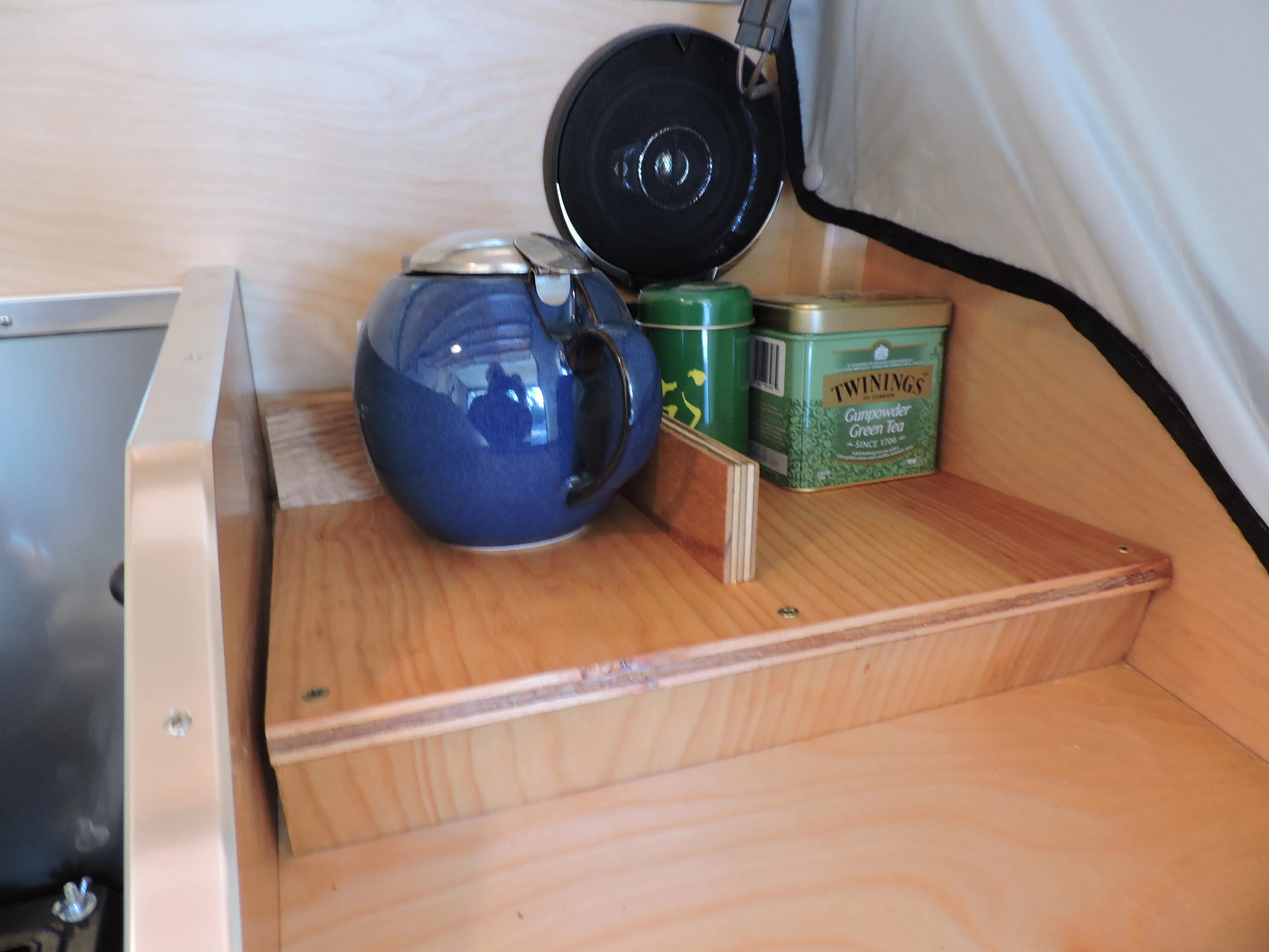

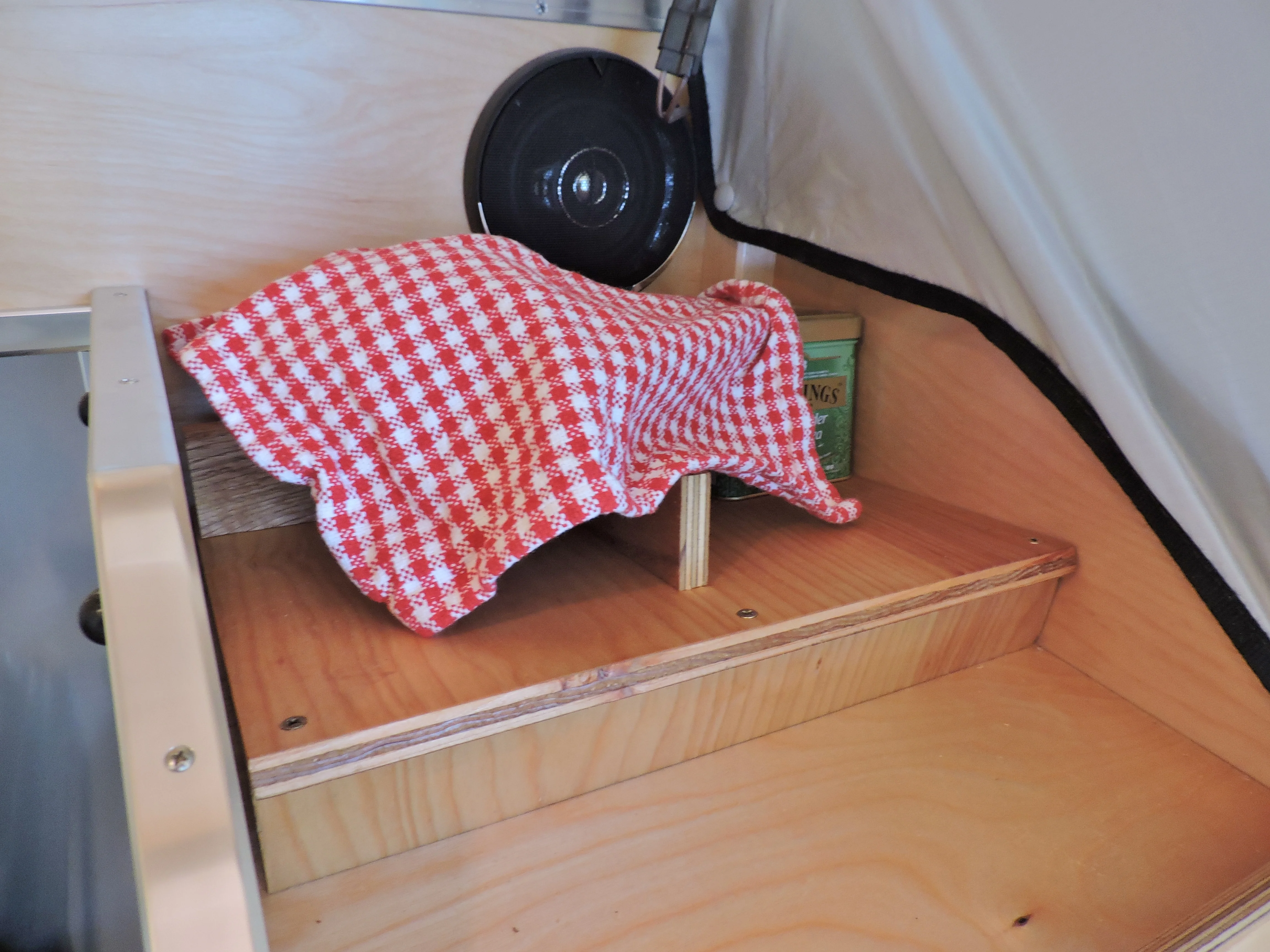

    Next I made room for my tea steamer and tea on the other side. The place mat helps keep everything in place. I also carry a lot of dish towels and pot holders and use them where ever needed.

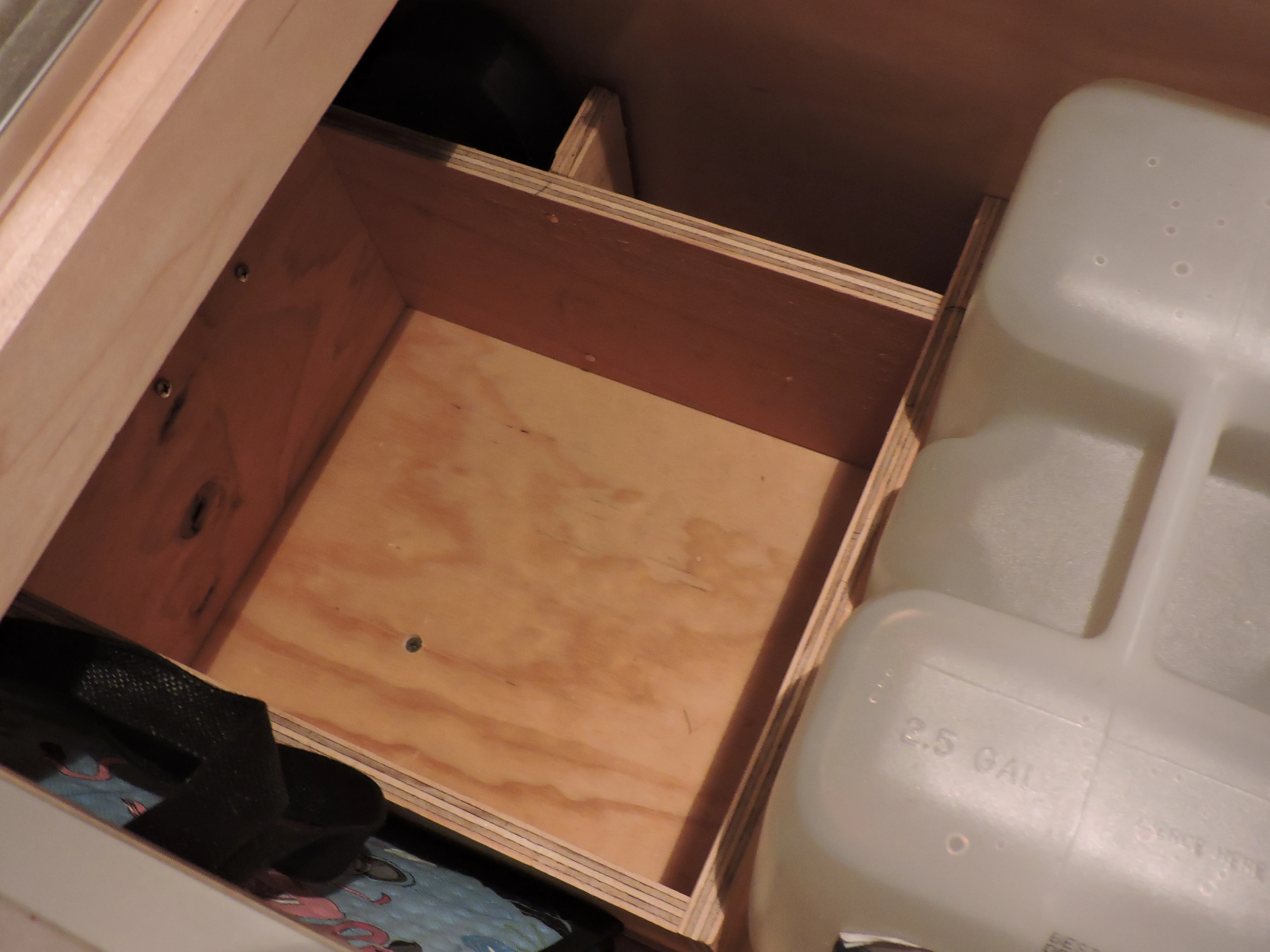

    I also built a plywood divider in the back. Beside it is two 2 1/2 gallon jugs of drinking water.
    Yes I know, not much work for two days.

    It is Corelle and made in the U.S.A. I used it for 10 years in the Little Guy and never broke a dish while traveling.
