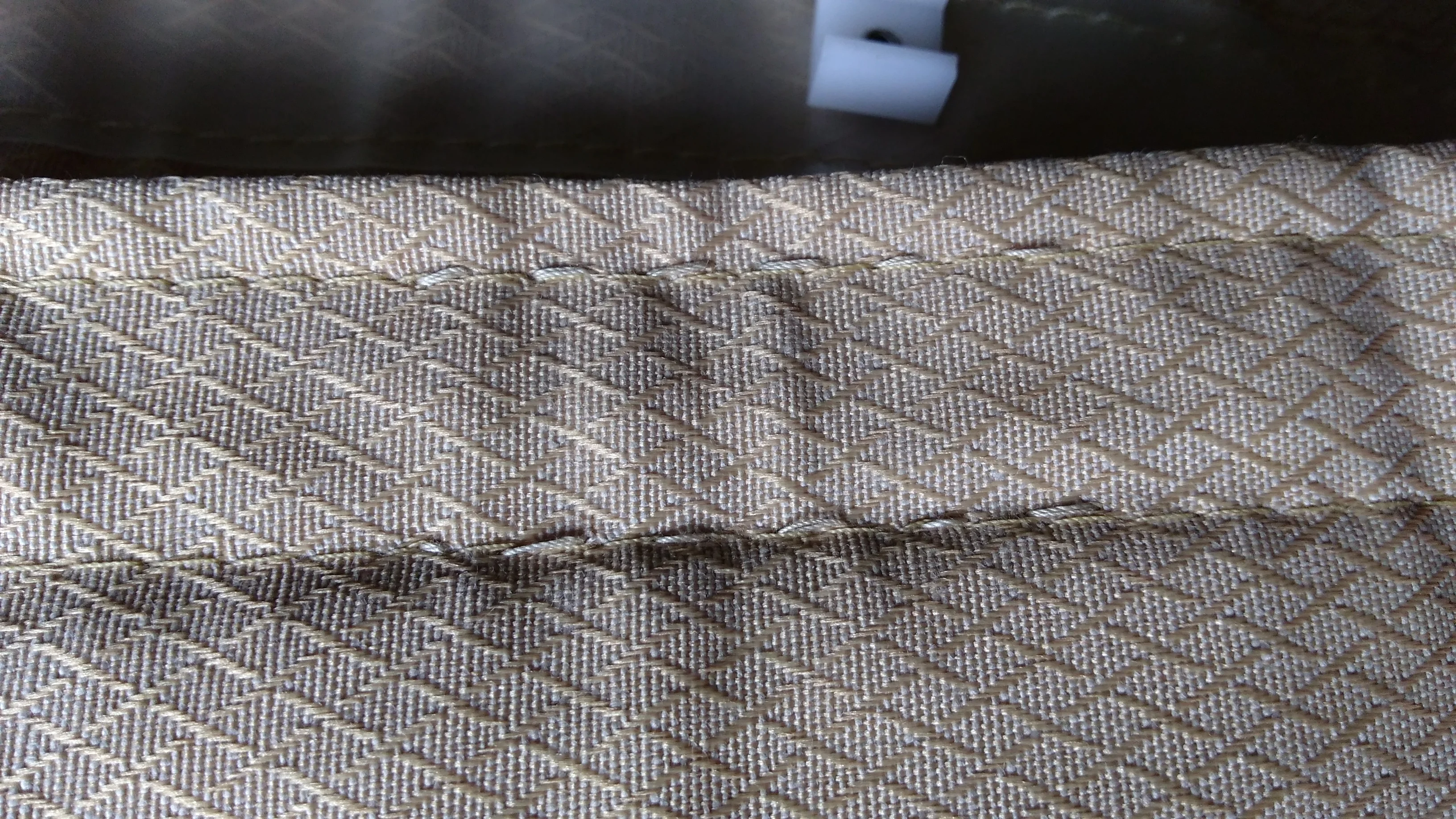

    I decided after a very dusty few months last year that it was finally time to dry clean our curtains. When I took them off to do so, I noticed that the curtain tape was torn in two places where the plastic slides are attached to the tape. The dry cleaner wasn't interested in repairing them for us, so we looked for our own solution. We've seen other Camp Inns with this same problem, so figured it is worth sharing our experience.

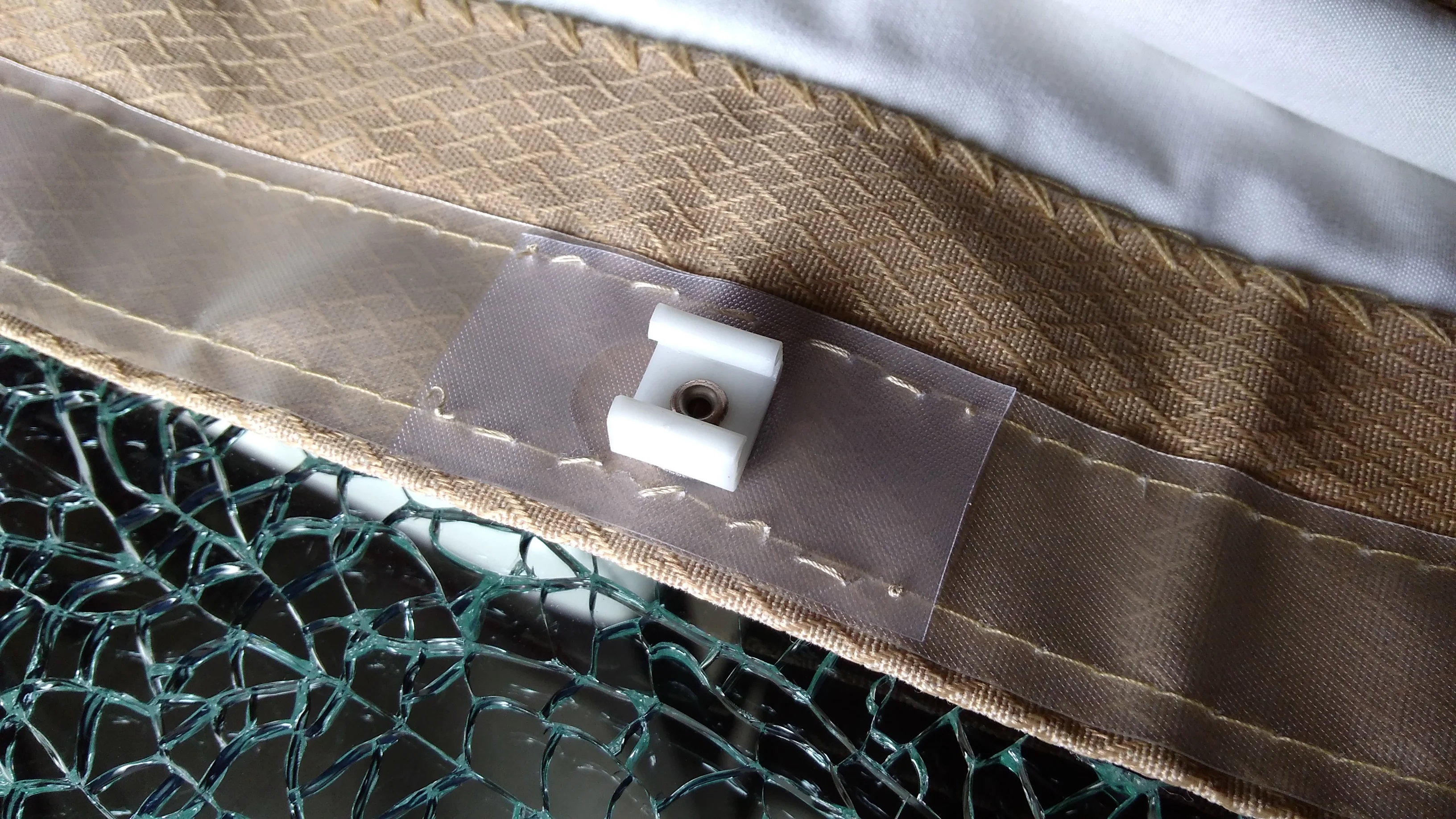

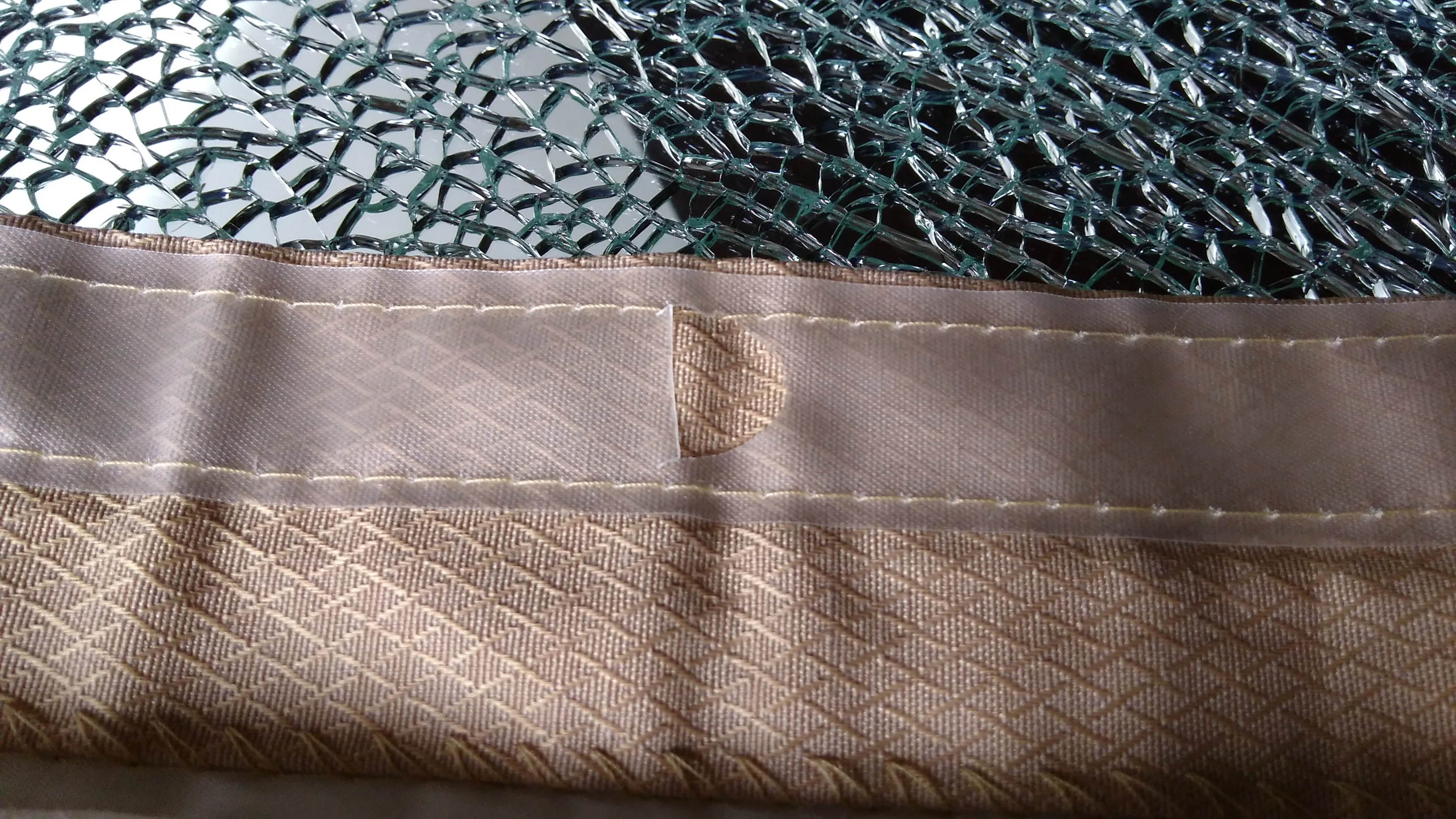

    Repair is a simple matter of cutting out the slides that are ripping away from the tape. Cut off a piece of new slide tape, leaving maybe an inch of so of plastic on either end. Then hand stitch them in place (there is no need to pin the new tape down, since you will naturally being hanging on to it as you thread the needle through). You might need a thimble to help get the needle through the fabric, liner and two layers of tape, but even using a fairly fat needle it was possible to simply wiggle the needle to help ease it through.
    CUT OUT THE TORN SLIDE
    CUT A PATCH STRIP AND SEW IT IN PLACE
    VOILA! THE PATCH IS BARELY VISIBLE!
