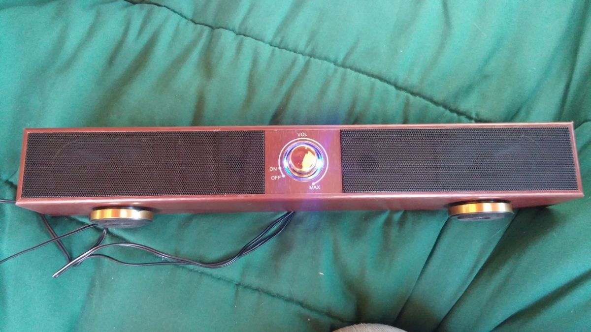

    Speaker out of the box
    Package
    Remove the small screw and the foot comes off
