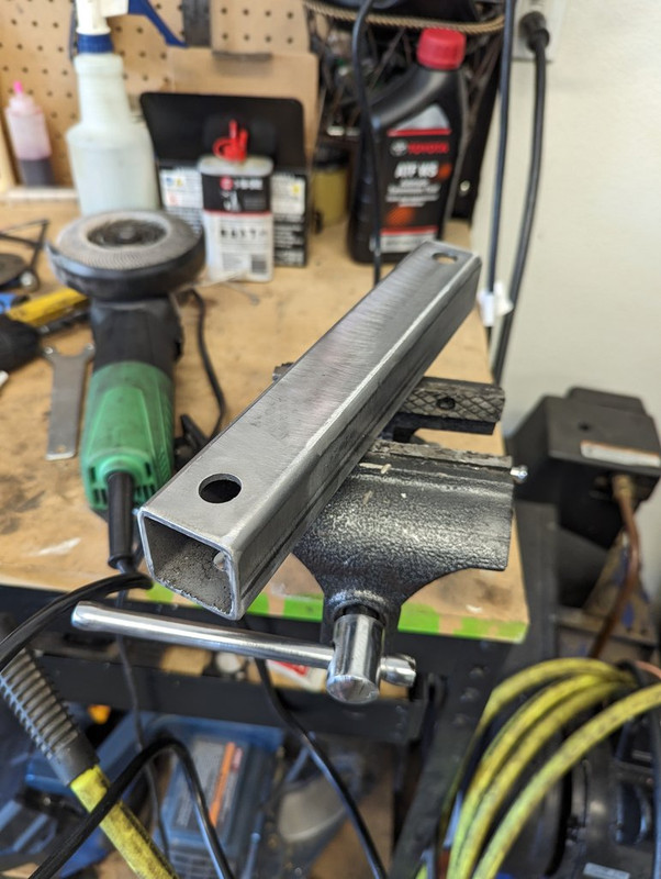

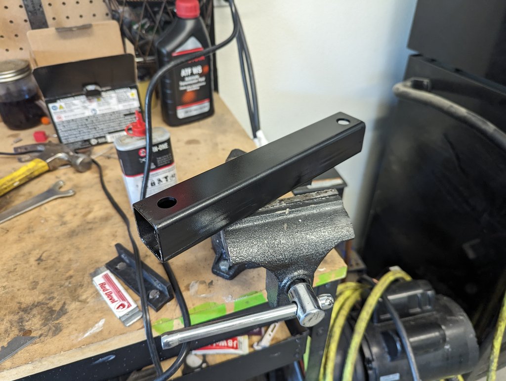

I cut and drilled some 1.5" square steel tubing as a lift spacer between the axle and the body. Worked wonderful.
Cary and team were kind enough to leave a good service loop in the brake lines which helped. I also gave myself a tad more when I previously replaced my brake assemblies.

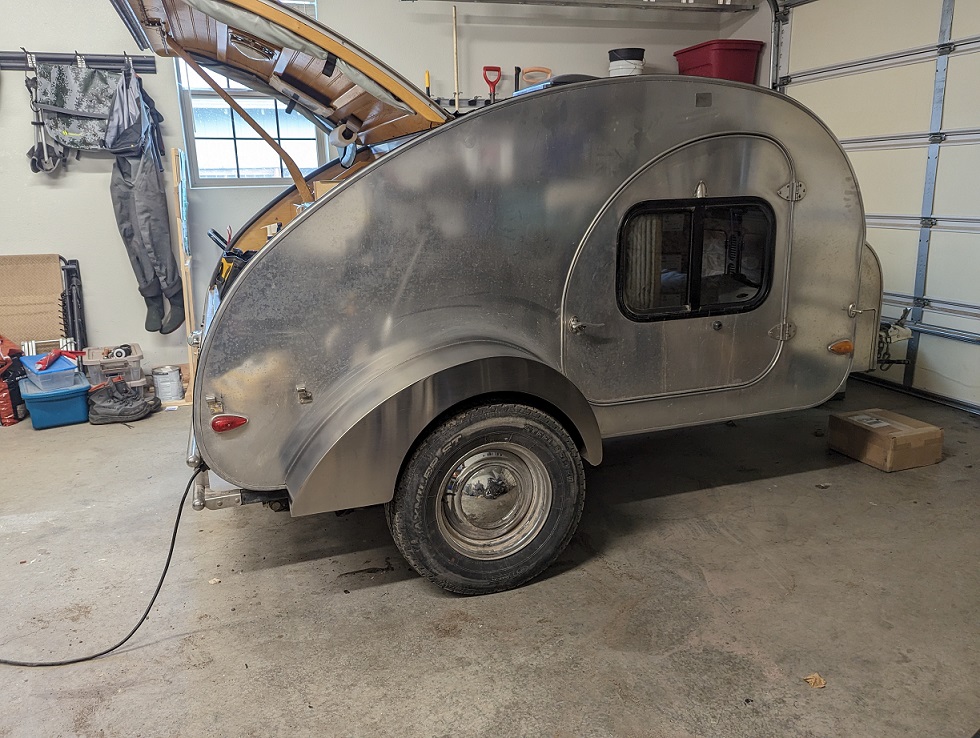

Before (with the fender chop)

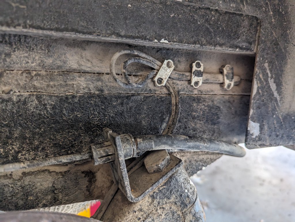

Before with existing brake line loop:
Steel tubing:
Painted to prevent rust:

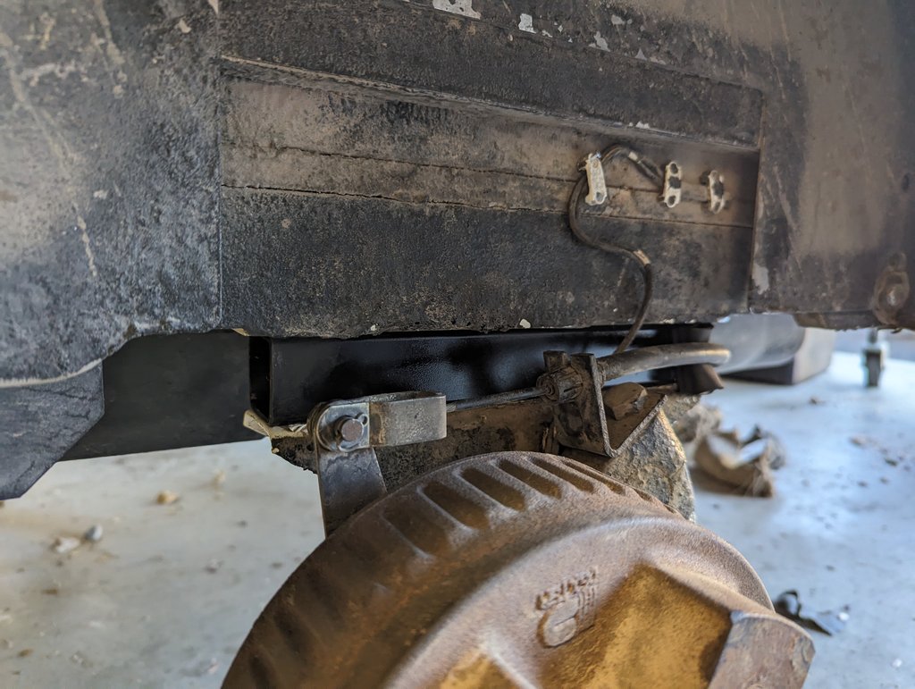

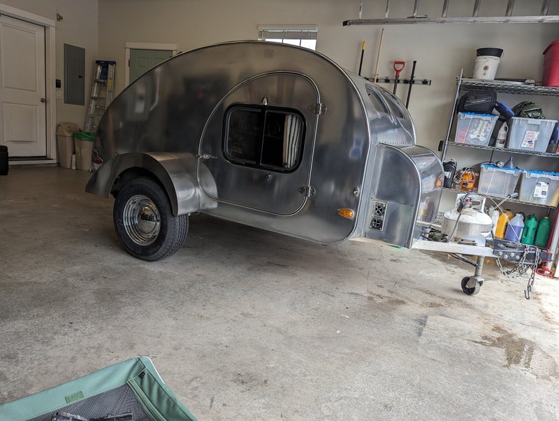

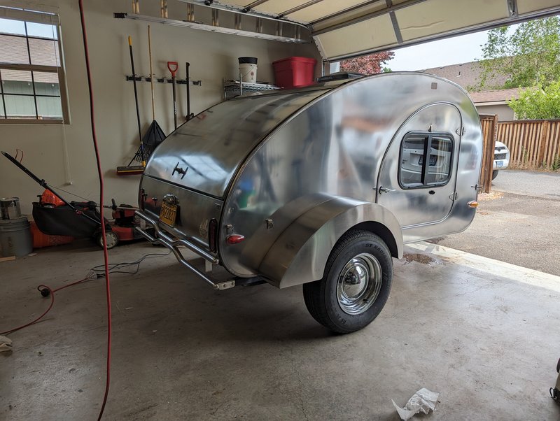

Installed with longer hardware. Plenty of brake line excess. Also added a foam adhesive section to help prevent wear on the E-Brake line on both sides:

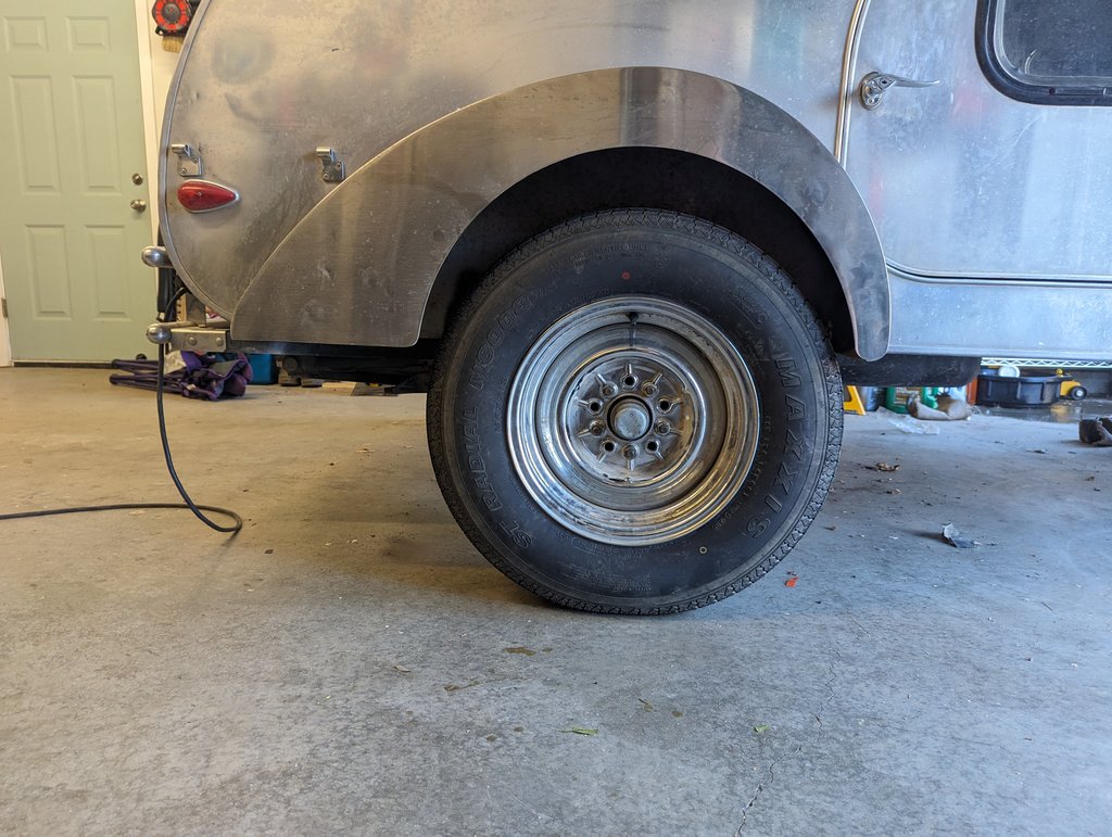

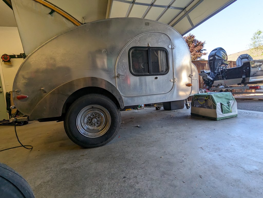

After photos:
Really happy with how it turned out and loving the higher ground clearance.
