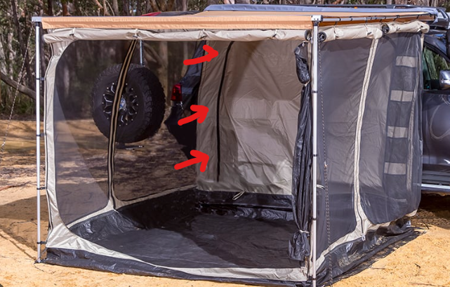

With the room/tent installed on the ARB awning curious what others may have done so you are able to open/close cabin door and enter the tent. We found a great couple on You tube (Adventures of the Memory Makers) modifying this but mainly for Bushwhacker campers ( The Wizard of Modz ) were the wall of the room seals around the door of the camper. I had contacted them and unfortunately their solution will not work on the 550/560s.
Just wanting to keep bugs out and still being to enter the cabin without having that big door open at all times. Was hoping to come up with a way to secure / seal the room to the side of camper just enough so to prevent or minimize entry.
Thanks in advance Kevin

My wife came up with an ingenious solution using suction cups. The ONLY downside to these cups is that they did leave a very slight mark on the skin - but it's not that noticeable -- not enough to bother me, but it does knock me out of the best-of-show competitions :D The suction cups she uses are from Walmart -- and they are strong. They get a little weaker on subsequent uses, but they are cheap enough, it's not a big deal to replace them.
I spend a fair amount of time on YouTube -- There are some really creative people out there. I saw one chap who cut the inside wall to align with his side door. He marked the door location with a hem marker, then cut the line with a hot knife of some kind --- it might have been a soldering iron. Then, piping was put on the edge as insurance to keep the tent from fraying. He also used suction cups to hold the wall a little more firmly against the side of the camper.
Think I can find it? NOPE! But I think of all the solutions I've seen so far, his is the most elegant.

Thanks for the suction cup idea and we will try it before our trip. Kevin

sorry i should have added that. Yes that is our plan, we won't know how successful this will be until we are in that environment. They make some pretty strong suction devices, some that will hold 600#'s that are used in the glass / car windshield industry. We could be dreaming that this will work LOL. I am looking for something that attaches to the camper then the device will still attach through the fabric but have not found it yet. Almost like a clamp if you will.
I just ordered these and hope to do a trial run before our trip. May have to add some smaller ones but wanted to see how well 8pcs would hold.

There's still a lot of gaps. It keeps things better, but still not perfect. If you're a maker with mad sewing skilz, I don't have a link for it, makes a J channel that you can stick to the camper -- i actually think they have it pre-cut for the campinn door. THen you can sew in an umbelicle that will give you a tight fit using an elastic band to hold the umbelicle in the J channel...if that makes any sense.

Just an update I received and tried the suction cups. No Go :(
Not sure if it is this brand but no matter what I could not get them to work with the material between it and the skin.
The flexible gutter rail has me interested as a complete seal is the solution. I just wish i knew what that material is??? We use a product called trim lock that I'm looking at next.
