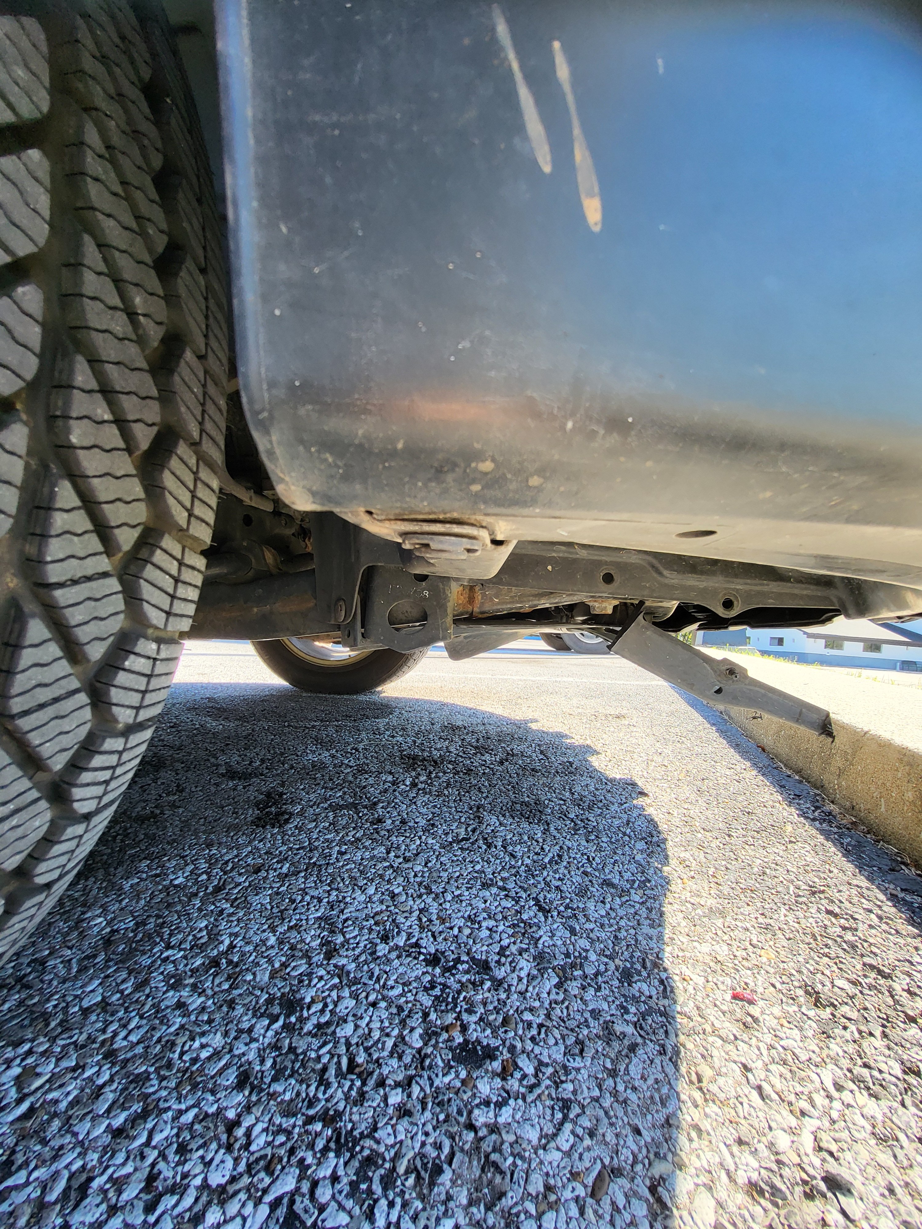

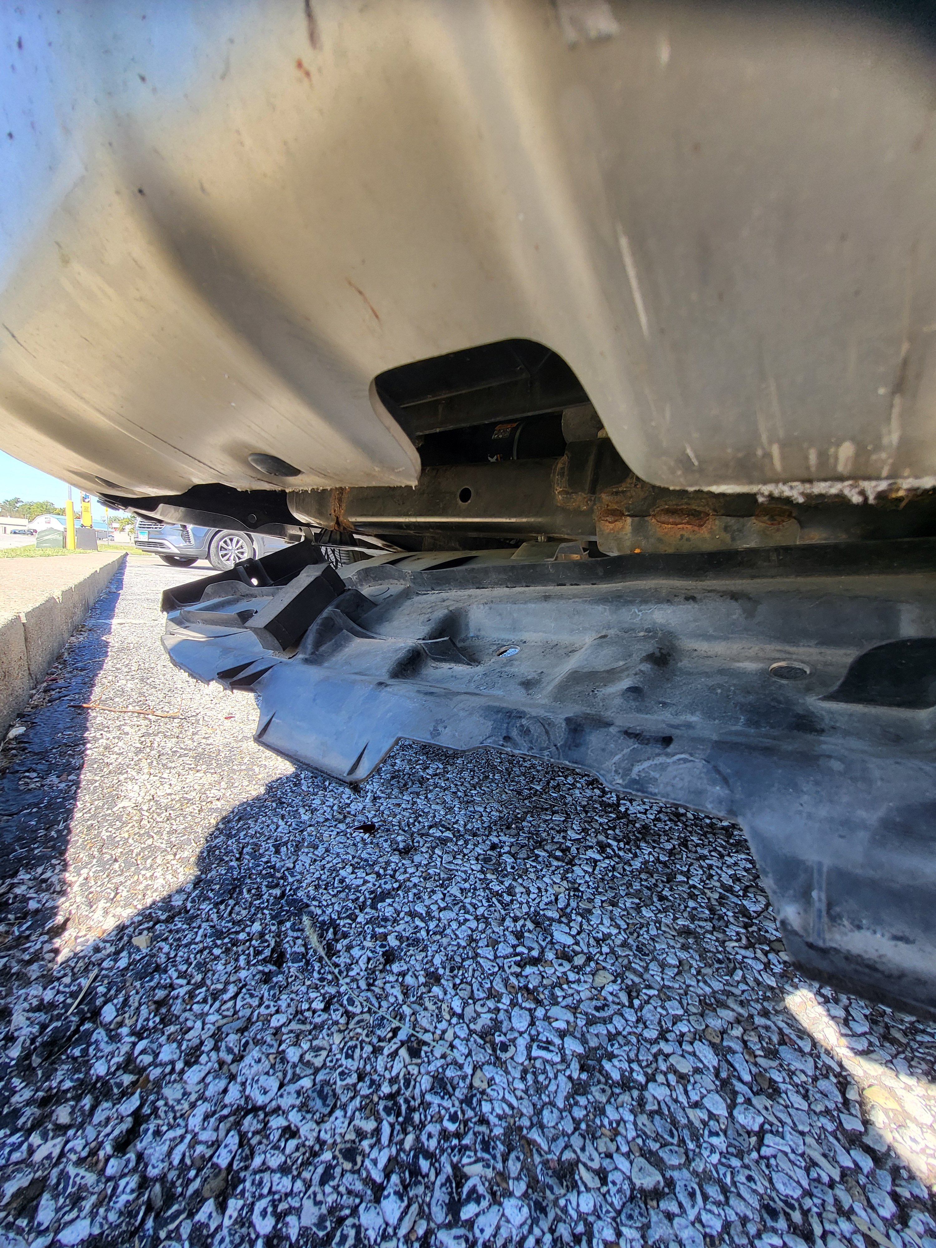

I just had a moment on i57 south in illinois where i ran over what must have been a bumper that fell off a semi. I had a car to my left and could not swerve to miss the thing in the road. I ran over it. It busted into pieces and damaged what must be part of my bumper and front under carriage. Its plastic. It makes some noise but I can drive. What do you think ? I think it's just part of the bumper undercarriage. I'm going to try to drive and secure it with bunngies or tape and keep on driving to nashville. Whoof.
Zip ties last longer, I had to do something similar on a wheel well plastic liner. Big zip ties can be chained together in circlet or zipped together one to another for longer spans.
Wire coat hangers can really last a long time, you need pliers to “tie” them by putting 4 or twists in two ends.

Not a subie guy but
"Looks like"
these are both plastic trim pieces for undercarriage airflow you can zip tie until you get to a repair shop.

I finally determined that it would drag up to about 45mph and then by 65ish it wasn't dragging but what a darn lot if noise when it did. Finally got into a car shop in our nashville neighborhood and the man laughed, laid down in front to the car and began ripping the thing off. Its what you said, a dust heat protector for under the front. He said I dont need it but if I bought one on Amazon and brought it in he'd put it on the car. He said he rips broken ones off cars all the time. So...that was more excitement then I wanted today.
