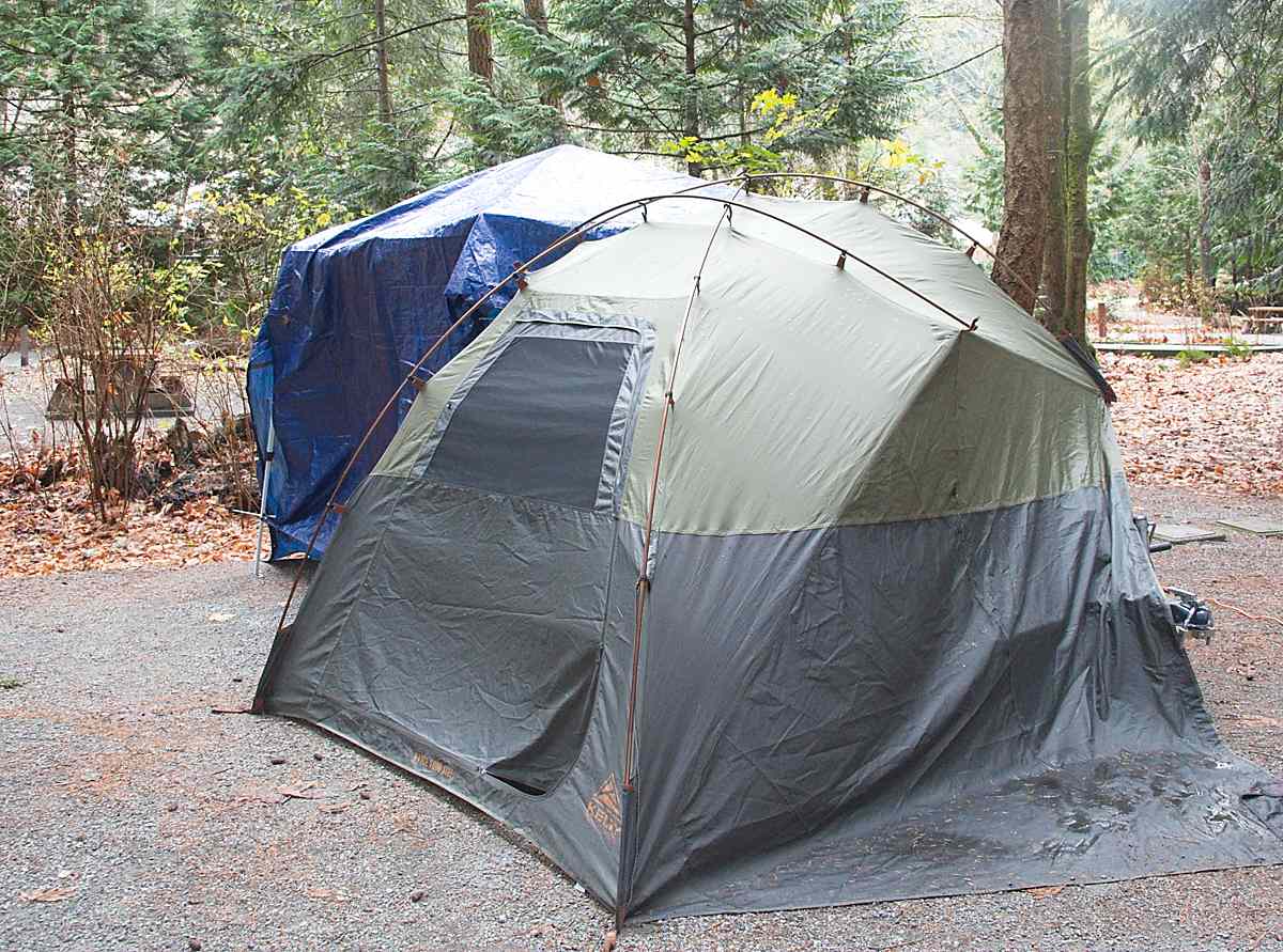

Currently we are using the Kelty Highroads shelter for the side tent on my wife sides and have been very happy with it. We had high winds on our first trip and heavy rain on this last trip. The Highroads handled both of those conditions very well.

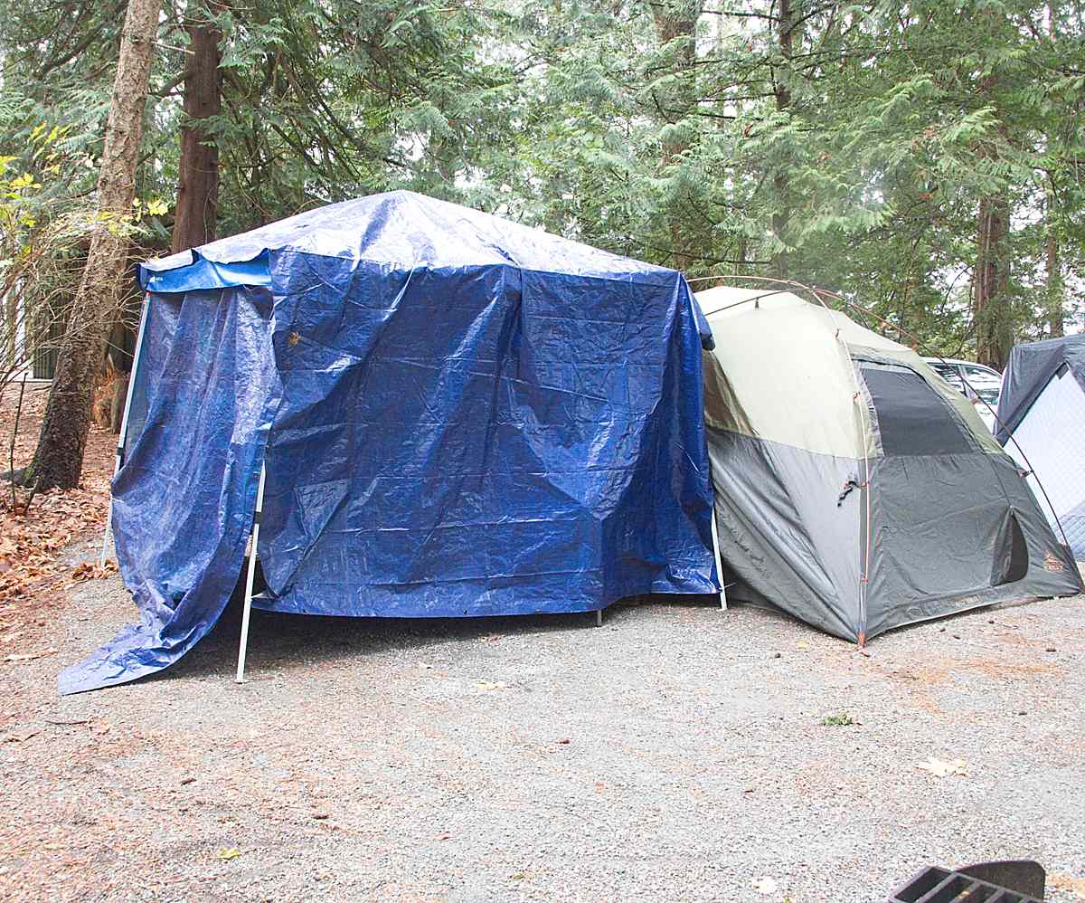

We are using a Walmart pop up canopy with blue tarps attached to the sides for a Galley cover. This approach works but set up is a bit cumbersome and we like the Highroads so much that we are probably going to order a second one to use as the Galley cover.

@SethB: Thank you for clarifying how the battery disconnect works. I looked hard at the Kelty Backroads as well. We ended up going with the High Roads mostly because it has Aluminum poles. I have had issues with Fiberglass ones breaking in the past but I am not overly carful with tent poles so that is probably a factor as well.

…We ended up going with the High Roads mostly because it has Aluminum poles. I have had issues with Fiberglass ones breaking in the past but I am not overly carful with tent poles so that is probably a factor as well.

That’s what I’ve been trying to figure out this morning; it looks like the Backroads and Highroads may be the same design? Except that the Highroads has slightly heavier fabric as well as the aluminum poles, which sounds great!

Yes I think you are correct that if not identical the design is very similar. Just the materials used are different. Attached is what it looks like with our Camp-inn.
The picture showing the blue trap set up over the gallery is what we are thinking of replacing with another Highroads.

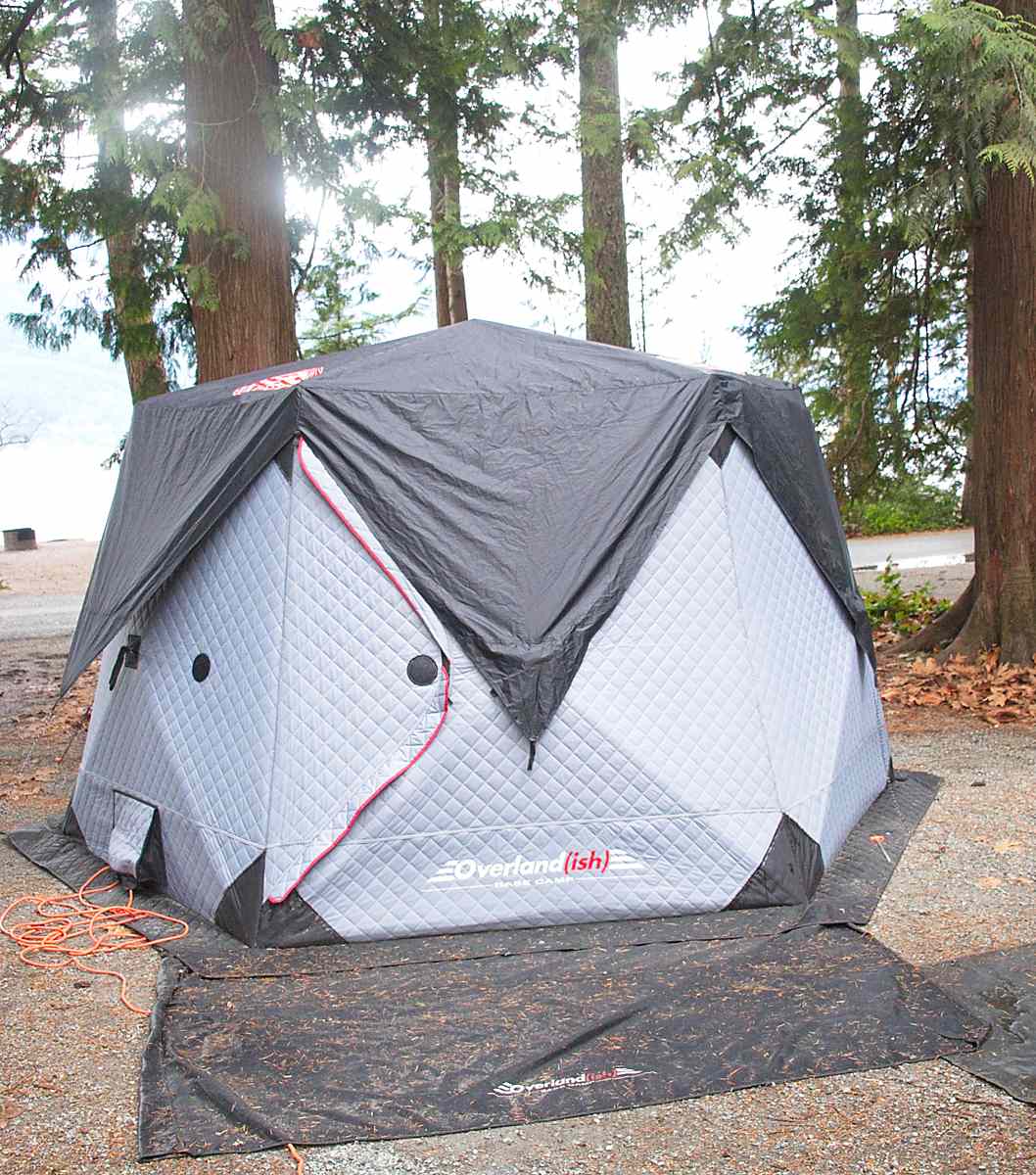

The Overland(ish) is our living space when we need to get away from the elements or bugs. It was our last tent camping set up and although it did not work well for that purpose so far it has done a pretty good job providing additional shelter as part of our Camp-Inn set up.

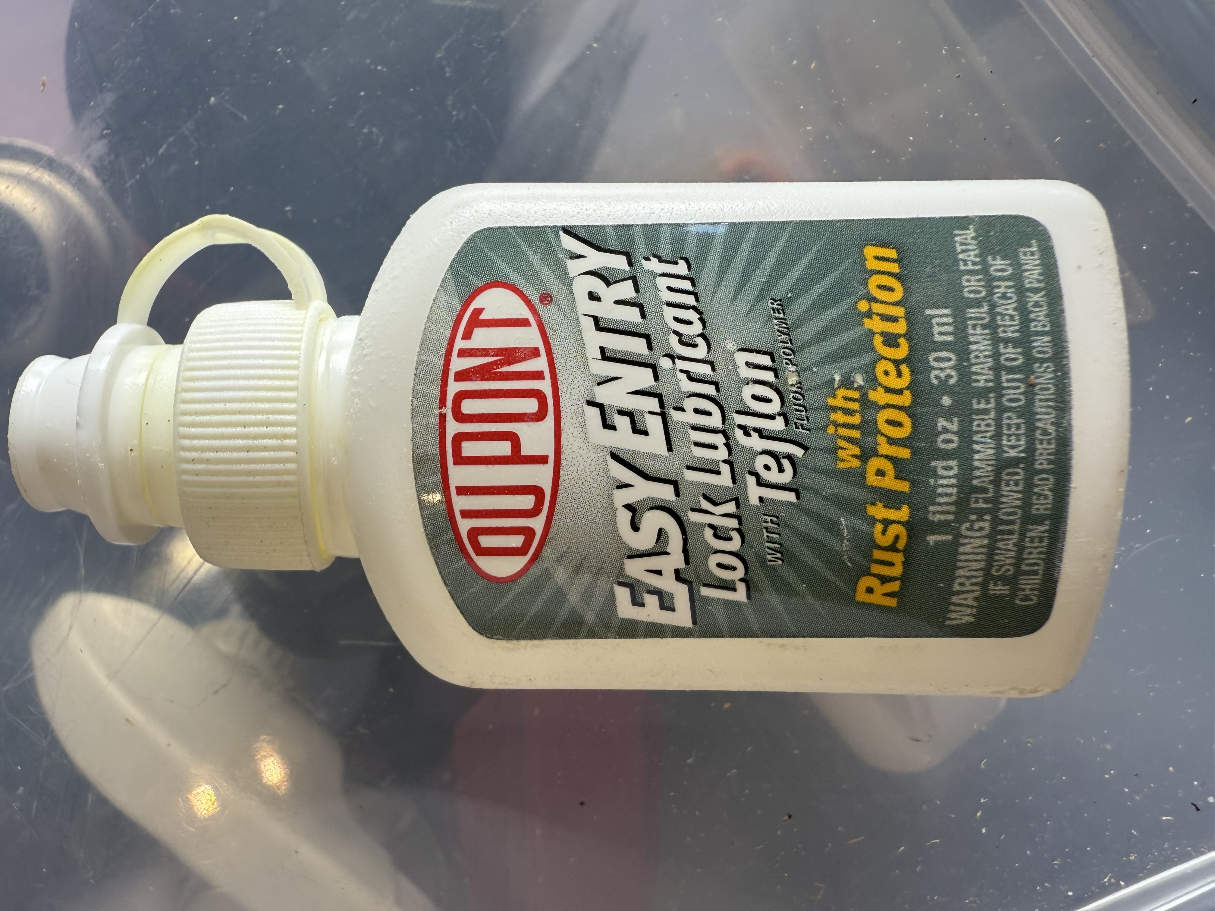

Particular brand? I see WD40 has a silicone spray lubricant. Yay or nay?
