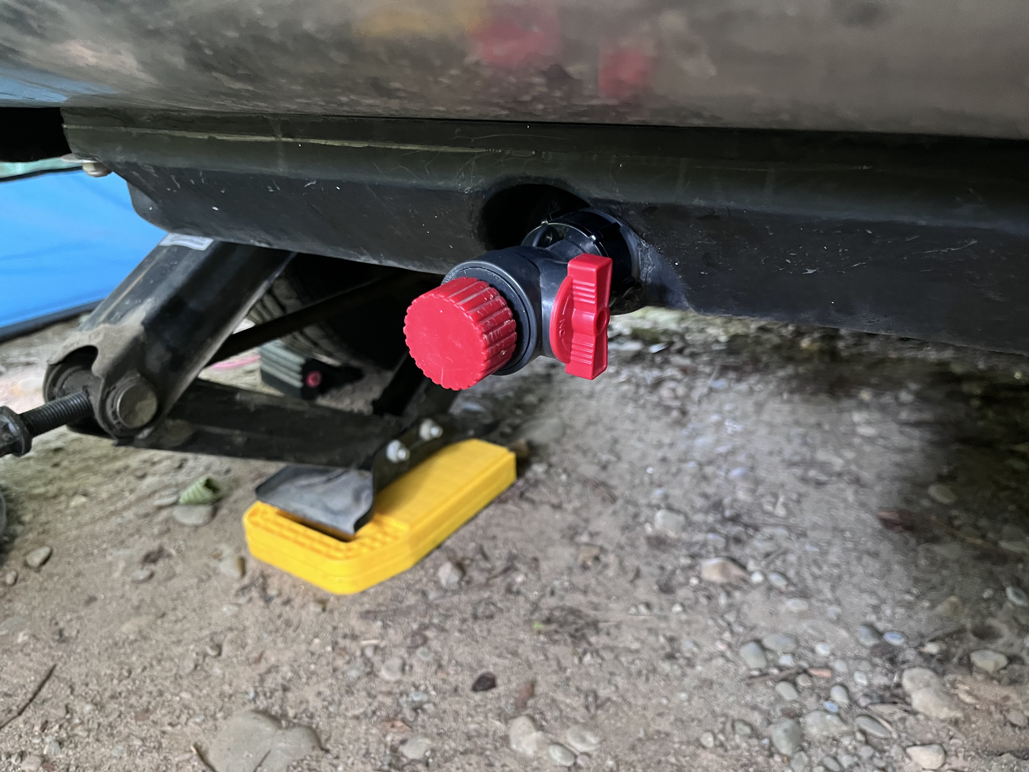

I have a plastic shutoff valve on each tank drain. If I recall they are from Camco, but I don’t see them for sale now - theirs is now brass.

I actually think they came from home depot or lowes. I just looked and don't see them at the big-box shop I use. But these are just garden hose fittings. The larger the inner diameter of the valve you can find the better, to allow the tanks to empty quickly.
I have a brass one (my plastic was damaged) and its OK but the cheap plastic one was better. Check tractor supply, bomgaar your local ace....
The number I found is "GC5143L" which comes up in searches.
Be careful if you are using anything with metal threads --- they will "cut" new threads and cause a world of hurt when they won't seal with the tanks any more.
I replaced the yellow drain caps with these ball valves. They are threaded so one could attach a hose or hose quick release.
