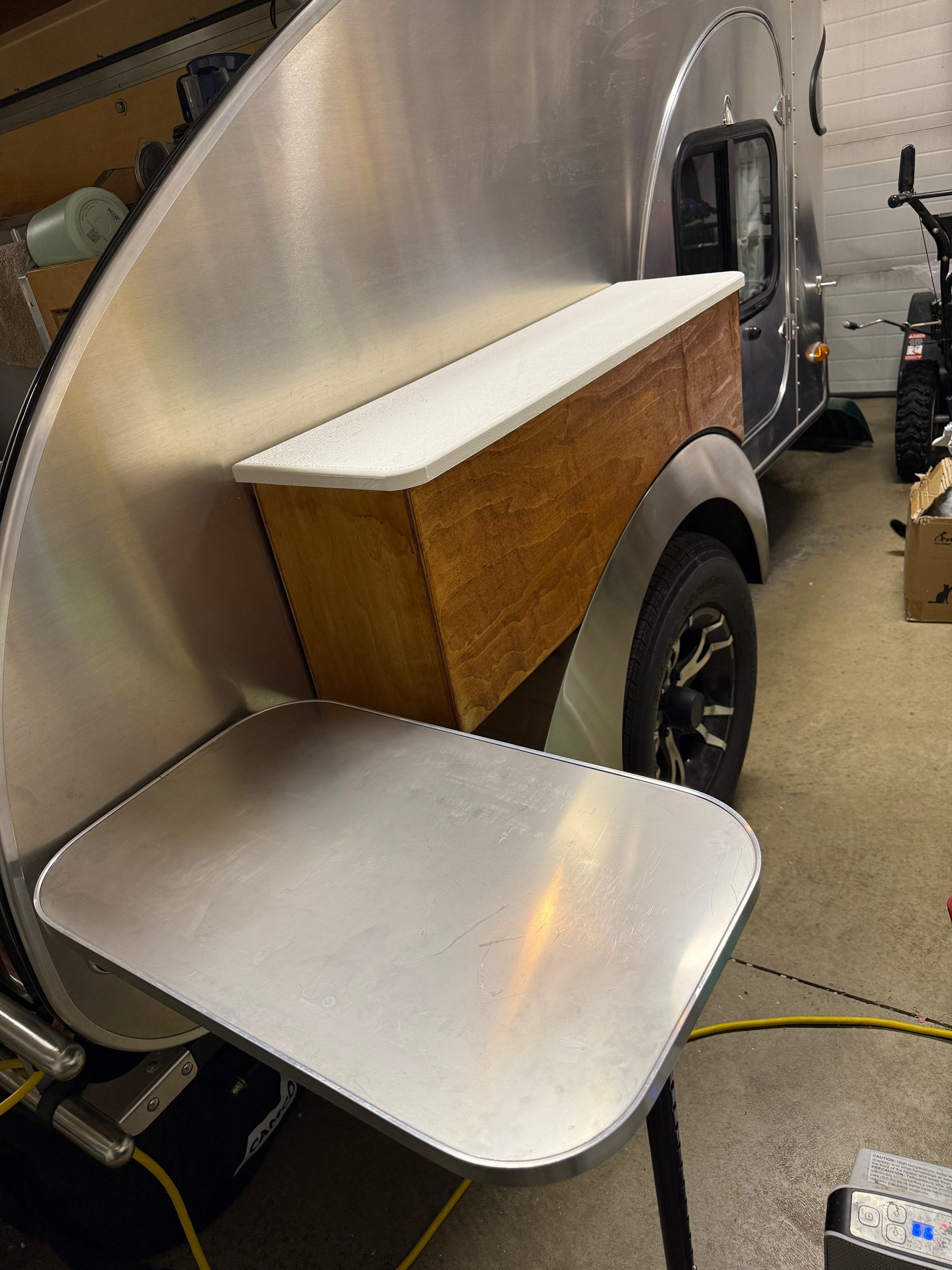

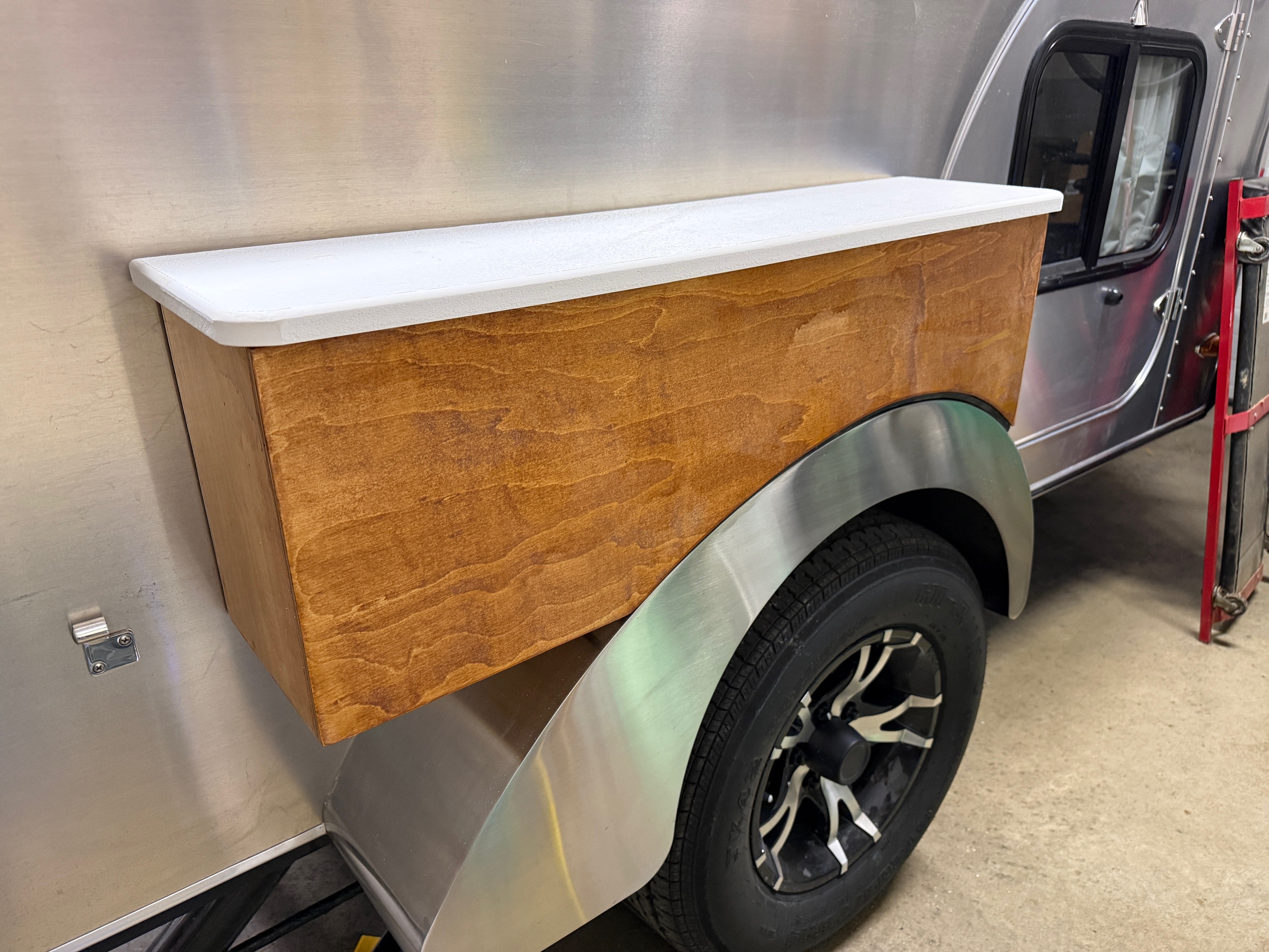

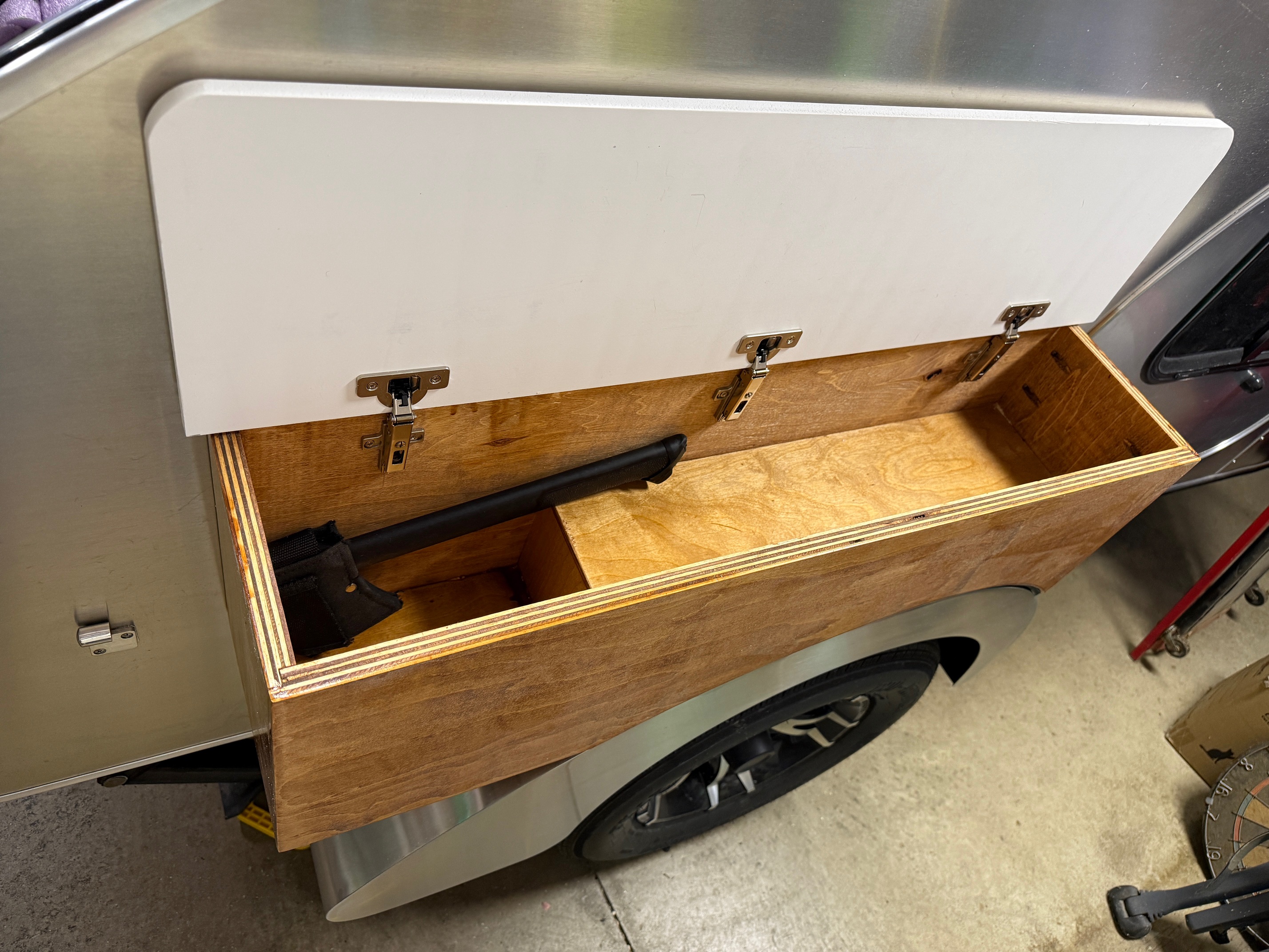

Since we weren’t camping over the winter, I was making little accessories for our 560. One of these was a storage box to sit on the fender. I’ve got my little hand ax, our first aid kit, a medical device to help putting on my compression stockings. And anything else that I’d like to keep handy. Built this out of scrap birch plywood and a scrap piece of PVC board for the top. Used 3 European style, slow close hinges to hold the lid up. Should be pretty waterproof and has rubber weatherstrip on the rails that ride on the fender. A small strap and clip to the bottom of the fender makes it easy to level. Throw it inside the camper while on the road. Will report back how it works as we get to use it this summer.
Open to additional ideas and suggestions for improvements.

Will use this box as is for this camping season to see if issues or further ideas crop up. Hadn’t thought of an access on the end to store shoes at night, but I do like that thought. Front of box basically lines up with the front of the fender, so space is limited, but I would sit on the bed, slip off my shoes, put them in the box then close it up as I crawled into the cabin. Clearances probably wouldn’t be a real issue as long as the door wouldn’t pop open. Even then the box is held only by gravity, a hard push and the whole thing could slide off the fender. May try making a shoe box for the other side of the camper just to test some possibilities.
This looks great. We carry a footlocker size tote in the camper for all that crap that we need access to but don’t want to have inside the camper once we are set up - lanterns, puppy beds, tarps, pie irons, etc. This looks like a more elegant solution but with a lot less space than our footlocker provides.
Since this isn’t anchored to the fender at all, will it slide off if you put heavy items in the deeper part of the well? Is this mostly waterproof-ish?

I’m thinking that with the overhang of the PVC top it should be largely water proof while outside, however it is also under our BunduAwn, so didn’t think it had to be hermetically sealed from water.

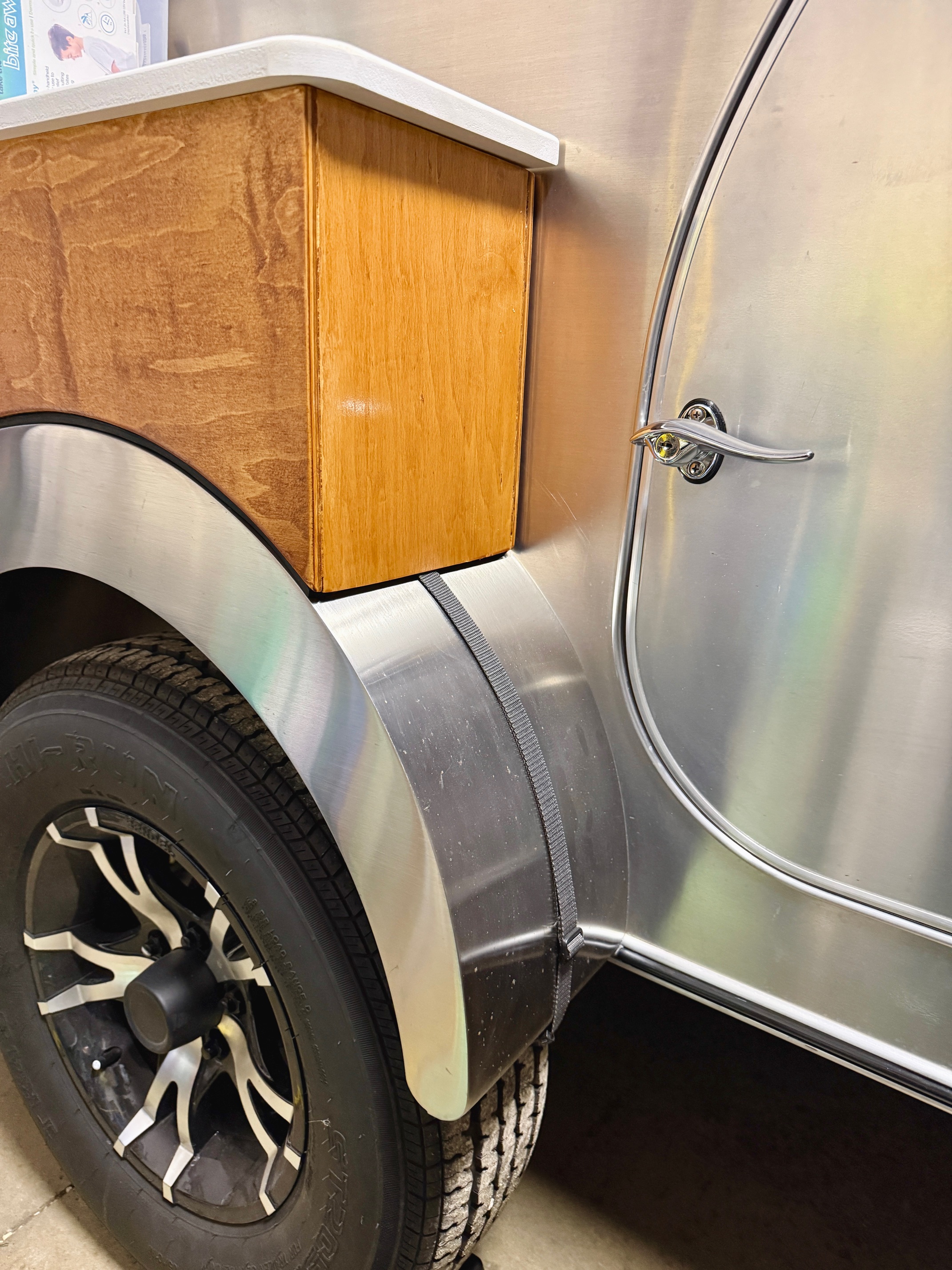

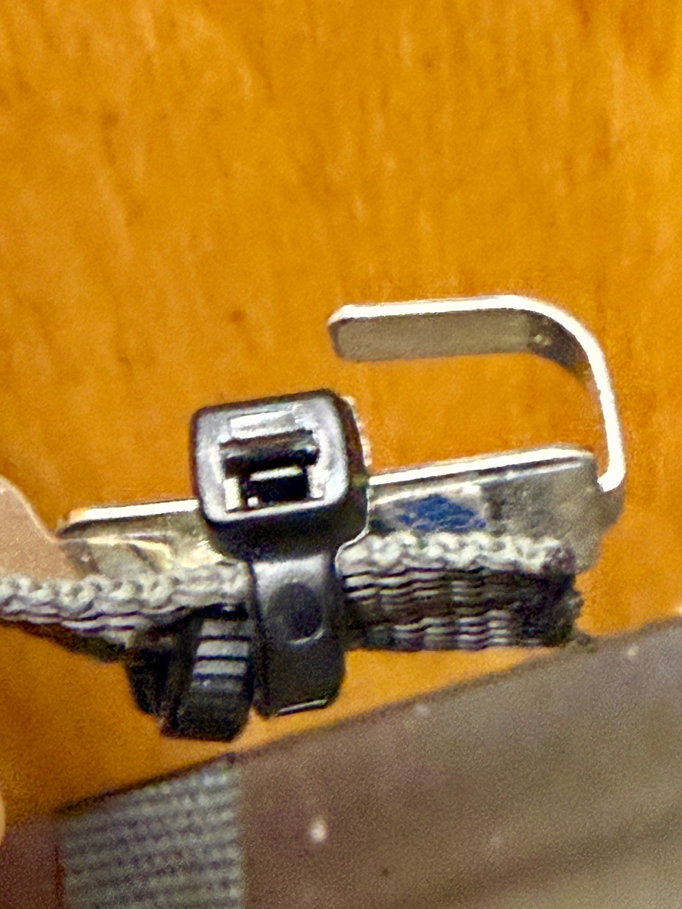

Regarding anchoring it, thought I mentioned a strap on the front of the box (opposite end from the deep section). Adjusted it so with the trailer level, the clip positions the box to be level, but I didn’t explain that well nor did I provide a photo. Hopefully these illustrate what I’ve done a bit better. Just used a metal 3M Command hook attached it to the strap with a couple nylon straps and hook that on the bottom front edge of the fender. I would expect it to take a heavy weight in the back area to cause positional shifting. Haven’t used it yet as I think I mentioned, so should find out soon as we start heading our camping over the next several weeks. So technically not anchored but hooked on the front of the fender. Do not expect to need more than this. Will report back if/when I encounter any problems.

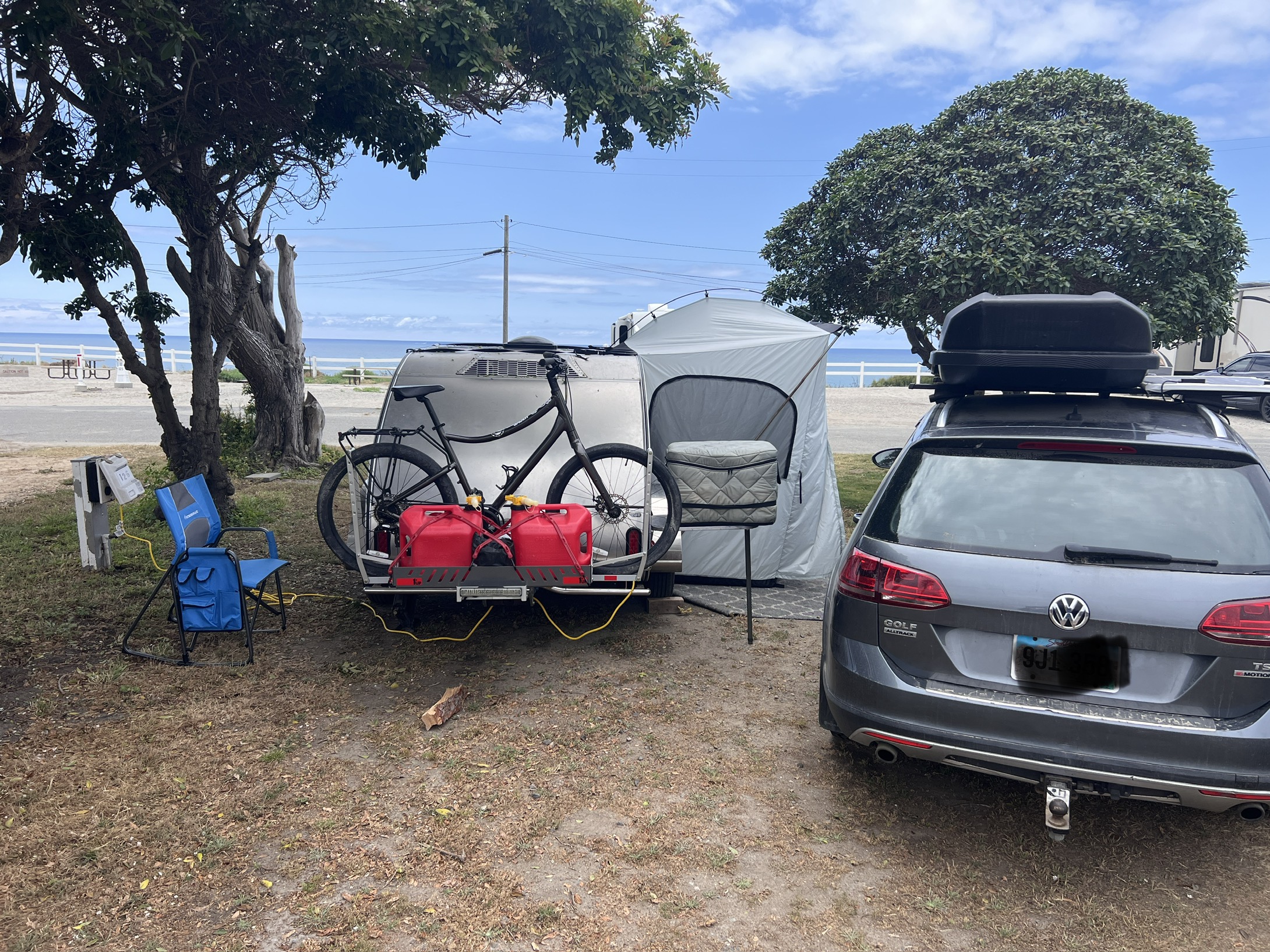

Right now the 5gal plastic jugs ride on the 1up cargo kit just aft the single bike, empty, to be filled only before turning onto USFS road to go boondock - where a gas jenny might come in handy on multiple cloudy days no sun
And
plus gas for the Alltrack if I miscalculate how far back and out on a route...
I dont really like carrying them there too long as the IUp rack, bike, cargo kit by Iup is probly not far from the limit for CI bumper hitch attachment...
And the moment arm could induce sway in a diverging oscillation which is no bueno at speed...seen those youtube vids in towed vehicles that do, too heavily aft loaded?
Ahhhh, yes yes. Sorry, I now see the mention of the strap in the original post. I just didn’t visualize that when I read the post.
