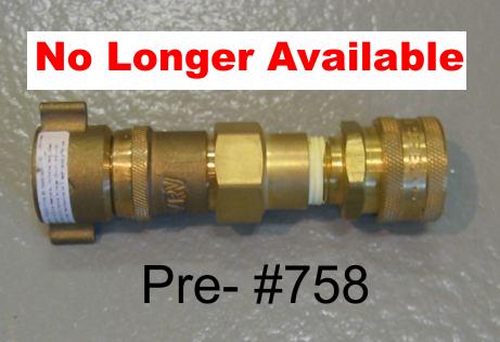

I assume you are talking about the connector for using city water? Looks like this:
Camp-Inn sells them so you could call them and see if they can 2-day one to you if you need it right away. Mine is in the trailer that I can't get to anytime soon to measure. If you look at the camp-inn website, they must have changed the fitting at build number 758 so you would need to know your build number when ordering.
You should note that this is more than just a coupling - the left most piece is a pressure regulator to prevent damage to the trailer if the city water pressure is too high. Search for Camco 40055 water regulator. Looks like the middle piece is a garden hose to 3/4" (?) npt thread fitting and then the quick connect fitting that I don't know the size of but you should be able to source locally or Amazon.
You would be risking damaging the trailer water system if you don't use the regulator. The e-trailer site also has some info on these and sells them.
If you are not talking about the city water connection, then ignore all of this.

Hey Henry, yes that’s exactly what I’m talking about. I already had an extra 40-50psi water regulator so I thought I would buy the quick disconnect for it because in heading out in a couple of days. If I can’t find it I may have Cary expedite one to me. Just trying to use what I already had laying around. Thanks!

Two parts make this up. A camco pressure regulator which you can get for about $10 at Home Depot and a quick disconnect...
the parts camp inn uses should be compatible. I’ve used these in the past for non campinn coaches...the big difference is the disconnect campinn uses is of higher quality. But in a pinch, the off the shelf stuff will work.

Hey Sweeney, thanks for the info. I ordered a quick disconnect set for common 3/4 hose but it is too small to connect to TD male connector so the one camp inn uses is larger coupler , maybe for pressure washer equipment... my 560 is #479. I’m assuming you are stating the coupler you show from Home Depot fits your camper but it’s important to note that when you order an assembly from CI, they ask which # you have so male water connector may be different depending your year of build. Thanks for the great info.
Mine was a 2012 -- but I dont think things have changed (I'm STRONGLY considering buying a 2021) back then, the fittings were all compatible with the metalic fittings in the garden center. I THINK it was rainbird that Lowes sold at the time. The preasure reducer is standard hose fitting, so no problem there.
What CampInn uses is fittings used in commercial hydraulics -- parker (?) -- not the cheap chinese crap. Its the expensive Chinese crap.
