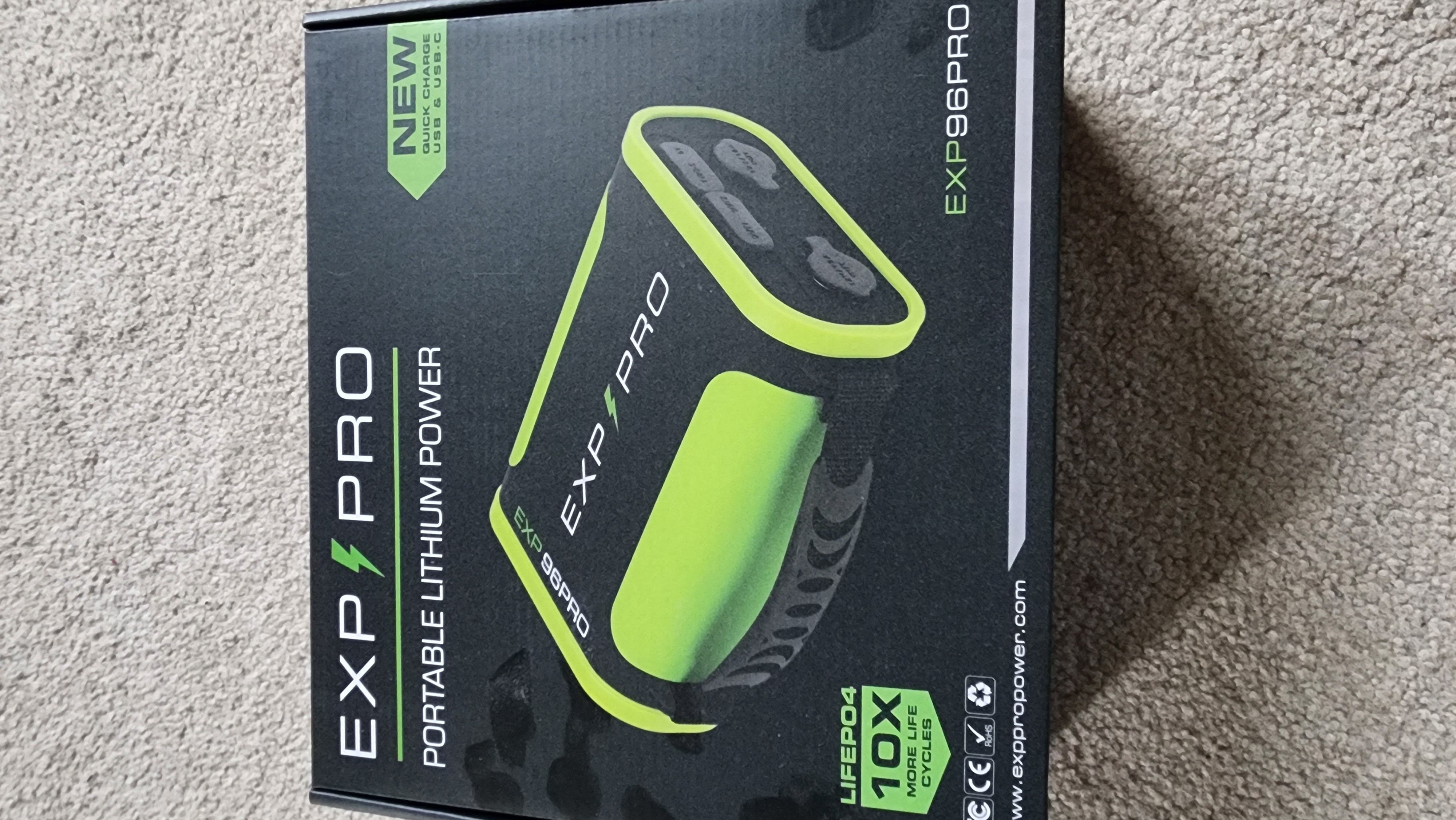

Holly Bee, I purchased a battery last year specially made for CPAP machines. It is called the EXP96PRO. It is a lithium ion battery, approximately 307wh and I typically get 4 plus nights with it not using humidity. It is light weight and fits nicely in the headside cabinetView attachment 1000018634.jpg

Thank you for this idea. Have you ever compared it when using it with humidity to see what the difference is?
I have not, my guess would be one plus days.
All my experiments showed similar results as Glenn guesses. My current practice is to put a splash of distilled water in the humidifier chamber but leave it turned off, sometimes called “passover” humidifying. It’s not much but it helps.
