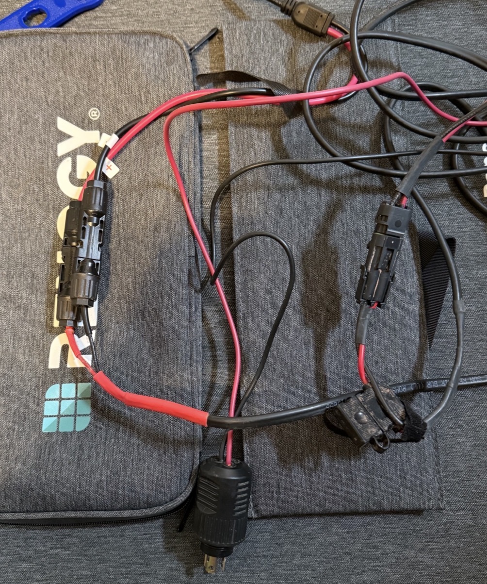

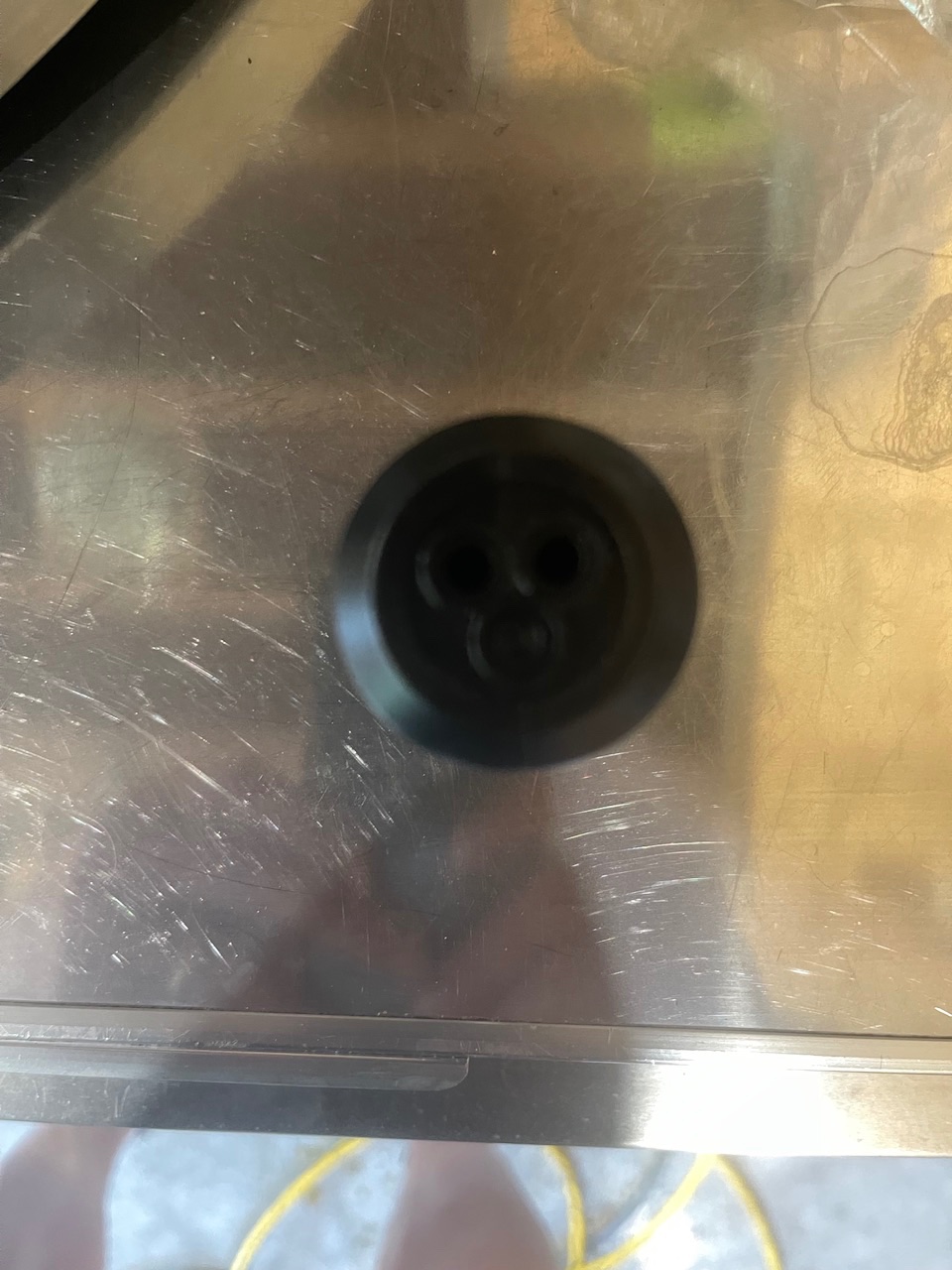

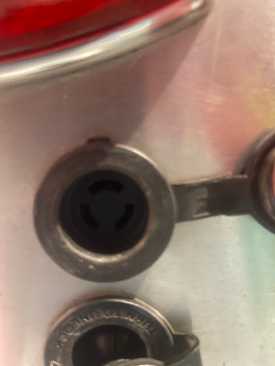

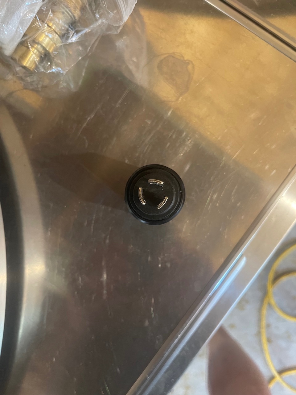

I was trying to connect the Renogy to the 3 prong solar input which was getting to the solar terminal on the CTEK. To measure the voltage I had the panel in the sun at around 30 watts, had someone plug in the 3 prong on the outside then measured the voltage on the solar to ground terminal on the CTEK.
It’s essential to bypass the Renogy controller electronics (if any) for that setup. It’s the raw panel output that should go to the CTEK solar inputs. Otherwise there will be two controller/chargers in line. If that’s occurring it could account for low or no battery charging.
My 100w Renogy is their Solar Suitcase model, with controller. It’s easy to unplug the panels from Renogy’s controller and connect them directly to my CI solar input connector.

Just to confirm, the model panel I have is RPP100EF-SE which just has an output for usba/c and the two pigtails that eventually go to the 3 prong plug. Does not look like it has a controller.
