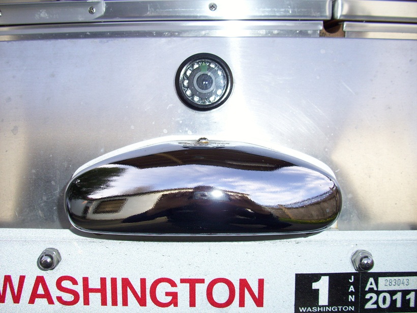

    Here are a few photos of the backup camera that I had installed in my trailer. I figured it if saved my even once from backing into something it would be well worth it.
    Even though I try to have my wife assist me while backing up, it has still turned out to be very useful so far.
    I had the camera shipped to Cary very early on in my build and let him decide where it could best be mounted.

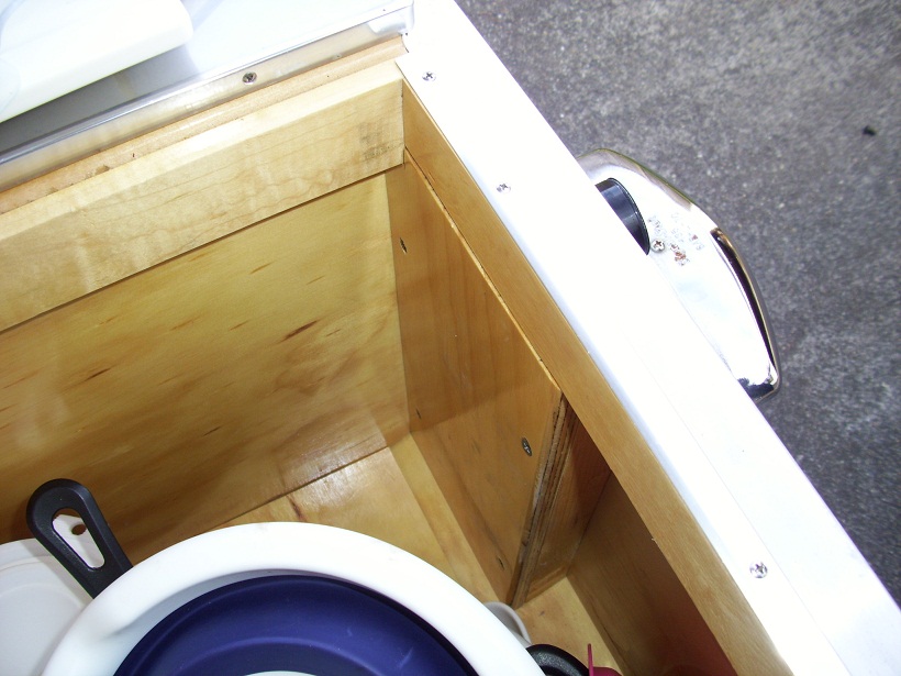

    You can see that the cupboard lost a little bit of space to give the camera room. Hardly anything that you would miss though.

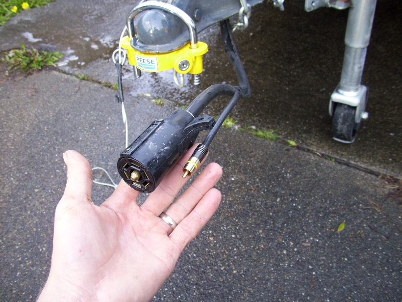

    Craig or Cary found a local supplier who provided the military grade external RCA cable and jack for the video signal.

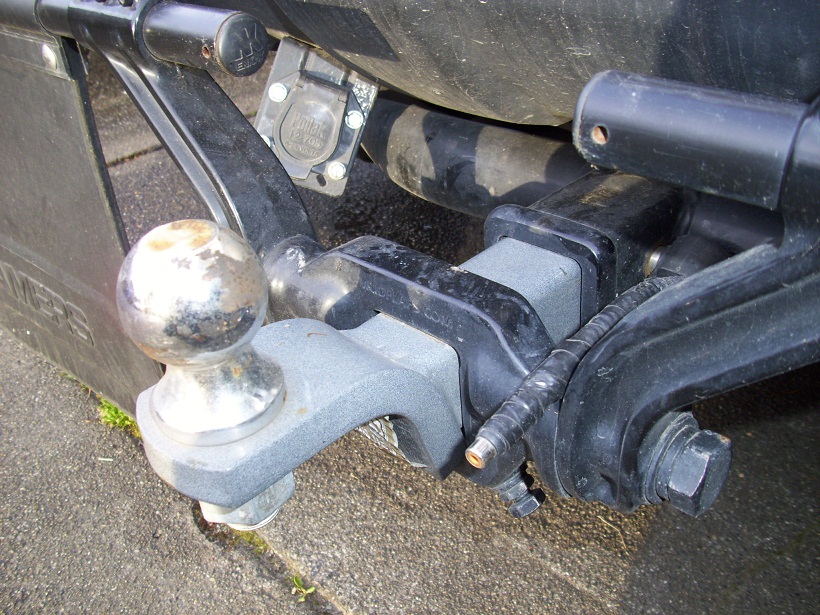

    I wasn't so lucky when I had the other end of the cable added to my tow vehicle by Car Toys - their job is several steps below military grade (note the electrical tape). My Honda CR-V had a factory nav system with back-up cam already, and the Car Toys installer split the back-up cam input and added a switch near the console to select between cameras. However, he neglected to test it when he was done, so when I did a month later there was no video signal from the new jack. I went back to Car Toys and found that the installer had moved to a new city, and nobody else wanted to touch the job. It took a bit of persuading and sleuthing to track down the original installer for help, and then force the local guys to follow his instructions to correct the problem.

    With the built-in Honda camera, I can see my hitch and so can hookup to the trailer by myself. Once hooked up, I can flip the camera switch and see behind the trailer.

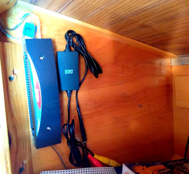

    Our TD doesn't have the back-up light option, so I installed the back up camera on the license plate holder, and tapped into the taillight circuit. The downside is that both the camera and wi-fi transmitter are powered up whenever the lights are on. The upside is, if you want, you can watch what's behind you while driving by just turning your running lights on (you don't need to go into reverse to activate the camera).
    Another downside of using the wireless wi-fi type system is, there is a small lag time from the camera to your phones app that you use as the monitor, so you need to back up slowly, and/or stop to let the monitor catch up with the camera.

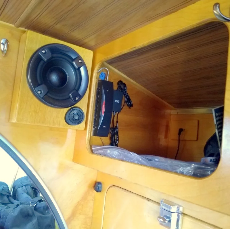

    I ran a power wire for the wi-fi transmitter up into the curb side upper cubby using the same CI wire route in the right upper side of the galley under the hatch. With the transmitter high up in the cabin there isn't much to interfere with the wi-fi signal being transmitted through the front TD windows through the rear TV window to your phone, and it's protected from the elements.

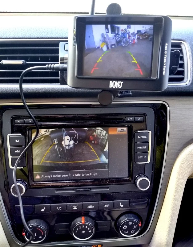

    **Update on 05/27/19** I went out to the hangar to start getting the TD ready for summer shortly after my earlier post. I hooked up the TV to the TD and checked all the lights etc. as well as the rear view camera, which I found to not be working. After checking connections, and trying to uninstall, and reinstall the app on my phone, and re-pairing to the wi-fi module, I still had no picture, just a black screen. I decided to try replacing the wi-fi module with a wireless transmitter and dedicated monitor: Amazon.com: Boyo VTX3600 3.6-Inch Wireless Monitor and Transmit: Car Electronics. (found on eBay for a little less).
    It arrived last Friday, so I went out and was able to just replace the wi-fi transmitter with the new (non wi-fi / blue tooth ) transmitter, which had the monitor already paired to the transmitter from the factory. The monitor is small enough to store in the TV console, and just take out and plug into cigarette style power socket when needed. It was about a 10 minute exchange using the wires already coming from the existing camera, and worked nicely immediately on power up. That was a relief, since replacing the camera would have been a little more work, but I was prepared to that too if necessary, since the back-up view is definitely worth having. The monitor comes with a suction cup mount, but I found it fit in my cell phone mount nicely ifI turn the mount sideways : Amazon.com: Harvardbasic Updated Cell Phone Holder for Car, Universal Smartphone Car Air Vent Mount Holder: Cell Phones & Accessories so will use that instead.

    Took a few pics today to show others what the new camera monitor looks like in use. IMG_20190528_153544387_HDR.jpg IMG_20190528_153523409.jpg
