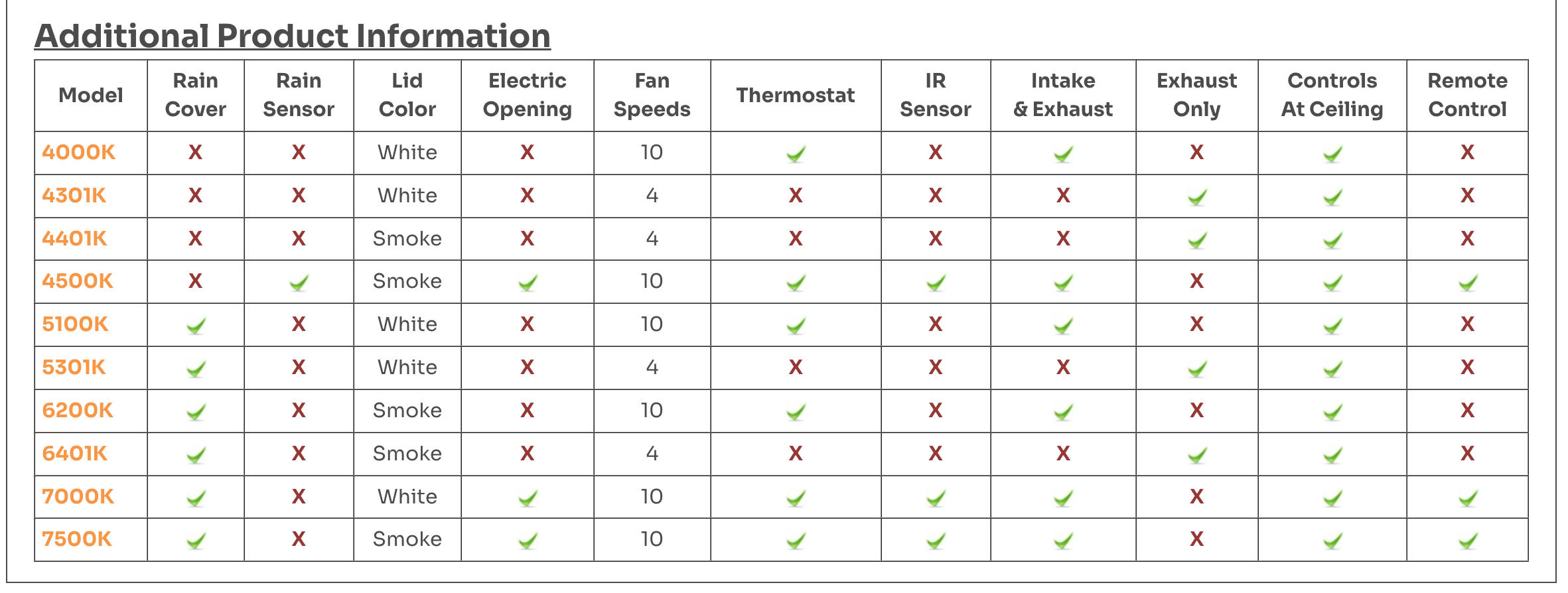

  1. Thanks much Sweeney. I just emailed Cary for his take on things. Asking him pretty much everything that you just touched on. Except I needed to get from him the wisdom of obtaining the "extended" version and any undue torque on the lift mechanism (since they possibly only install the 4500 version, and possibly for that very reason, if they do), and if they had experienced any voltage limitations/circuit board BBQs with any of their installs in the past.
    So, then... the extended versions (6200, 7500) essentially rainproof only when stationary? And even then, I suppose, there can be some splash-back up and into the fan during a heavy rain?

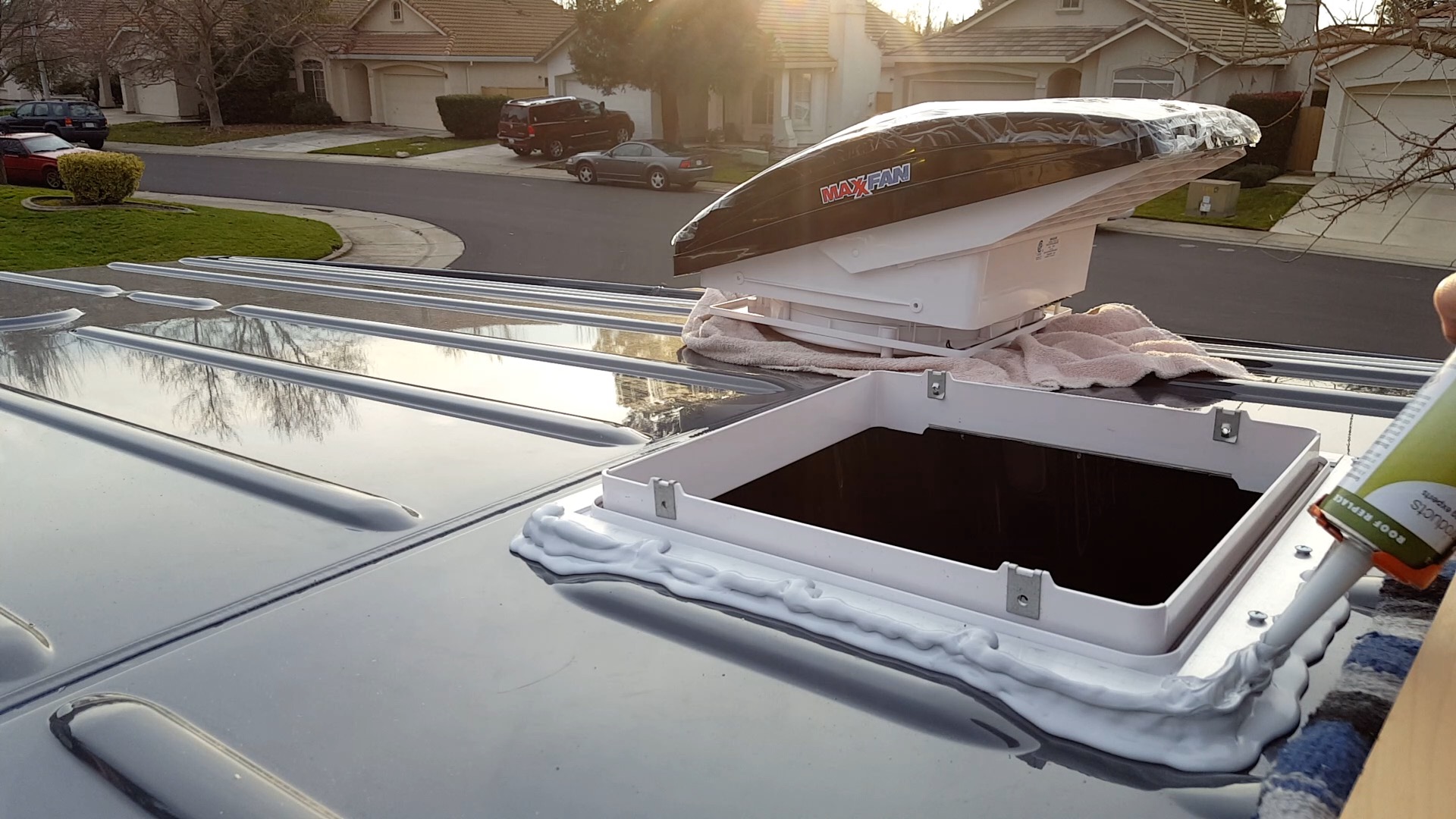

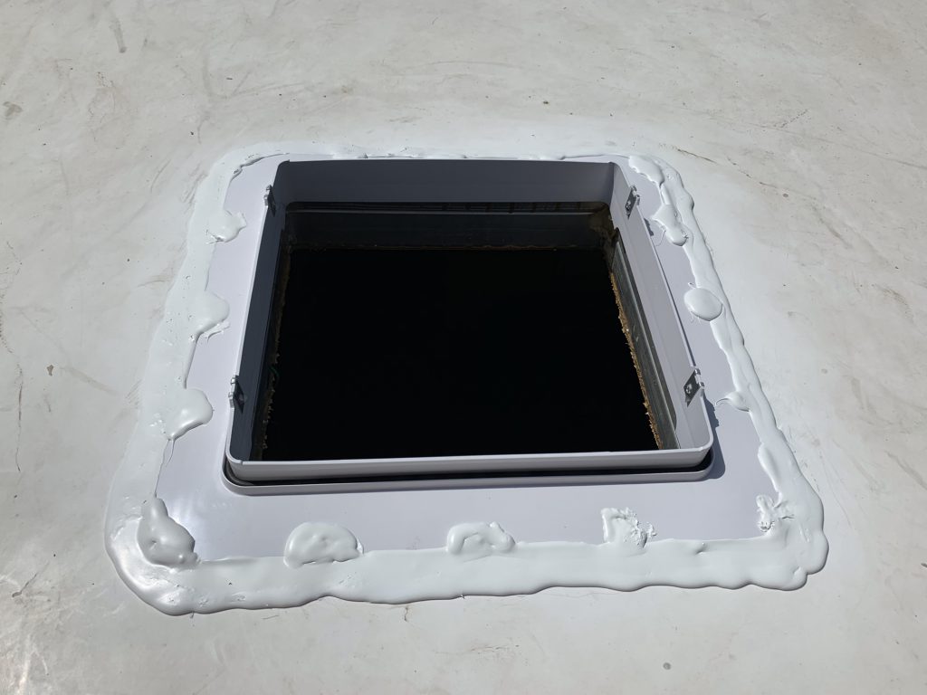

    What butyl thickness is best if just using that? Maxxair is silent on that one. And if going belt and suspenders with the Dicor, can you/do you/must you go thinner?
    I'm also somewhat concerned about neatness up there. (it's not exactly an 8 foot high Sprinter installation that no one will ever see). Can any over-zealousness on my part with the Dicor, or natural run-out/squeeze-out be easily tidied up? I've never used it. I'm guessing that exterior-grade clear silicone is not advisable if Dicor is what you are recommending.

    The butyl tape comes in one thickness that I'e seen...probably 1/8 inch thick. I got mine on Amazon. 4 sides, 18 inches each...so get an 80 inch roll and you'll be fine. I used this.
    This is just like a gasket material that has the texture of a soft putty. Once its on, its on forever, it will get into the cracks and is basically impossible to remove just because its so pliable and sticky. Its really good stuff, and you can find resources online about its use. Its nothing to be scared of.
    I just put a dab of dicore on the heads of the screws and a small bead of it on the perimeter of the fan where the fan met the roof. I just ran a 'fat bead' around the perimeter and then a dollop on top of each screw head. Leveled out and it doesn't look terrible. When it needs refreshed a putty knife and some mineral spirits will remove the residue.
    All of these sealents are thick, icky, nasty, difficult to remove, flexible non porous. Theres a ton of youtube on the subjects...If you can put in the shunt, this is easy.
