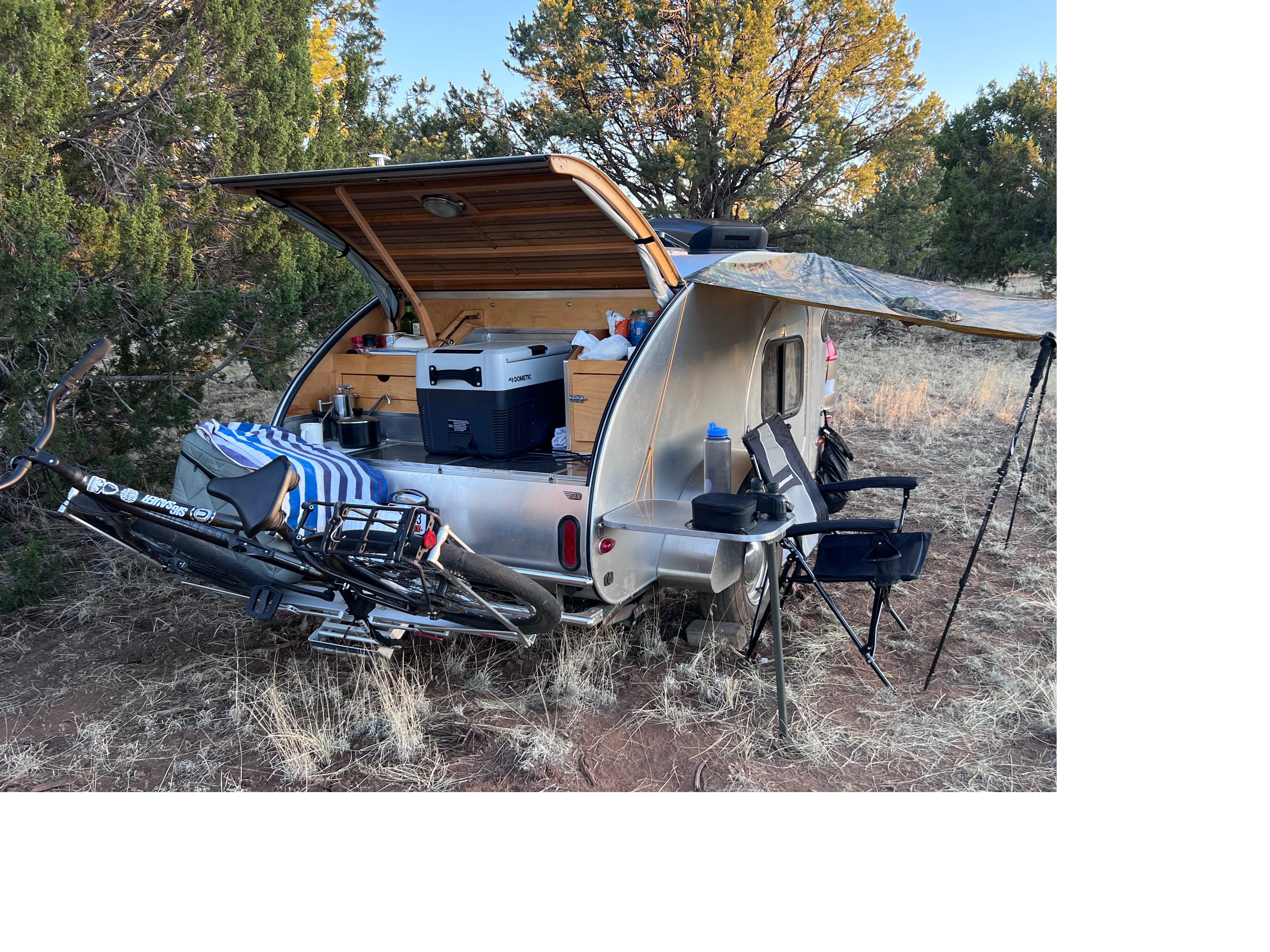

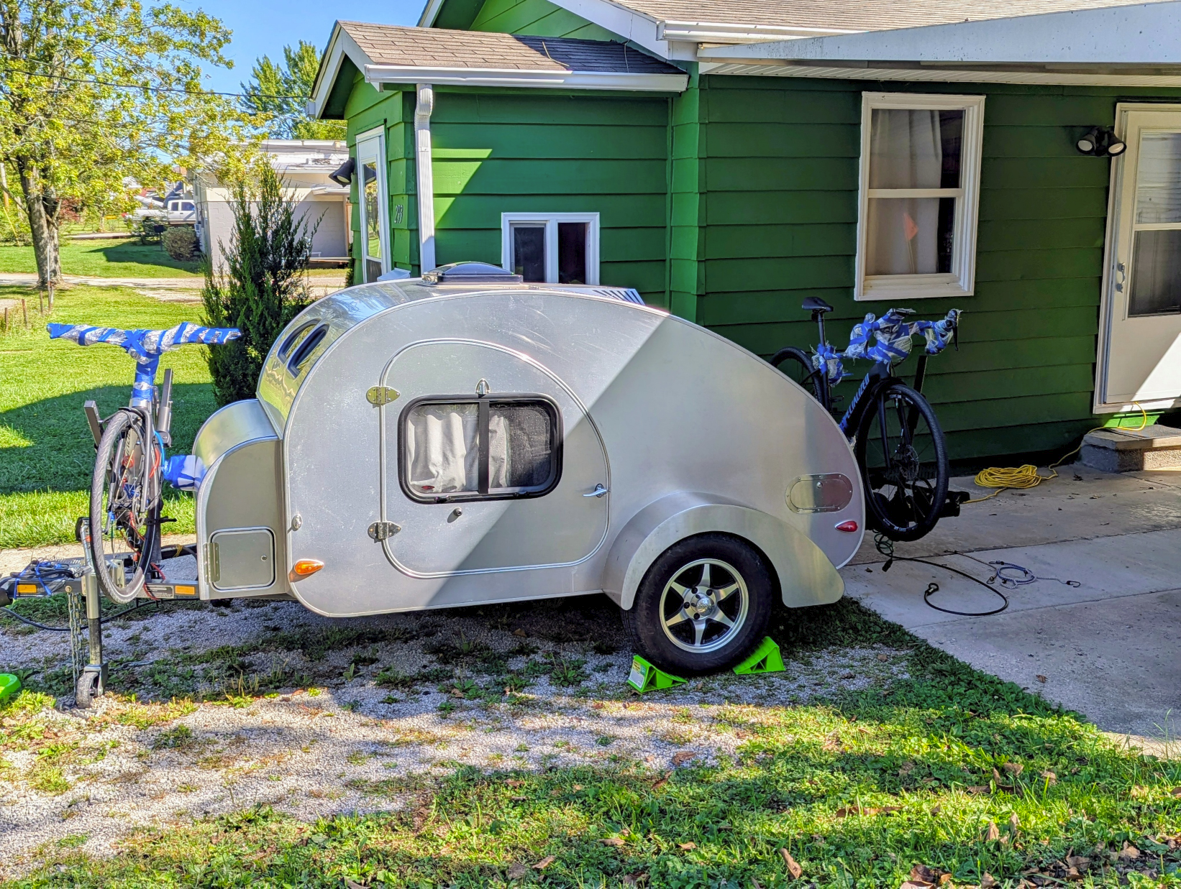

I have a 1UP and have carried one 55 lb ebike on it with no problem. I've also tried folding it down once. Still way too much trouble trying to get in/out of the galley without busting your shins or other parts of the upper body trying to maneuver around the bike and rack.
When I get to camp the bike and rack comes off and the bike gets locked to a tree, picnic bench, bear box or whatever, for the duration of the stay. Much simpler and easier.

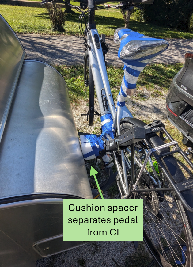

1) Our bikes-only trip (without TD) was covered admirably by the 1.25" Kuat NV 2.0. The rack is expensive but performs admirably.
2) We are about to embark on a trip with both TD and bikes, for which the above rack won't work. We will use a Kuat Transfer 2.0 with a 2" hitch. It is rated for use on travel trailers, but with a reduced capacity (40# per bike, down from 60# when attached directly to the main vehicle). This configuration meets all weight limits on the TD hitch and the rack. The downsides: extra cost, and not being able to shuttle the bikes around when at a campsite.

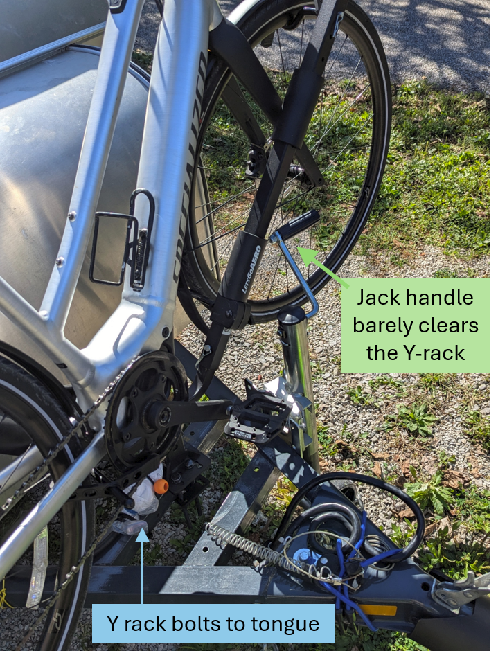

That's what I have gone to with the new truck. I wanted to get the bikes off the back of the TD so we could more easily get into the galley on the road, so I got the dual hitch extension so I could put them between the truck and camper.
The rack we have has the oval loops that the bike tires sit in, that can be adjusted for the length of the bike. I found that the square bar that the ovals are mounted to were coming close to contacting the TD when turning sharp, so I ended up shortening them so that they still had some length adjustment, but took about 6 inches off each end, which was enough to let them clear everything. I was able to take my Lectric bike to Oshkosh using that setup, and it worked well, allowing the tailgate to be dropped (but not the tailgate flexgate step). I was able to carry everything that we used to put into the cabin, into the truck bed instead, making the TD cabin accessible for rest stops en-route if desired, or if pulling into a campsite late in the day.
Here's what I ended up getting : https://www.amazon.com/dp/B081TTNSX4?ref=fed_asin_title&th=1
Unfortunately, I didn't get a pic of it setup on the truck during the trip. One thing of note was that the TD tongue jack handle wasn't usable with the bike in place however.

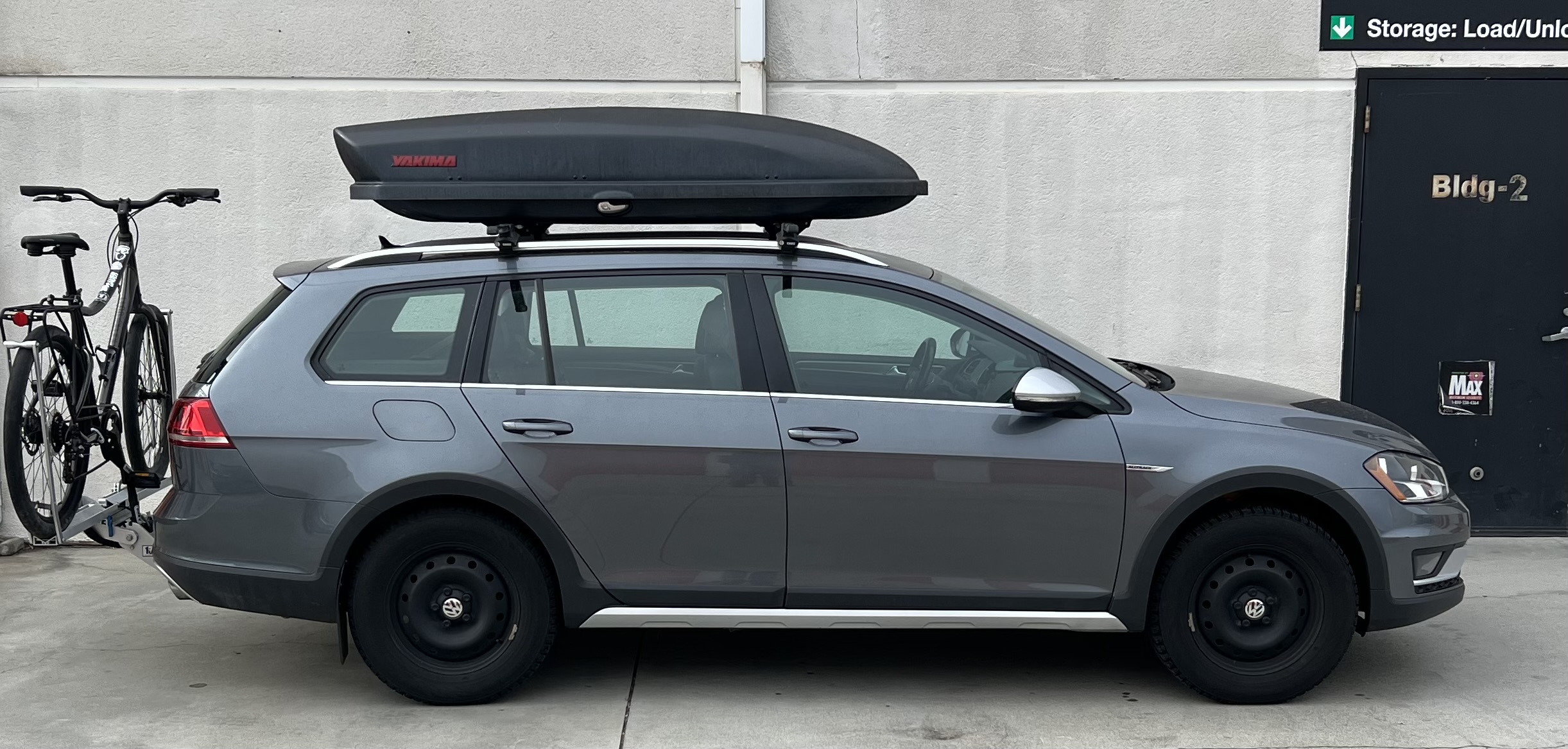

Yep. Thats my limitation too. My VW Alltrack has an Ecohitch 2" on back with a 350# tw limit (3500# gtw)
that I could "maybe" get away with a dual hitch, BUT I tend to be conservative.
The Alltrack is similar to older Subarus so hoisting bikes another foot up into the air over roof costs drag and mpg, and wind wear on the bike.

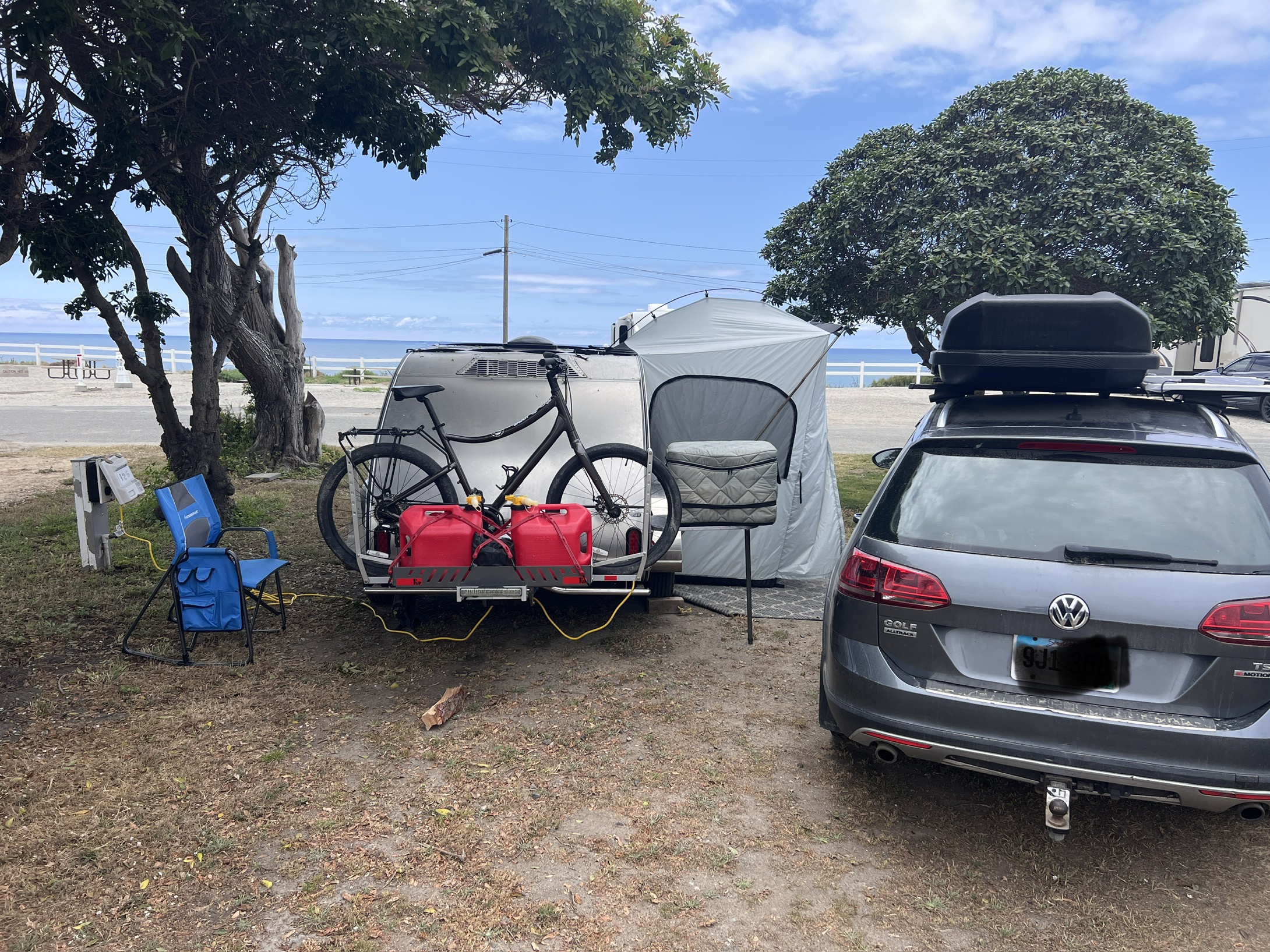

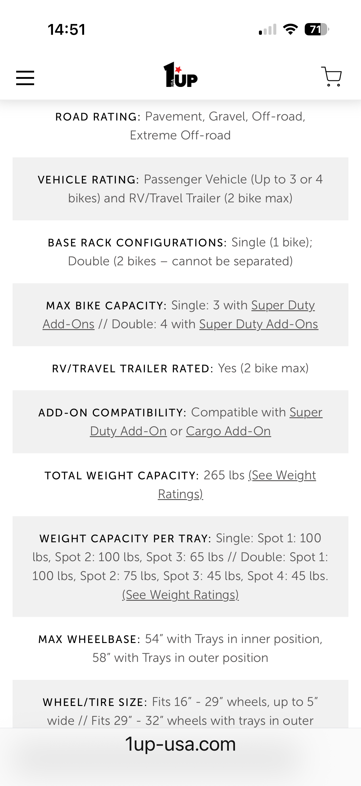

So I'm like @JohnC - my single leg powered commuter bike the rides in back of CI on a 1up, no cover. Thats worked pretty well on a 6000 mile trip, and two lightweight commuters or MTBs are within the CI hitch limits with 1up aluminum rack.
That 1up also worked on a couple shorter trips both on CI or rear of TV down bumpy roads. The 1up can be folded down 45% out of the way to open galley, or to ground, with bike on or off, and folded at 45 bike off makes a handy place to park a cooler, BUT like @JohnC notes its sort of a tight squeeze to slide in to cook, between the CI bumper and the 1up, and easy to bark shins.
Too much of a PITA for more than an overnighter, or parked at a truckstop, wally world...for longer easier access Just simple to pull the 1Up off and stash it on the TV hitch once you get to destination, locked there or to carry bike to the attractions.
