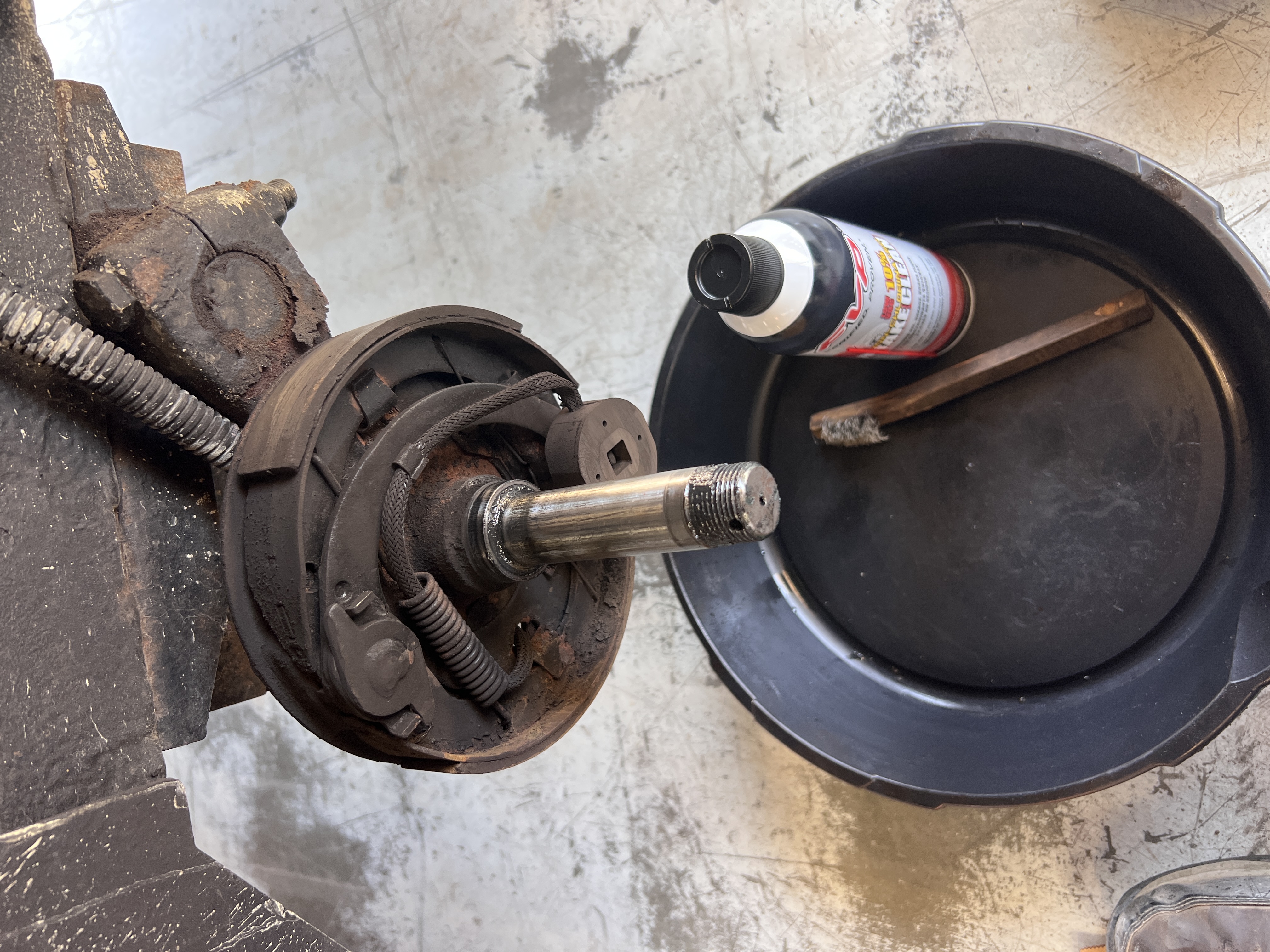

    BTW, based on grinding noise, at same time as smoked bearing, I'm guessing I apparently picked up a possible pebble in brakes between pad and drum, (or possibly under a magnet?) from gravel roads to and in campground.
    Craig suggested backing up slowly and pumping brakes to dislodge and that did the trick!
    Once I pulled off the hub I saw the brakes on the hot side were covered in soot from the smoked bearing. So maybe the grinding wasnt a rock but the bearing itself beginning to bind up...
    After cleaning the hub with brake cleaner and wire brush, and some spray lube on the springs and adjustment screw, and confirming plenty of pad left, magnets still flat and no major scoring or gouges on drum, I left the old brakes on, just to see if that was separate from bearing fail, ie not a brake problem.

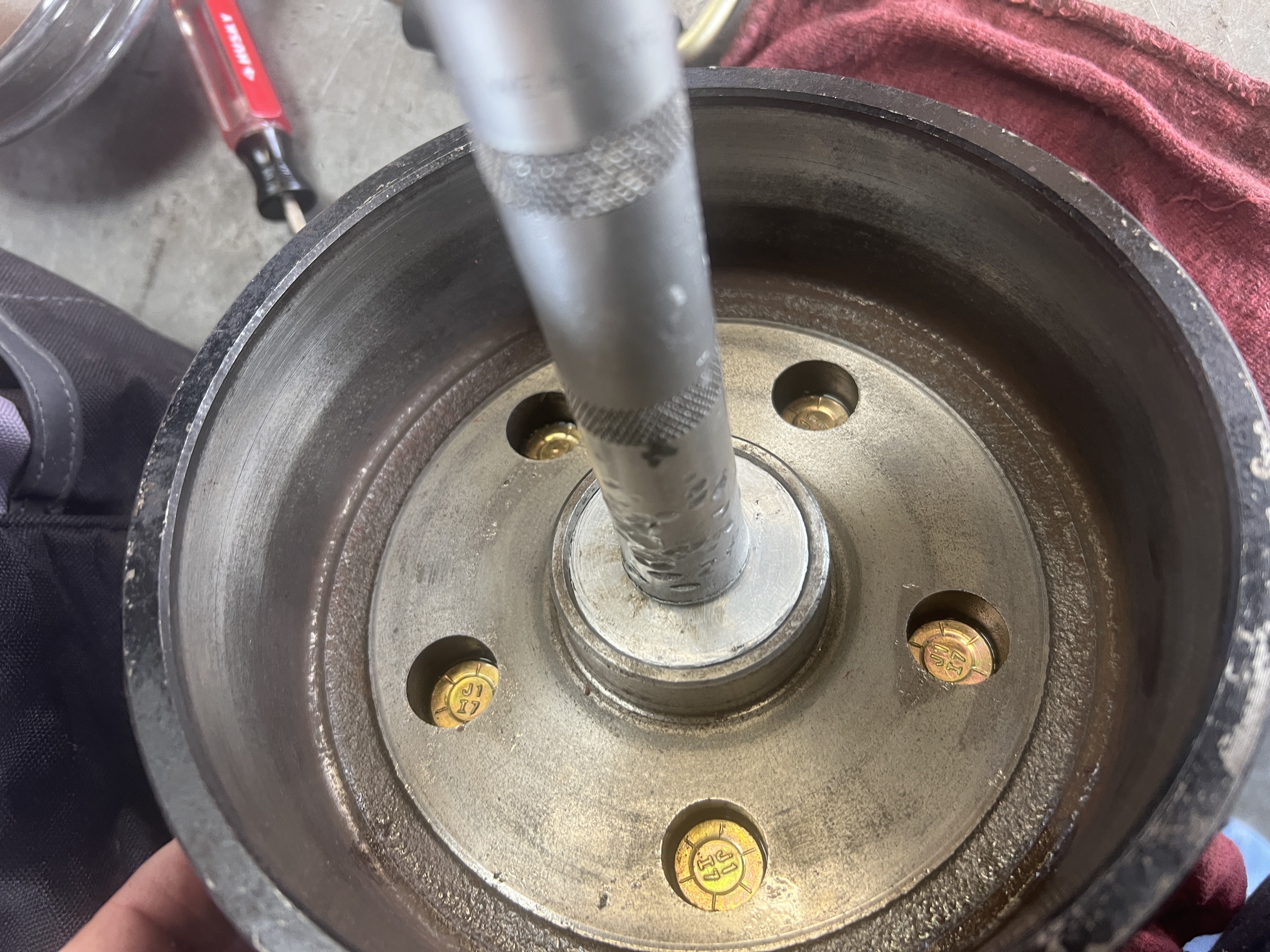

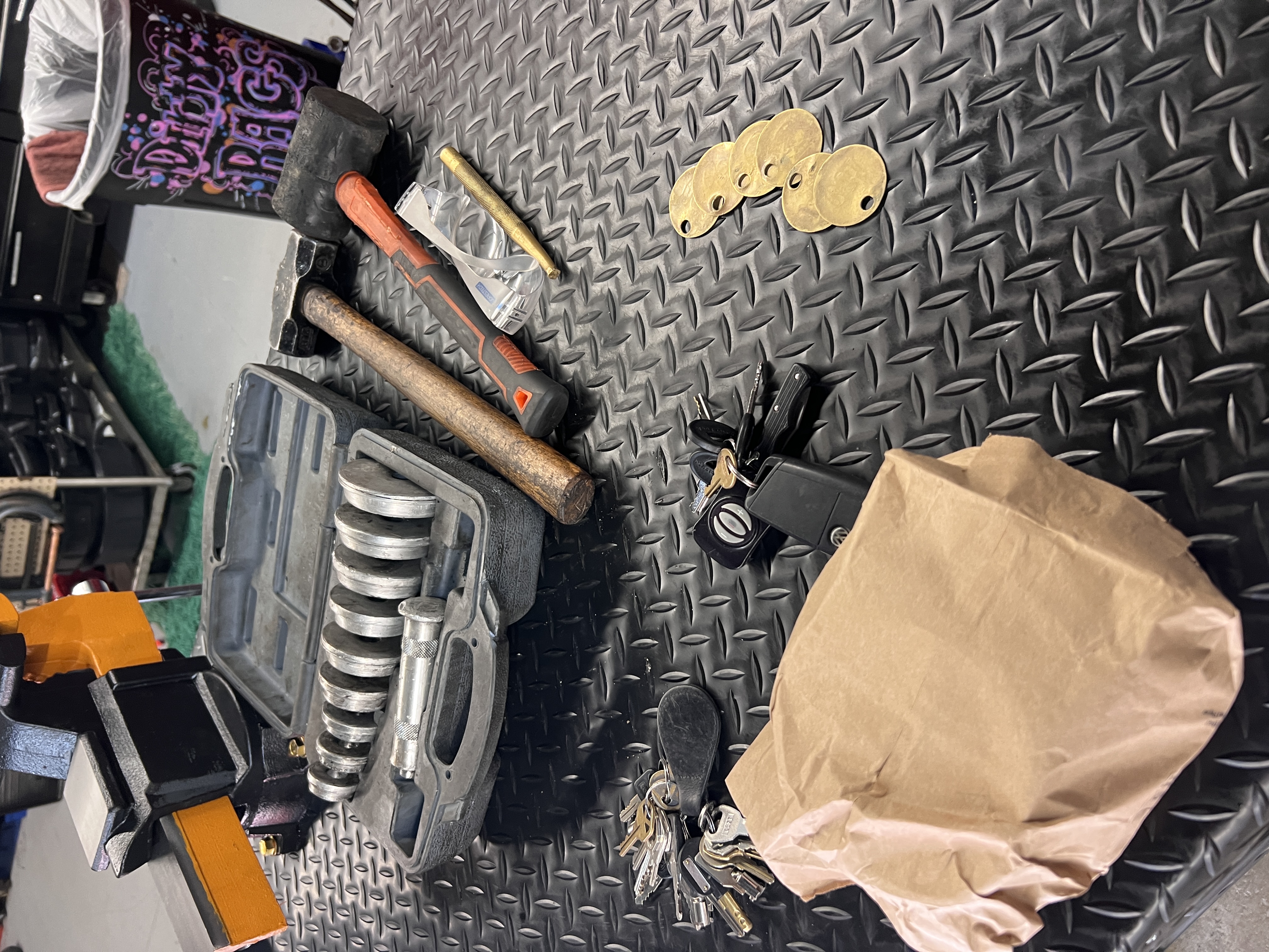

    PS: couple more tips I picked up from watching other youtubes, and a caution by Cary: "be careful when installing new races (what Dexter calls "bearing cups" ) at the same time as new bearings; that you dont scratch the new race by slipppng off the edge onto and scratching the polished surface.
    Its pretty easy to tap OUT the old races using a brass drift punch (adding to my tool box...)
    But the Dexter video doesnt cover how its much trickier tapping IN the new ones with the drift (or a screwdriver)...without slipping.
    Per Cary and my local RV shop owner tip, a much better tool is this:

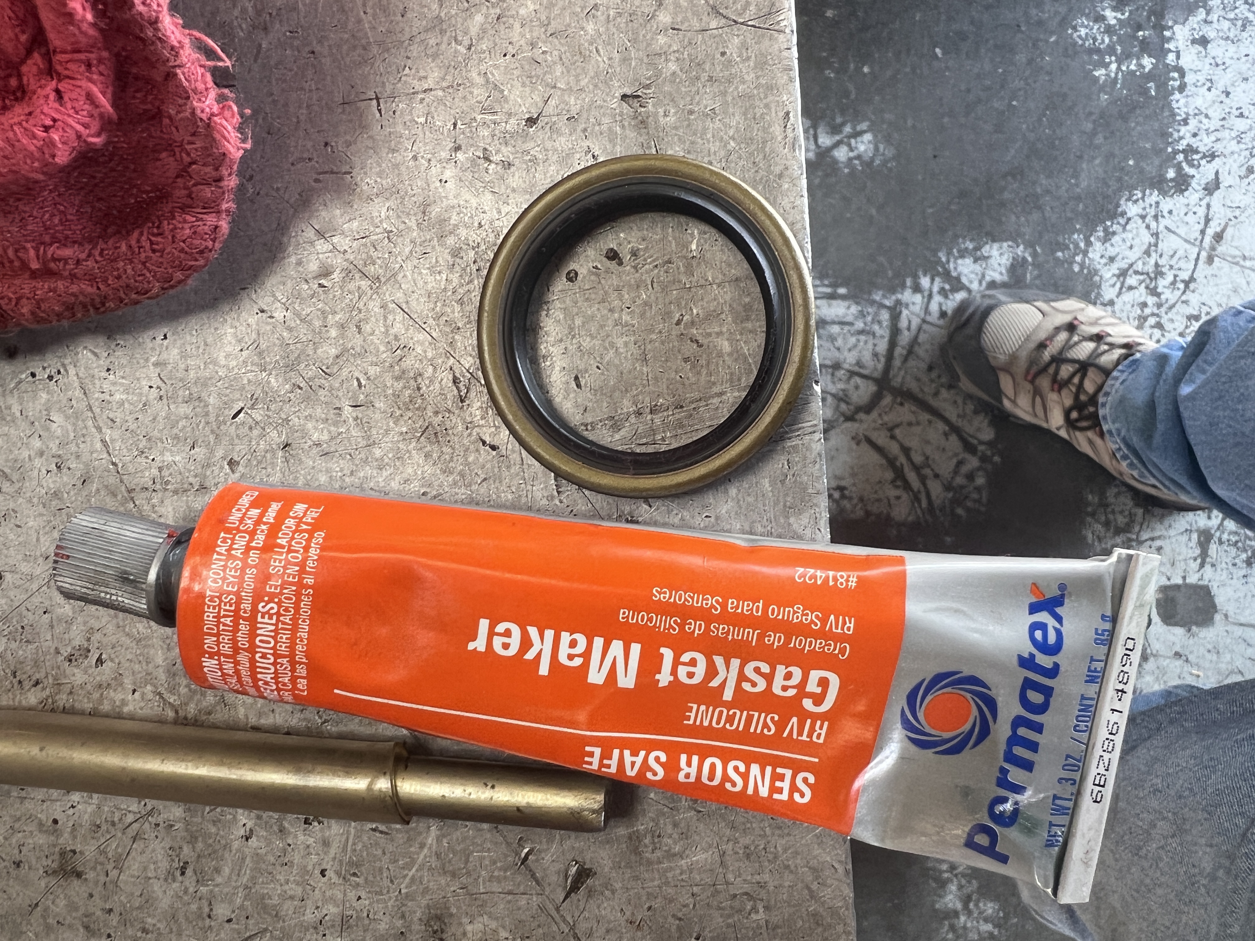

    And do get yourself a 4" piece of 2x4 to tap in the grease seal evenly...the bearing punch tool works but the wood makes it go in more evenly less likely go deform an edge if you get off centered.
    The grease seal double metal lip goes inside, the rubber capped side on outside.
    I used this stuff to seal the grease seals edge per Dexter video.
