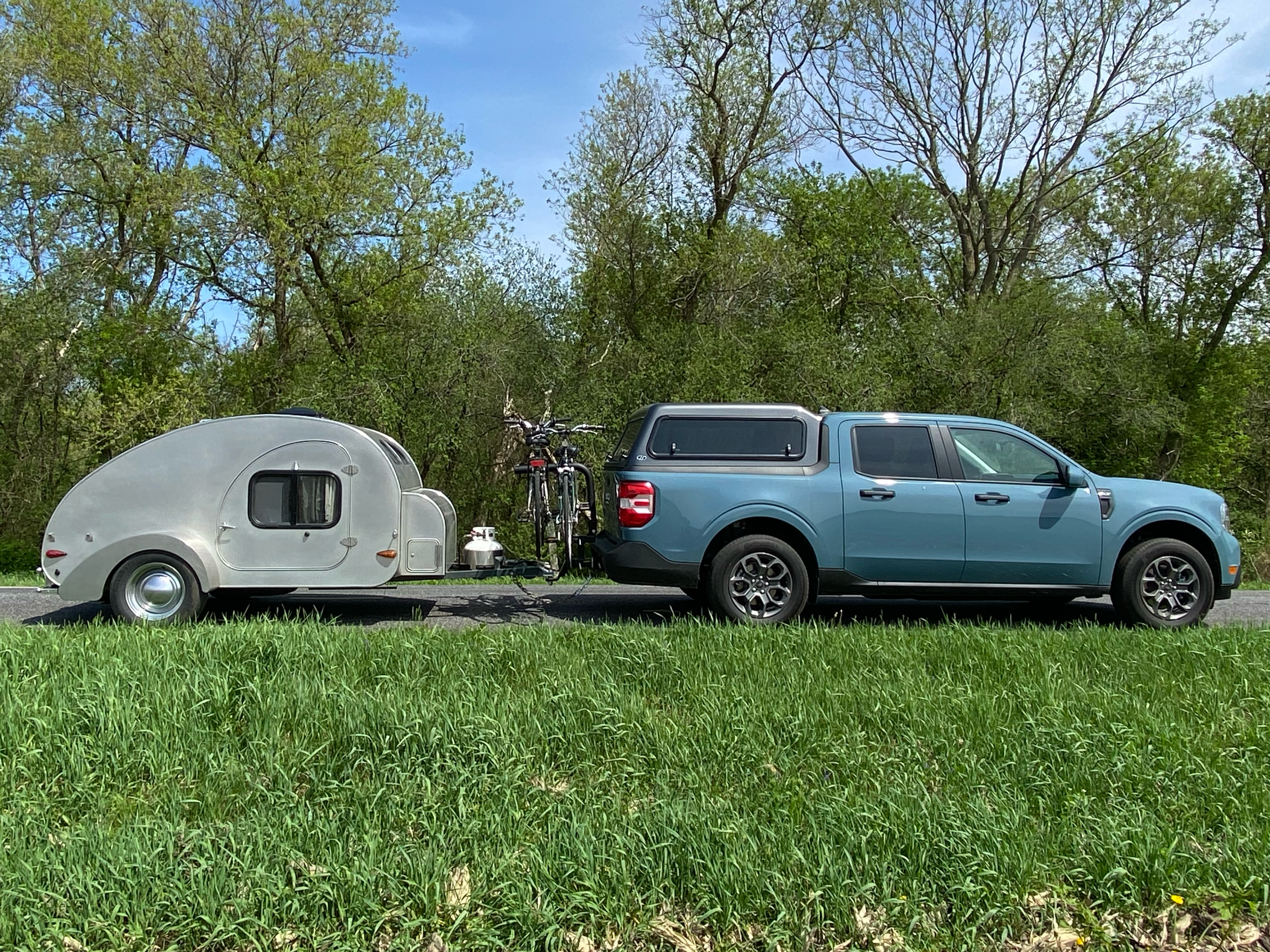

Oooh thats nice!
Cool topper, perfect match to the CI, and a great complement to the truck color.
Looks like easy access from the toppers side opening windows too.

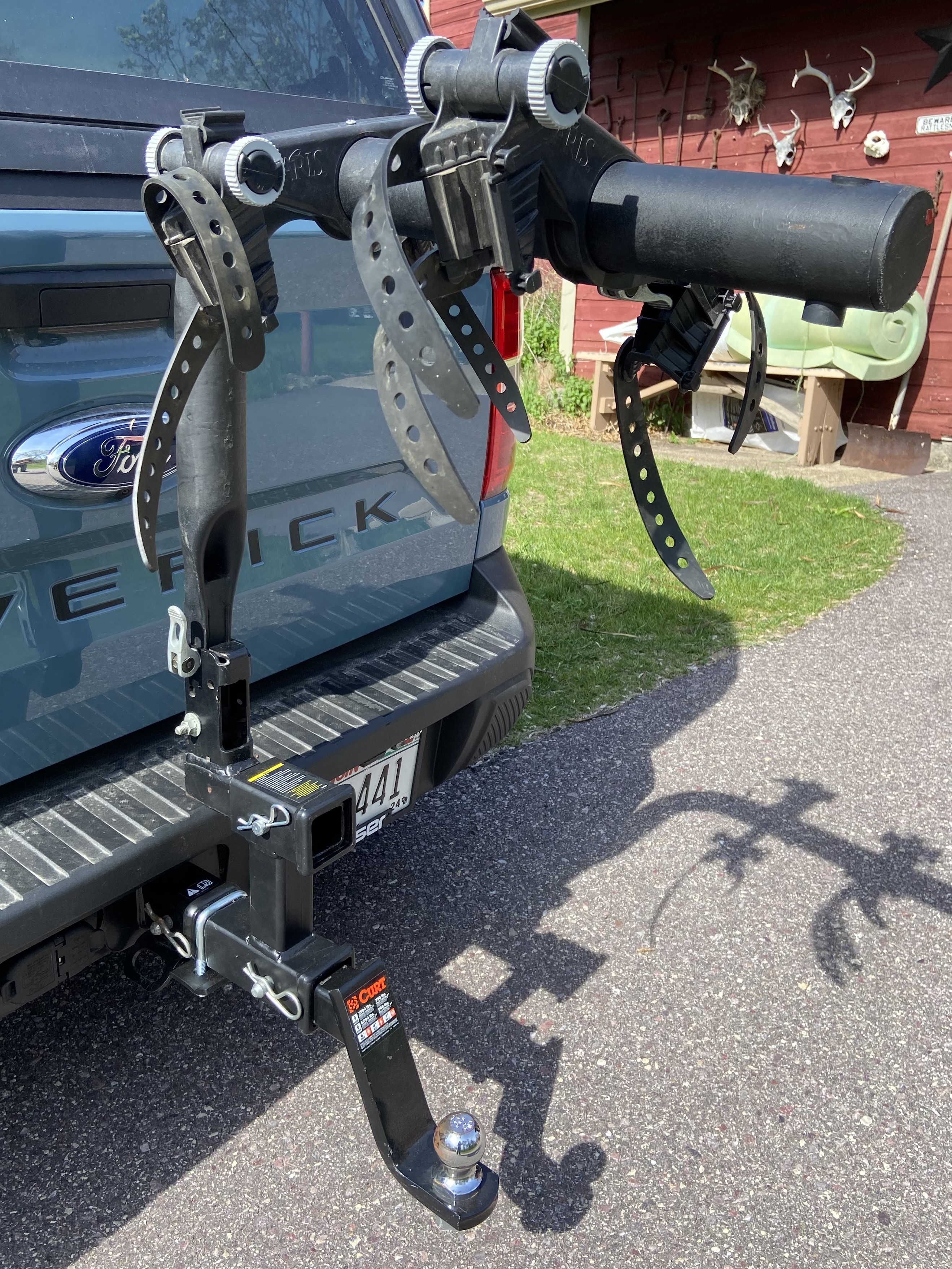

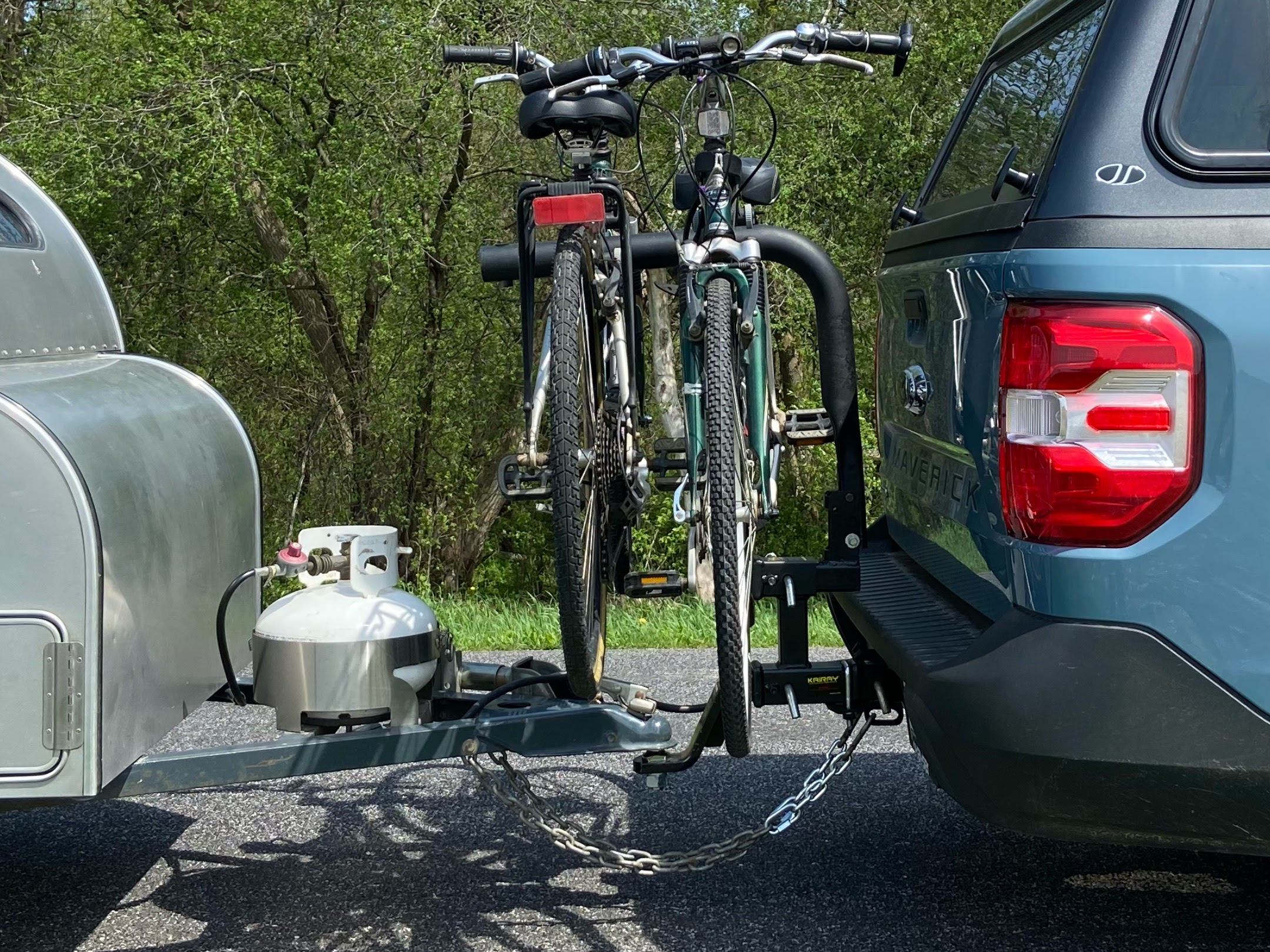

What is that bike rack, and hitch extension?
Best solution yet, IMHO.
I gotta say I really really like the Mavericks and especially interested to hear how the hybrid version of awd holds up in soft roading/"off roading" use in general, and real world mpg towing fully loaded.
Looks like the Maverick rear end suspension holds up with no sag at all, too.
And the price is right, vs full size pickups.
No wonder they are so hard to get!
Please share as you go, as much as you can.
Sure… the bike rack with the double hitch was a two week trial and error process. The double hitch was on Amazon and the Saris bike rack on Craigslist. I picked the KAIRAY double hitch because it was tall enough to clear the bumper and it had an anti-rattle bolt in each receiver.
I had to keep working everything back towards the truck and away from the LP tank.
-I inserted the hitch farther into the truck receiver and drilled a new hole for the hitch pin.
-I was able to install the bike rack backwards to gain more space. (I cut 9” off the that tube and drilled a new hole for that hitch pin too)
-Finally, I cut 10” out of the vertical tube on the bike rack and spun it 180 from original and had it welded.
Sorry for the long answer, but all of this should keep the bikes down below the airflow and improve MPG.
Truck has 2500 miles @ 42 MPG so far. I did take a few 20 mile trial runs pulling the camper at 30+ MPG.
It pulled just fine up some pretty steep grades. Time will tell.

Bike rack pictures below, hope they come through okay:

Ingenious!
