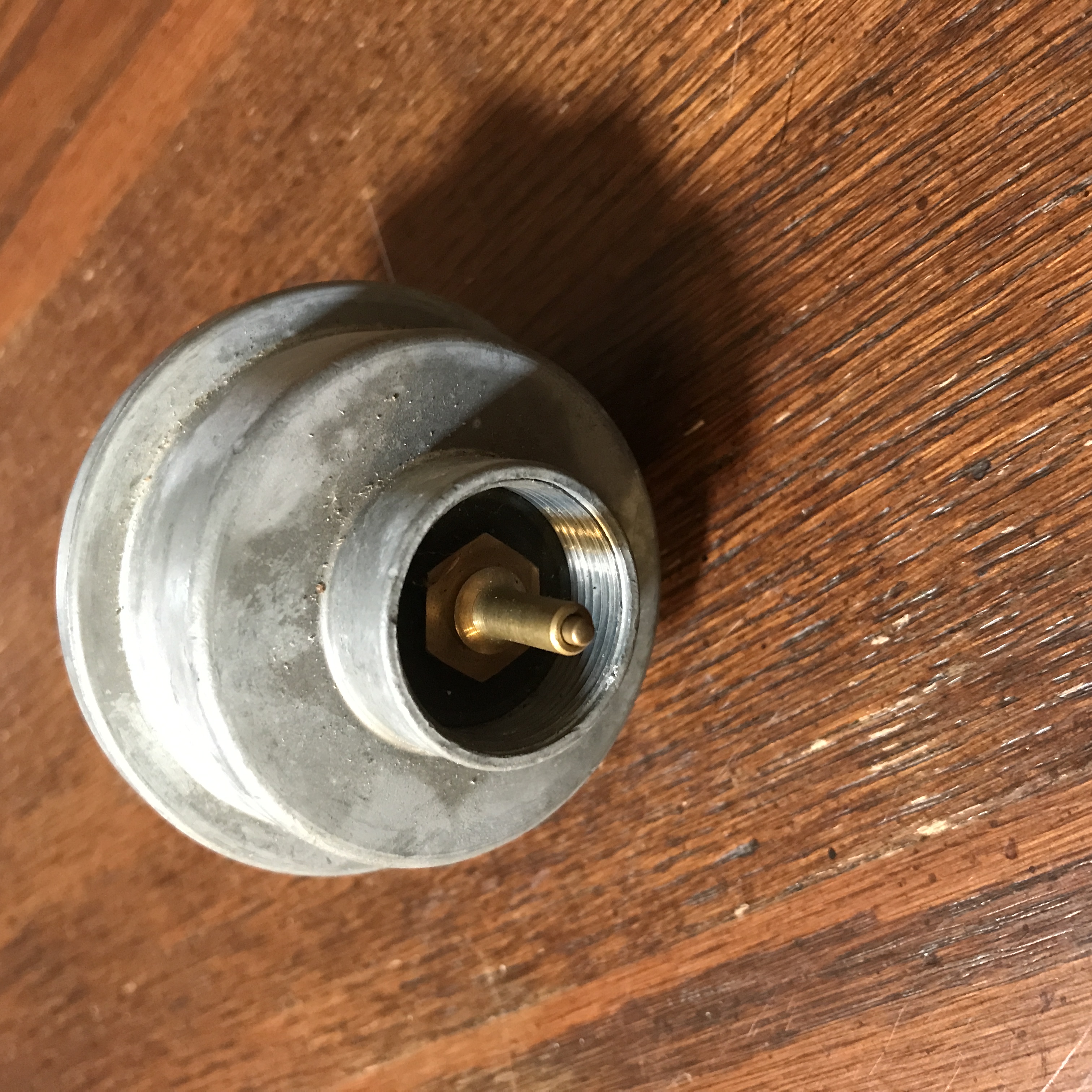

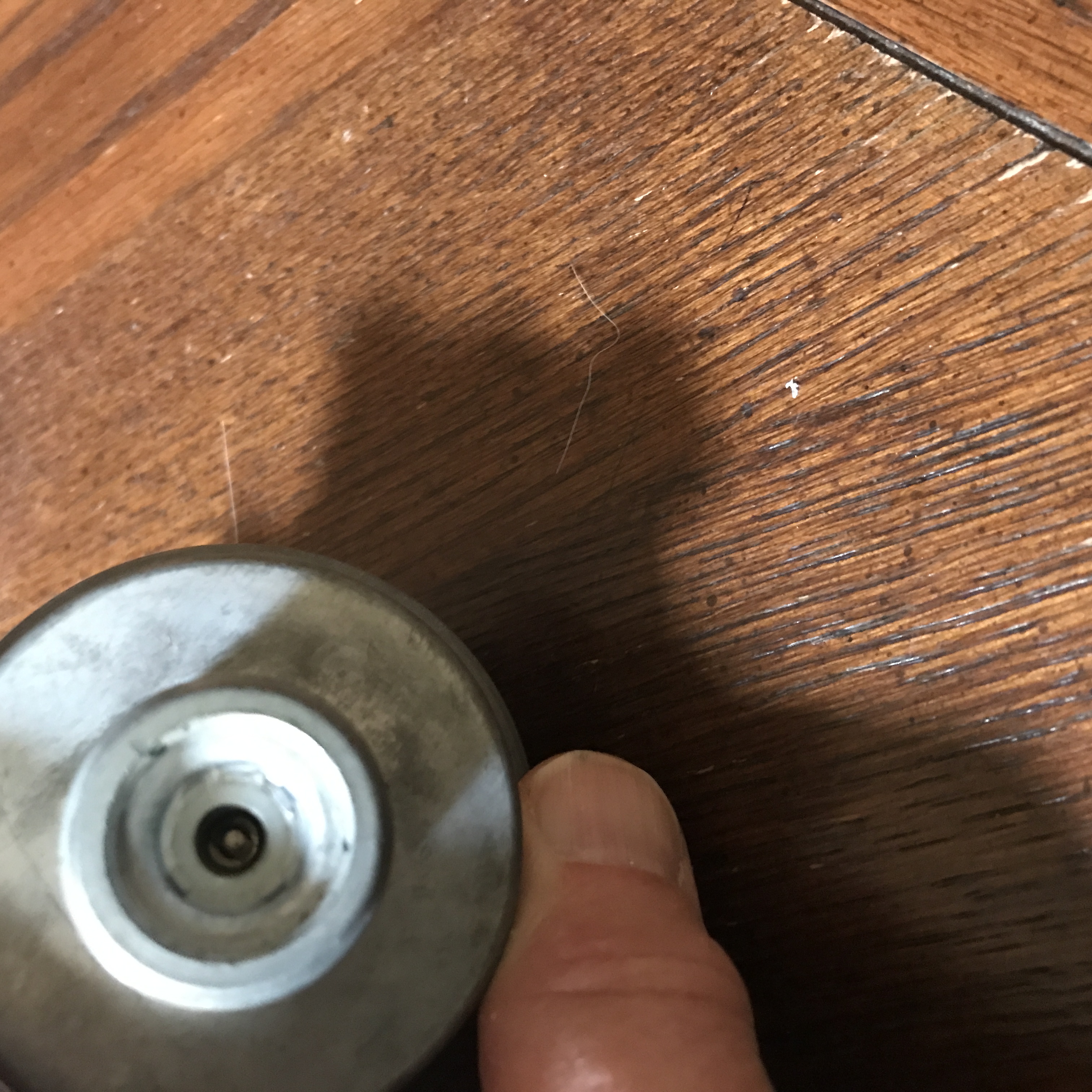

Aha!!! This solves it. Mr Heater has a one way valve of some sort on the fitting. Never seen anything like this before. That explains why the Camp-Inn provided hose is not working then. Because we pull the Schrader valve out of the hoses to make sure they will work with a broad range of gas appliances. But, now Mr Heater just complicated this by adding this feature.
Two solutions. First solution would be to do like Steve did and source a different hose for this. Or have a Schrader valve threaded in to the end of the Camp-Inn hose. That solves the answer for me how I will do it when I get my heater. I will simply spin a Schrader valve into one of our hoses and it will be good to go. I would probably dedicate that hose to the heater because with the valve in, there is a high chance it may not work with other appliances.

I figured someone would want details on this. For the most part the complaints of devices not working with our hoses were very random. Typically BBQ grills and camp stoves. Random but very often. The hose would work for the customer on one appliance and then no gas flow on a different appliance. The evaluation came to be that the devices that did not work had a shorter post in the gas fitting. When you look at a bottle fitting there is the big post in the middle with the gas hole in it. That post pushes up into the end of the bottle and depresses the Schrader valve in the bottle to let gas flow. We were finding appliances that had a slightly shorter post and it would not push the Schrader valve enough.
When that happens there was basically two solutions. One would be to simply remove the Schrader valve from the gas hose. Of course back then we had never seen a gas fitting like Mr Heater uses that has a valve in the end of the post too, weird. The other would be to use a Schrader valve installation tool to thread the Schrader valve outwards a little bit in the hose end to allow the pin to hit the post sooner. Of course then that meant that hose would not work on appliances with a longer post because you would not be able to thread it in enough to seal the post. This post to valve engagement is a pretty critical dimension which we found that manufacturers are unable to stick to. This is why I mentioned before I would likely put a Schrader valve in a 25' Camp-Inn hose and use it with a Buddy heater and dedicate that hose to that appliance, I have to assume it could not work with other appliances.

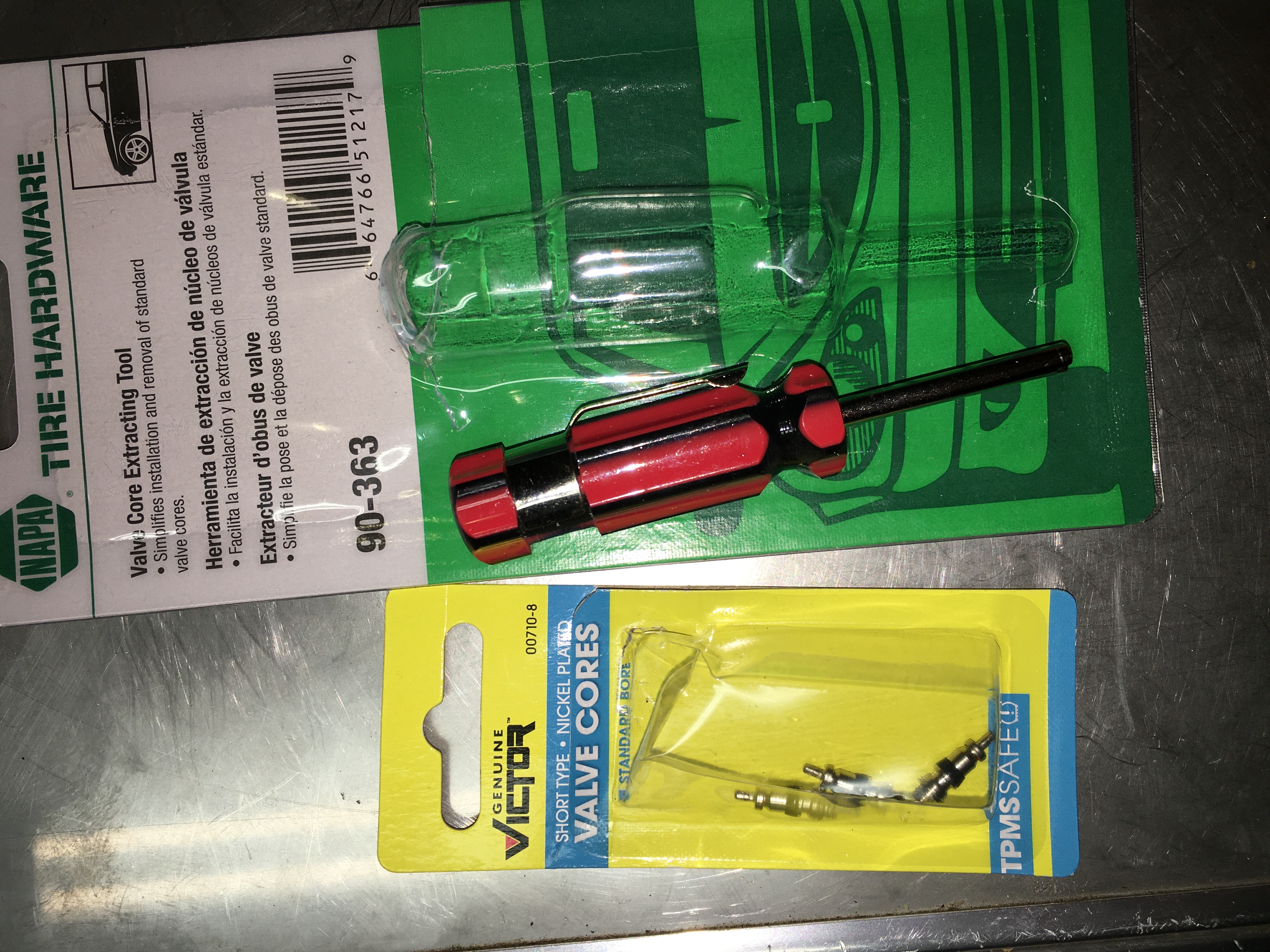

A full week of weather crisis later, including no electrical power, no furnace, snowmaggeddon, icemageddon, etc. and I finally had some time to explore.
Add an auto-parts store schrader valve core to a CI-accessory gas hose “whip” = success to the cylinder port on a Big Buddy.
I had a 4’ and 18’(?) quick connect hoses from CI, bought some valve cores for $2.50, and a small insertion tool $8, and everything worked. So, I added Mr. Heater’s propane fuel filter to clean up any dirty gas.
I think my project is done! And I’ve learned some things about propane distribution :).
Thanks everyone!!!
Notes:
That valve core is way down in the body of the connector. A standard valve-cap tool won’t work, nor will long needle nose pliers. See the photo - I found a tool at NAPA that has the reach and is small enough to go in the trailer toolbox. I’ll carry it for any future camp stove, bbq, etc. that requires no valve.
