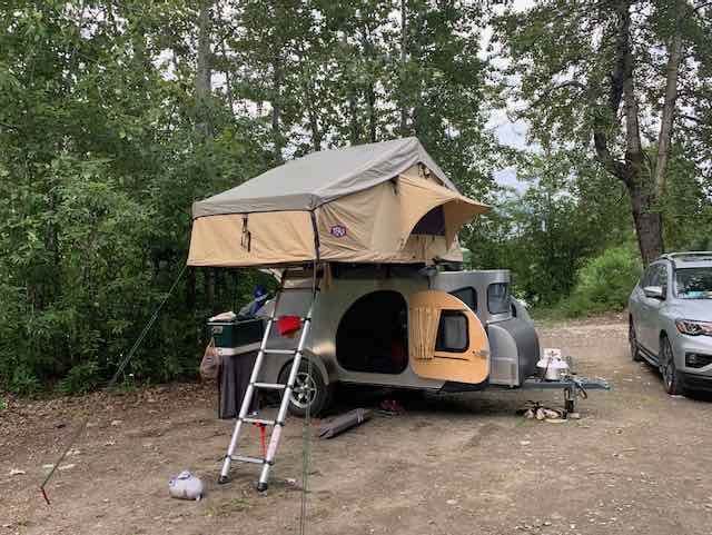

Hello! We got a RTT put on recently (James Baroud Horizon Vision). It's only about 90 lbs. Cary and team installed the roof rack for us and installed the tent and it's all working out very well. They had to put spacers in to lift the roof rack up a bit so the fan on the roof could still open up. More info than you asked for, but thought I'd share. I'm pretty sure Cary said 500 lbs is the suggested max for the top. I am 185 lbs and my son is about 50 lbs and we both sleep up there no problem.
I can corroborate a lot of the info here. Yes, a 560 can handle a roof top tent-in fact, CI even offers a specific tent for sale on their site. We recently purchased a 560 with roof rack factory installed and added a Tepui Autana 3 person roof top tent. We are a family of 5. The two adults sleep in the CI, the 10, 12, and 14 year old kiddos sleep up in the 'treehouse.'

I was advised by CI when we were doing our research that the roof rack option we went with could handle 220 pounds dynamic, and our tent weighs around 150. The static weight limit was advised at 250 pounds. This might seem like we only have 100 pounds of capacity for putting people in the tent-but not so fast. As long as the roof top tent unfolds and is supported with a ladder on the ground (a ladder that bears weight), then the ladder holds roughly half the weight of the tent and the roof rack holds the remaining half of the weight. So really our weight capacity is 500 pounds, provided we meet the very real caveat of using the right style of tent.
The right style of tent means a roof top tent that unfolds to the left or right-if one mounts it to unfold to the rear there would be signifiant interference with the galley hatch. The unfolded half of the tent needs to have a weight-bearing ladder. This means a tent that just 'pops up' without unfolding will be much more limited by the roof rack's weight restriction. The bonus of having a tent unfold to the left or right is that you instantly gain a bit of an awning over one of your side doors.
Be advised that we had a bit of a snafu when installing the roof top tent we selected (this is what happens when the goofy customer goes and purchases a third party accessory that the manufacturer doesn't validate as compatible ahead of time). As someone mentioned above, our tent sits too low on the roof rack to allow the vent fan lid to open enough to run the fan. The incredibly gracious folks at CI immediately owned this as their problem (which is some grade A customer service if you ask me) and took the dimensions down to fabricate some spacers that raise the floor of our tent up about a half an inch. That's all it took, and now the fan opens enough to run properly. Seriously, I'd like to see Forest River match that kind of responsiveness.

I tried uploading a photo here, which I often don't have success with. I can share more images via direct message or another communication platform if you want to see what our setup is.
Hey Dirty6...I think y'all got to CI the week before we did this past summer. Cary said he cut our spacers out at the same time as yours while he was at it. We're lovin' the setup. My wife keeps saying our only regret is not getting a teardrop sooner.
I didn't explain for jbela, but our 560 is a 12-2015 build, so a roof rack can be put on a used one. We were most comfortable having CI install it,so we made a family vacation out of it.
