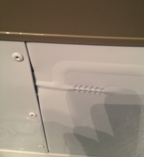

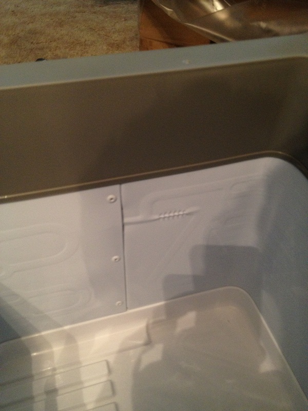

Just unpacked my fridge, but it looks like it has a defect in the inner casing. Does anybody else have this on their fridge?
Evan
Don't panic. It is the thermometer measuring the temp. i did some tests that are out in another post about the temps between where this one is located and temps in various locations within the fridge. Basically top, mid, bottom and on the shelf. Do a search on Dometic.
Evan, mine looks like your first picture. your second picture looks like there might be a gap vertically (maybe a shadow on the pic). Mine does not have a gap.
When I looked at mine initially I thought there might be a thermo regulator attached behind the horizontal mark.
