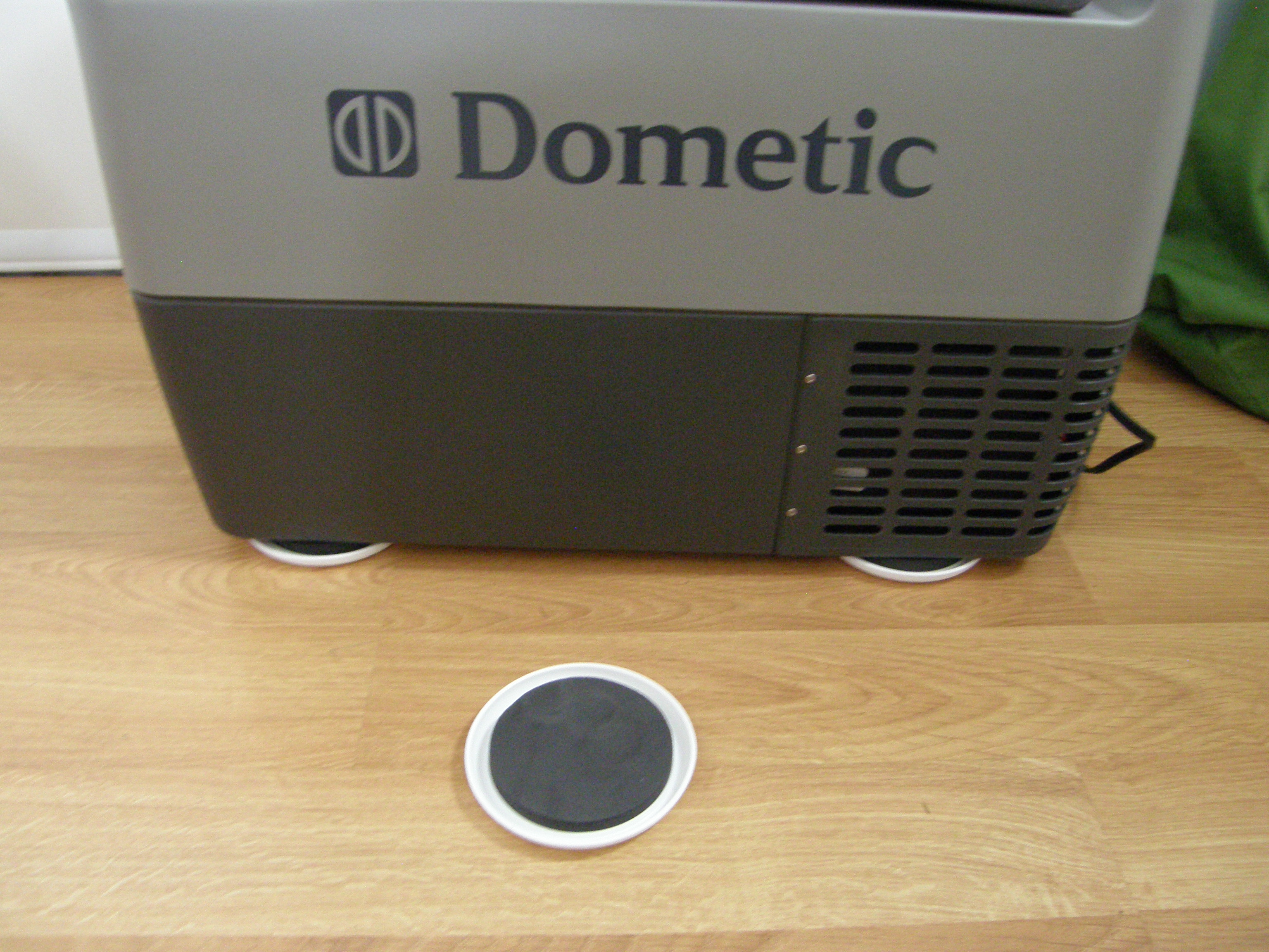

We wanted to try sliders under the dometic instead of having a towel under and over it. Thinking it would give better air flow and not needing to fish for the towel when it falls behind. I had some furniture sliders like (http://www.amazon.com/Waxman-7030-Reusable-Sliders-Oatmeal/dp/B000PB4G04/ref=sr_1_14?ie=UTF8&qid=1343580331&sr=8-14&keywords=furniture+sliders)
so tried 4 of them at the corners. I just set them under the 4 corners. They raise the dometic a little over a 1/4" and slide easily forward and back and reduce the towel clutter. I did not put any adhesive on them so will see if that is needed in the future.
I think they improve the air flow and ease of movement.

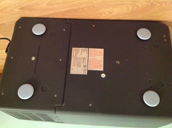

Sliders for the Dometic
With the dometic I found the towel cumbersome. Impeded the air flow and fell behind the cooler, etc.
So first I tried some furniture slides I had at home. They worked but were loose and tended to work their way back under the dometic.
So I bought a pack of 4 Magic Sliders 2” diameter. www.magicsliders.com
These have double face adhesive pads and attach pretty easily. They slide nicely and only raise the dometic about ¼”.
I think these will work well will see next camping season. Our plan is to slide the dometic forward and ease it onto the table by the sink to avoid a lot of lifting.

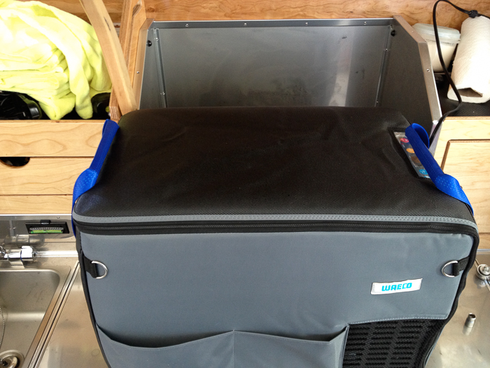

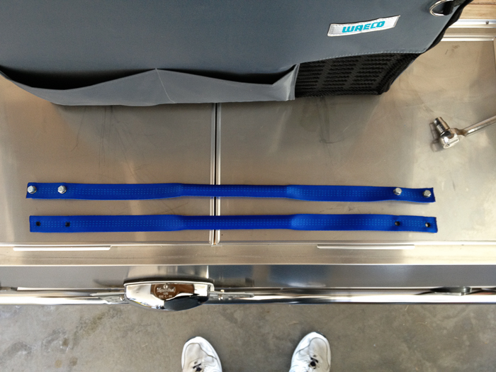

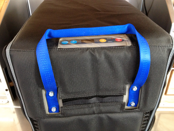

So I decided to re-do the straps that I had attached to the Dometic. i had tried the pre-made straps that were suggested in one of the other posts. These are the black straps with a rubber exterior. Unfortunately they did not extend above the top of the cooler so I could only use one of them due to the width. So I did a re-work and built the following:
1. Materials -
a. 1 inch hollow core webbing. Found this in the climbing department of an outdoor store. Total of 51 inches
b. 6mmx12 bolts with washers - quantity 8
c. 1/2 wood dowell Cut to 6 1/2 inches
2. Cut the webbing to length of 25 1/2 inches
3. Insert the wooden dowells to the the center of the strap
4. You will need to put two holes through the ends of each length. I used a small butane torch with a soldering tip to burn/melt them through. Anything like that should work. The one hole is about an 1/2 inch from the end and the centers are about 2 inches/50mm.
5. Mount the straps to the cooler
You can see from the photos that they extend above the top of the cooler with enough room for your hands and then lay on the top to the sides so that you can still slide in the side table. Note that I have the Dometic cover on my cooler but should work fine without the cover.
Straps to length with holes.
Straps attached.
Cooler in place
Bought the sliders at Home Depot. Really work well. I have the dometic cover on my cooler and the feet extend through the bottom so I can still attach them.
