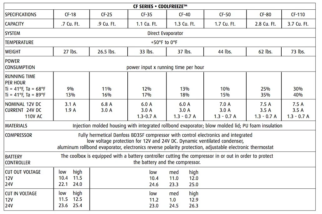

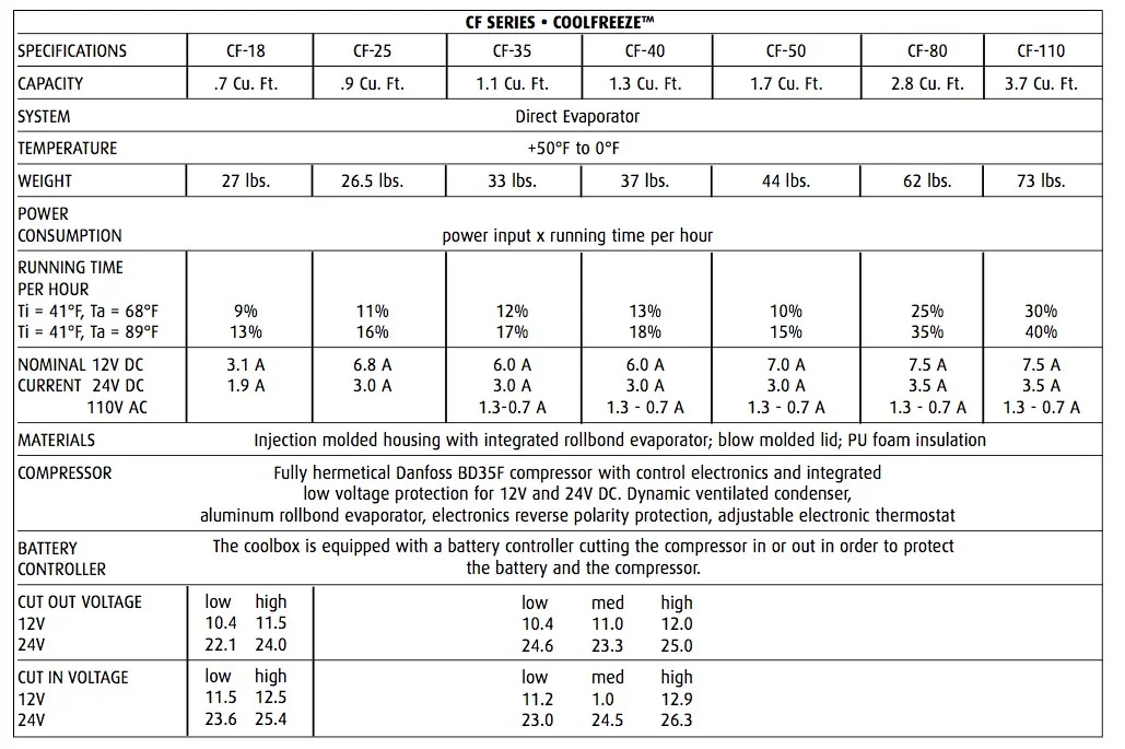

The old waeco manual has a chart that shows running times for different inside/outside temps. It also shows that it draws 6 amps when running but I've rarely seen it over 5 amps. I've put the page with that info below. You can find that manual on the web if you root around a bit.
