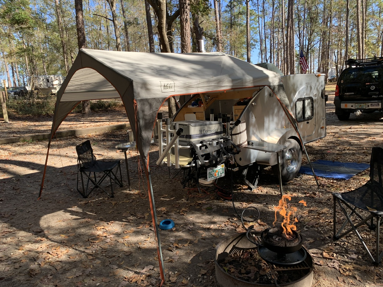

Big buddy is certainly larger than I thought it would be!
I know its radiant heat, not convective --- how does it work when 'out in the cold' sitting it front of it like a fan on a warm summer day?
I have a solo-stove, and it is FANTASTIC for creating a mood, and making firewood last a lot longer. But it's not as good at 'throwing' heat --- I'm wondering if the two together would be a nice sucker punch on cool nights.
I concur.
